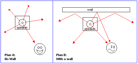

Answer:Would it be fair to say that a tone of low frequency will reflect from a surface that is in close proximity to the source? Take a concrete wall for example and place a woofer 10 inches from it. I expect due to the short distance that no reflection will take place?
Sound of all frequencies will bounce of a hard, solid surface like a concrete wall. It doesn't matter how close the speaker is to the wall.
In the pictures below, we can see how this works. The red arrows show some of the directions the sound travels after it leaves the speaker.
In the left picture (with no wall), we see that the listener hears only one of everything - the sound traveling directly from the speaker to his ears. This is good.
Notice how confused and unhappy the listener in the second picture is though! This is because he is hearing two of everything - firstly the sound that comes to him directly from the speaker, and then a moment later, the sound that bounced off the wall first before reaching him.
Apparently people with good ears and Hi-Fis find this unpleasant, which is why folks like Earl Geddes work hard to invent loudspeakers that don't bounce too much sound off the walls.
OTOH, teenage knuckledraggers prefer to maximize this effect by shoveling their "subs" up against a wall, or preferably right into a corner (so it can be near two walls) because they want MORE BASS and don't care what anything else sounds like, so long as the furniture's jumping.
This works like so:
Assuming the speaker is about a foot from the back wall, the path traveled by the sound that bounces off the back wall on it's way to the listener is about two feet longer than the path traveled by the direct sound. This means that the reflected sound arrives at the listener about 2mS after the direct sound.
At low bass frequencies, the delay is a small fraction of a wavelength so the direct and reflected waves add nicely to give a result at the listener's ears of about double the amplitude of the direct sound alone.
As frequency increases, though, the delay results in greater and greater phase shift between the direct and reflected sound, with the "addition" becoming less and less effective, until at about 250hz the two are completely out of phase and cancel each other out.
At still higher frequencies, bla, bla, geez I'm sick of typing now. Sorry folks, that's as coherent as it get's tonight (after 2AM here).
Cheers - Godfrey
