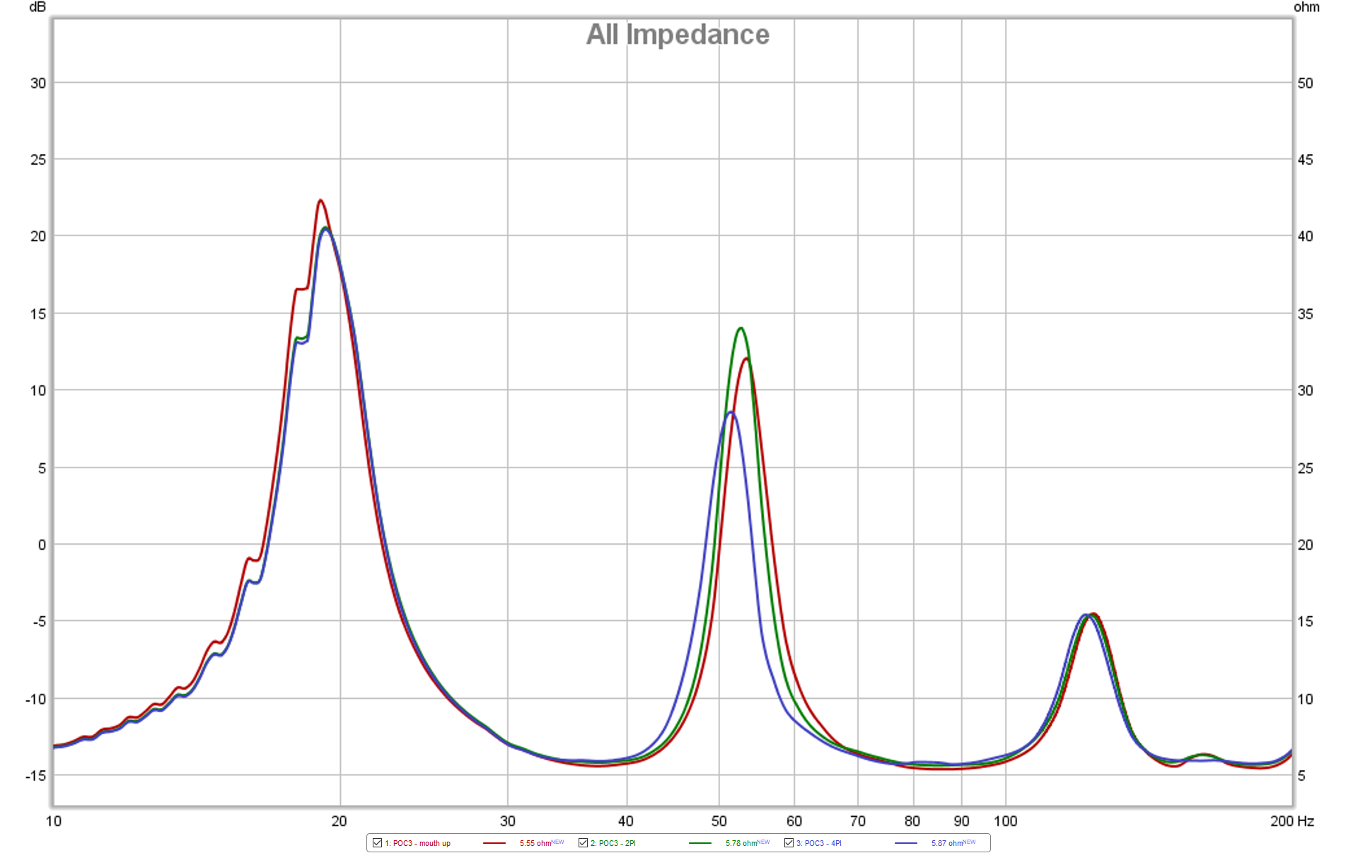

What I'm sure of though is Hornresp is pretty good at simming what happens to the impedance curve when the cabinet is loaded differently, i.e. placed next to a wall (the mouth orthogonal to the wall), something I've also confirmed with measurements. - on a TH that I built. The shift was small, but it was there. As predicted. I'd published the results here some time ago. And if the impedance curve changes, the FR will change too.
So, my bet would lie with the Hornresp sim being correct. Until empirical measurements prove otherwise 😉.
I've often heard this repeated, but I haven't seen any empirical tests to back it up, and the sims suggest otherwise. Granted, the change is not as large as say that for a FLH (likely due to the difference in mouth sizes), but the sims do suggest that there should be a difference.

Not disagreement there. However, it's not going to be a step change, i.e. the delta increase in efficiency will not suddenly go from 3 to 6 dB, but transitions between the two as mouth size decreases. That means that even with smaller mouths, you should see a measurable difference, even if that difference is very small.
One thing I'm pretty certain of - if there's a change in the system's impedance curve, there will be an observable change in the system's frequency response as well, as the two are linked. With that said, I repeated the impedance curve test with my POC3 TH this morning, with the mouth facing up, mouth on the ground (2PI loading) and mouth adjacent and orthogonal to wall (to emulate 1PI loading). It's a five-minute exercise that anyone can do if they have a TH, DATS and REW (to compare the impedance curves). As I noticed the last time that I did this test, there were minor but noticeable changes to the impedance curve, which suggests that the FR would change as well. This TH has a pretty small mouth (925 cm^2). I suspect any changes will be even more noticeable with THs with larger mouths.
