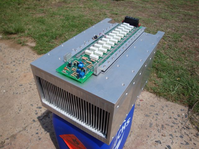

`I would wire them up as 120-32-0-32-120.
This would give about ±45V and about ± 170V.
I would run it class AB+G.
The transistors on the lower rails would need to be a minimum of 215V, the transistors on the upper rail need be only 125V minimum. I would probably use eight pair of MJ21195/96 per rail (32 outputs per channel), or a dozen pair if you wanted to use plastic (48 outputs per channel).
In normal use I doubt if it would ever get out of class AB (200W/4R), so you could bias it up hard for good class A power (up until your heatsinks got to 150°F or so).
A Crest 9001 runs on about the same voltage, with about the same number of outputs, ±161V peak output.
