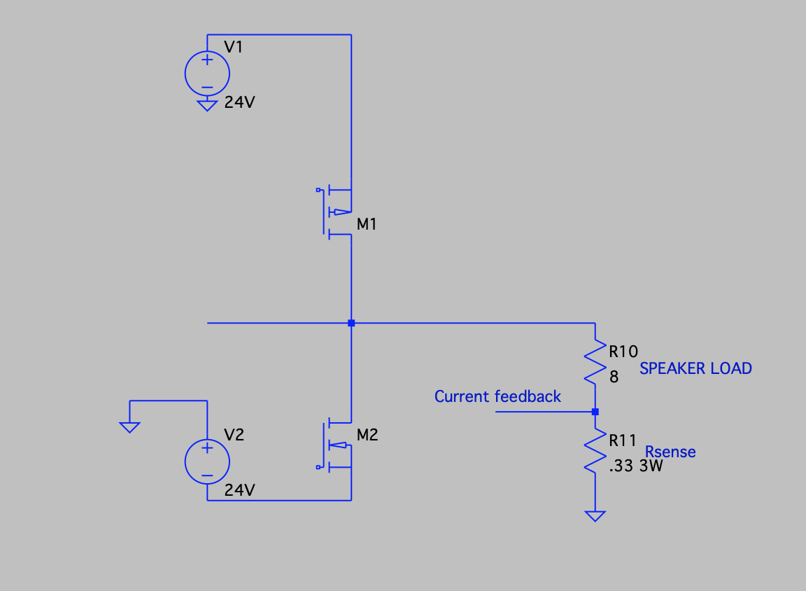

I am wondering if version 1 of the SSR circuit will work with my "imitation" F7 (First Watt) amp. As you may know, this amp does not ground the speaker directly, but rather has a current sense resistor in series with the speaker and ground. The current sense resistor supplies a positive feedback voltage to the input stage to increase the apparent damping factor of the output stage, which can theoretically approach infinity.
There is normally no DC offset at the speaker or across the sense resistor, so I am thinking the SSR would be OK in series with the high side of the speaker, but would like your opinion on this. The only thing different from a conventional amp is the presence of the sense resistor.
Attached is a simplified schematic of the output stage for reference.
