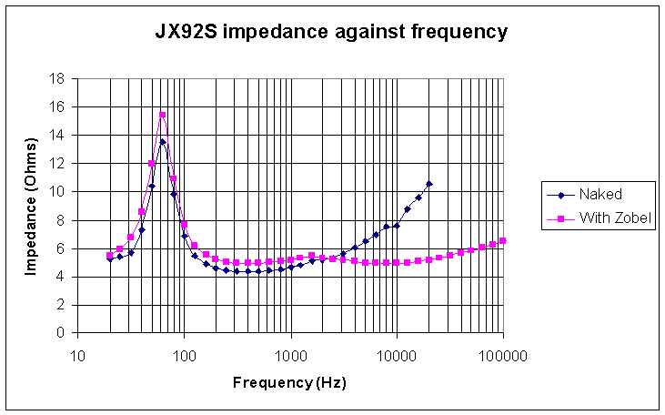

I've attached a graph from Xbaffle . It might be rather silly but how do I go about making a graph like that with the scales as shown .....Log Frequency on the X axis and linear on the Y axis.
My freq response data has 10 points in each octave .

Ah yes, it took me a while to crack this one. If you double click on the legends on the axes it will bring up the menu and you can select logarithmic in the scale sub-menu. To get the proper logarithmic scaling you need to right click on the graph for "chart options" and then "gridlines" to add "minor gridlines."
If you ever find out how to persuade Excel to do paper from 20Hz to 20kHz rather than 10Hz to 100kHz, let me know...
