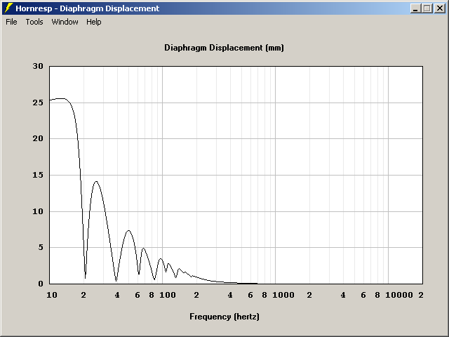

I wouldn't go so broad as to limit the entire spectrum going into the subs, but rather, I would use swept sine waves and setup multiple parametric compressors, a la the Behringer. The excursion graphs on subs are very linear and go straight up and back down, so one compressor for the leading edge, one for the peak, and one for the trailing edge of the excursion peak should get it right.
That's an interesting idea. I first thought of a sliding high-pass filter, but banded limiters would be interesting especially when tuned to a particular cab's behavior. A TH for example has a large displacement bump in the passband above the cutoff and completely unloads below it. If you tuned the filters to those ranges, you'd have something nice.

I'll save you some time, then. The motor of the driver itself has many non-linear properties. All of them are exercised by at actually moving. And pretty much 60Hz and below is where the motion is taking place. Here's an example.
