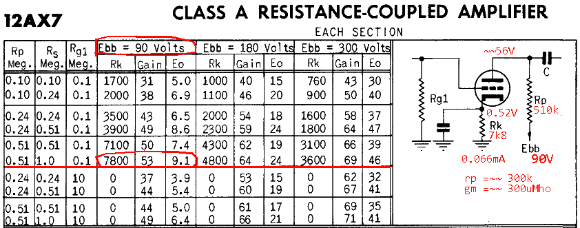

Hi All,
Using the GE 12AX7 datasheet as an example...
https://frank.pocnet.net/sheets/093/1/12AX7.pdf
...I'm wondering if I am reading it correctly.
Looking at "MAXIMUM RATINGS" and "CHARACTERISTICS AND TYPICAL OPERATION", is the Plate Voltage measured directly across the plate-cathode? Or is it equivalent to Ebb under "CLASS A RESISTANCE-COUPLED AMPLIFIER"?
Assuming Plate Voltage = Ebb. 100V should give about 80K plate resistance (in an ideal world). And looking at the 6th row in "CLASS A RESISTANCE-COUPLED AMPLIFIER", we are given the following resistor values:
Plate Resistor: 510K
Cathode Bias Resistor: 7.8K
At 90V Ebb the math gives us the approximate voltage drops:
Across Rp: 77V
Across Plate-Cathode: 12V
Across Rk: 1V
That gives us a 1V cathode bias, which equals the -1V grid voltage under "CHARACTERISTICS AND TYPICAL OPERATION" and everything is awesome.
But what confuses me is the verbiage. To me, "Plate Voltage" would be measured at the plate. Not at Ebb. I'm just looking for some reassurance that I am reading it correctly.
Thanks!
Plate Voltage is always the voltage measured between plate and cathode. Ebb is meant in this sheet as the Supply Voltage for the circuit where that tube is used.
So if in the MAXIMUM RATINGS the Plate Voltage is 300V
then this is the absolute maximum value that the voltage between plate and cathode can handle without the risk of being destroyed. This is for instance the case when the Supply Voltage is 300V and the tube is driven into cutoff.
Plate current is then zero and the Plate Voltage is equal the Supply Voltage because there is no voltage drop across both the plate resistance and the used cathode resistance.
If your application uses a Ebb (Supply Voltage) which is lower than 300V, there is no such problem that the plate voltage will exceed the Maximum Rating of 300V.

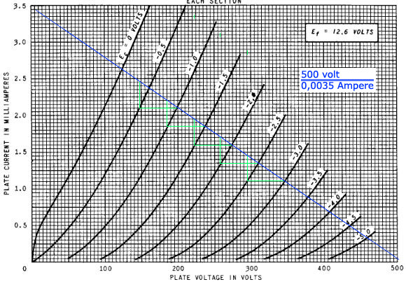

Got it. Thank you for the clarification. I was afraid that might be the case because that will bring me to another question:
How does one determine the approximate plate resistance at a voltage not given under TYPICAL OPERATION?
The aforementioned datasheet only gives us 2 examples at 100V and 250V. But using the resistor values in row 6 of "CLASS A RESISTANCE-COUPLED AMPLIFIER", and a Vbb of 90V, will certainly drop the plate voltage much lower than 90V.
I would think knowing the plate resistance under different operating parameters is going to be important to correctly cathode-bias the tube.
I assume I could extrapolate this info using the plate curves. Just not sure how. I would also think that I could physically run the tube at 0V bias and take direct measurements to get in the ball park. But that seems counter-intuitive.
Any tips to steer me in the right direction?

For a triode, a shift in anode voltage of delta VA is ideally equivalent to a shift in grid voltage of delta VA/mu.
Besides, the transconductance and internal resistance are essentially determined by the anode bias current. That is, any two bias points that result in the same anode current and in a grid voltage low enough to keep the grid out of conduction (which typically means <= -1.3 V, although -1 V is apparently still OK for a 12AX7) result in essentially the same small-signal parameters.
....looking at the 6th row in "CLASS A RESISTANCE-COUPLED AMPLIFIER"....
Yuck!! What are you building? A $9.95 table radio? A tube hearing aid? That's about the worst "hi-fi" condition listed.
OK, roll with that. Ebb is your B Battery voltage (or power supply). At 90V we have no risk of trouble on a 300V Max tube. A 90V battery feeding a Resistance-Loaded amplifier, the plate voltage will be well below the 90V battery. "About half", 40%-70% for most happy values.
We "can" plot the operating point with 510k down from 90V and tracing the 7.8k cathode resistor across the grid lines. But this puts us so far down in the corner of the plate curves that we can hardly squint; also can't trust that the Jr Engineer really measured this corner or just drew smooth curves to zero.
With rough rules of thumb I estimated the actual working point. Something like 0.066mA. We can go to the graph on page 2 and try to find 0.066mA at 100V, then guess the adjustment for 55.5V. But even that is a real squint. I wrote my squints down but I know they won't be right. And will vary from one tube to another.
Do we really care? The datasheet assures us that 90V 510k 7k8 will "work", and gives results (these were probably Measured). Gain is good, but the load MUST be at least 1Meg. Typical stray capacitance tends to act like 200K at the top of the audio band, so we may not have full "hi-fi" bandwidth. 9V RMS seems OK next to typical hi-fi 1V level, but this is 5% THD. At 1V it may be 0.6%, at 2V it will be >1% THD. And this is one stage in a presumably larger System.

There are good books around covering the basics.. First you got to determine the input voltage. For low distortion the delta E/delta I quotient needs to be regular. The ideal load can be calculated from the graph and you go from there.

As disco and PRR rightly have remarked: you first have to consider what you want to do with that tube in an amplifier stage and use the graphical method to make things easier.
If have made a small document to add as a little help.
Hope it will be of some value for you.
