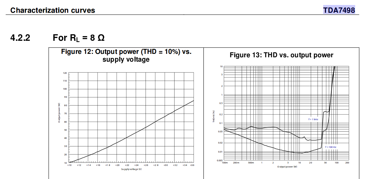

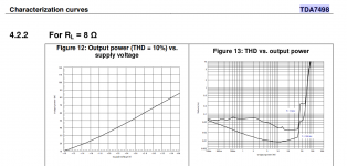

So reading the datasheets i usually try to follow the Output power vs Supply Voltage, and THD vs Power output curves.
The simple case is when there's an exact graph for my 8ohms load, in this case for the TDA7498.
at 24V i should get around 45W.
2 things :
- Q1. Why is there a mention of THD=10% for this graph ?
Looking at the "THD vs Power" graph, i understand 10% THD happens at 85W which is supposed to be only with a 36V supply right ?
I know i'm missing something looking at the TPA3116 graphs below..

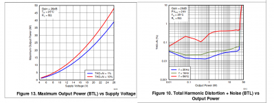

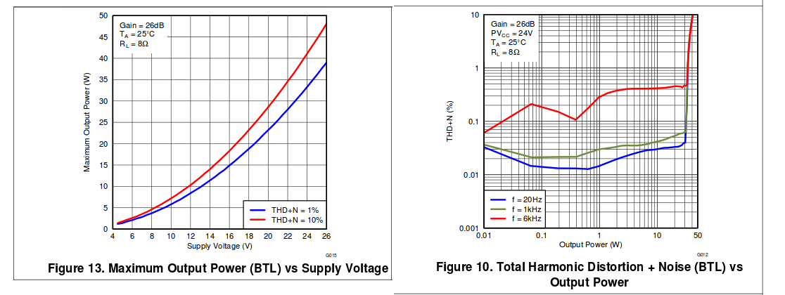

Here are some curves for the TPA3116 :
As i figured out there's a 1% THD Power vs Vcc curve so the one above should indeed be at 10%THD for 24v which is not wanted of course..

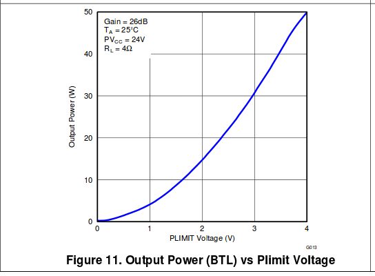

Then the TPA3116 has an interesting feature "PLIMIT" to set the max output voltage amplitude (lower than the max with the current supply voltage) and so limit the output power.
At least i know i can internally set the output power for that chip, i haven't seen the same feature with the TDA7498.
2 things :
I don't know how the YJ Blue Black board is wired, my guess would be it's set for the max output power.
- Q2. is that the output power for the whole chip or per channel ?
Looking at the preview specs "8ohms 80w+80w @34v", i guess it's per channel.
A lot of chip makers rate their amps at 10% to give higher numbers.
I try to use the 1% or 0.5% if possible. Those graphs are usually available.
Think back a few years ago when computer speakers started being rated a 300Wpmpo.(example) The IC used was a 1Wrms/ch device.
Output is usually per channel.

Q1 : according to the datasheet, with Vcc = 24V, Vout = 17.9Vrms = 25.31 Vpeak.
Is it possible to get a peak output voltage above the supply voltage ?
No, that is where the 10% distortion is coming into play...the amplifier is clipping the sine wave and that results in more equivalent power.
Q3 : The other thing i don't quite get is how rising the supply voltage by itself is enough to boost the output power ?
(with a fixed input voltage gain)
Is there a relationship between the gain and supply voltage that i missed from the datasheet ?
Higher supply voltages will not increase power with a specific drive level.
Higher supply voltages will allow more (un-clipped) power with increased drive.
Example:
Lets say that 1V of drive gets "X" watts with a 12V supply (no clipping) and trying to put 1.1V of drive will start to clip the output and produce a distorted waveform.
Further increase in drive of 1.5V will clip and distort even more.
But if you increase the supply (while driving at 1.5V) to 24V then the amplifier will have enough output swing to produce the increase in power without clipping. 2.25 * "X" watts.

thx i'll check it out but if i need to use a step up, it will be for the TDA7498 and it should only go from 24v to 28v probably.
I do understand the coil has a major role in that step up circuit and those boards use cheap components, unfortunately coils are quite expensive so replacing them may not be a priority for this project.
okay i kind of get it, i was expecting clipping above the supply rail but i still don't understand how the datasheet comes up with 17.9Vrms output voltage for the 24V supply.
I imagine that you can achieve higher power output levels when you introduce clipping.
Actually the datasheet says so in the plimit examples : "POUT (10%THD) = 1.25 × POUT (unclipped)"
Okay that's what i understood then, thx.
Well there's not much room for tweaking, with a 24V supply, i will achieve a maximum (? the curve goes up to 50W somehow) of 40W (10%THD, 17.9Vrms Vout @ 8ohms) per channel.
2x30W with around 0.5% THD @6KHz, not sure it'll be enough..
Efficiency at that level with my load should be 92% which would then require 87W from the power supply. Even with some margin, if that efficiency figure is not exact, it should be well within the power supply capability.
And at that level distortion will be so high that i shouldn't ever be used.
The only thing that could be done is to set the gain to the lower setting (20db), in order to avoid reaching distortion levels.
But then my maximum output power with a +4dBu line level would fall below 2x20Wrms.
Q: Do you have to use the defined resistance values and gain levels or can i plot a line to try setting other gain levels ?
(between 20 and 26dB)
And one last question, does the gain only matter for the max Vout amplitude or does it also influence other characteristics of the amplifier, frequency response and so on ?
Gain selection is not a linear function. The IC reads the value and selects one of 4 choices. (TPA31116)
Choice of gain affects input impedance. (at least on the 3116) Check the data sheet.
Choice of gain does not affect max Vout...it affects how much drive you need to get that max Vout.
Some people have made the statement that the gain setting affects the "sound" of the amplifier. I have not investigated this so have no data to form an opinion.
