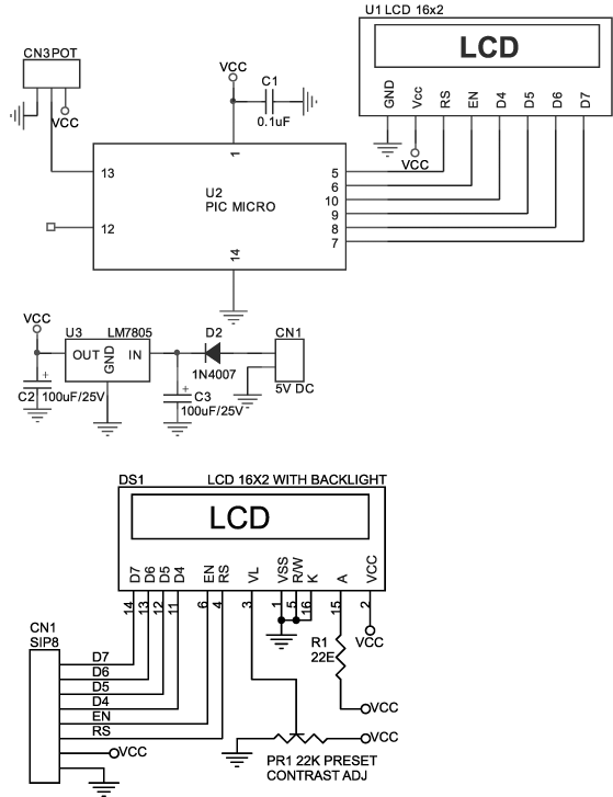

Have you got the compiled code (hex file) ?
Microchip's MPLAB can turn that back into MPASM: although it isn't assembly that is pleasant to read or follow.

MPASM assembly conversion attached. It's very ugly because all the labels get lost in the conversion to hex.
steerpike,
i don't no what you mean, can you convert the source into C usefull for the
Microchip compiler
Microchip compiler
jempie
have you tried to convert your program ? The code really isn't that much different.
Which uC are you using and which compiler (C18 maybe ?) are you using?
For things like the lcd, C18 compiler comes with xlcd.c/h for this.
