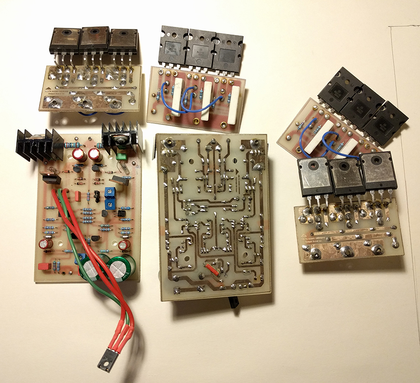

Hi All, I have a second hand set of the original Krell KSA 50 clone boards and I'm trying to re-use them. I haven't gotten very far though because I can't get wire through some of the holes. The connection contact is more of a crimp tube through the PCB. The larger wiring points are left open, but the smaller ones seem to have been crimped on the bottom side of the board and this has fairly effectively closes them off. Pictures attached, let me know if you want a close up.
Do I need to replace these wiring points? If so can someone either tell me how, or help me with some search terms to look for some pointers.
Or is this just a hazard of reusing this type of board and I need to get creative with the wiring, maybe drill some new holes?

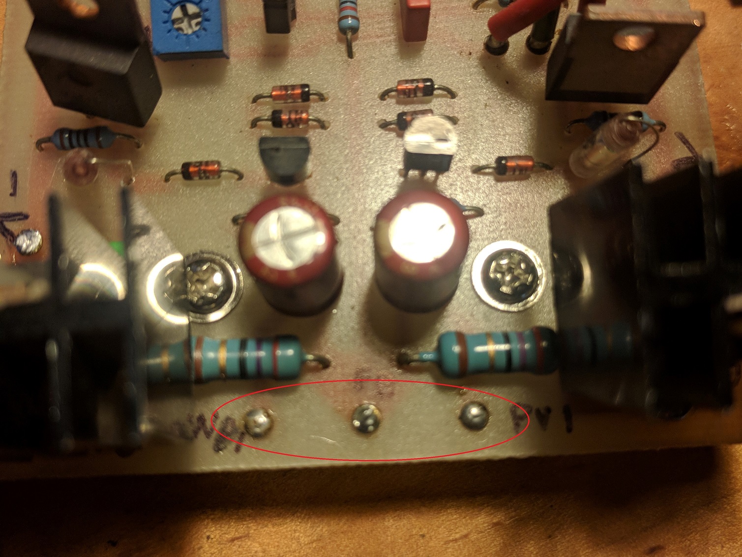

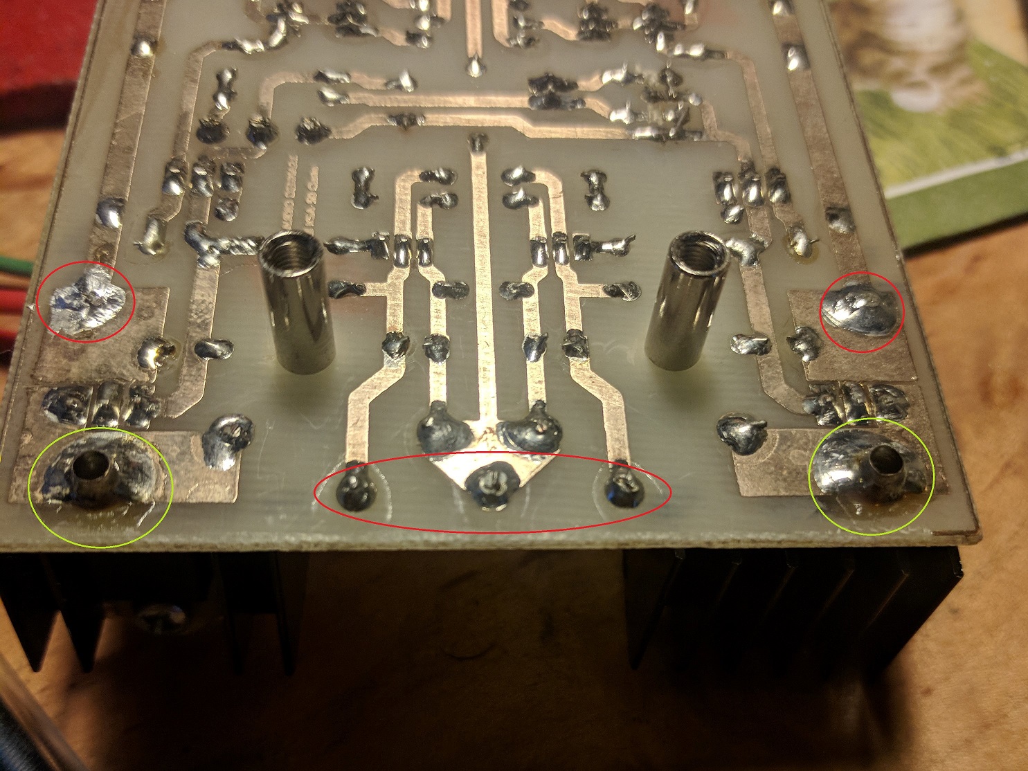

Added better images. The green circled ones are no problem, but the smaller ones, circled in red, are crimped together at the bottom and problematic. Thanks.

Those appear to be mounting pins for the heat sinks. Try using a hotter iron, and first add more solder,
before trying to desolder with heavy wick or a tool. Position the board tilted bottom down a little
when desoldering, so the melted solder will flow out the bottom, not into the top of the board.
The other side of the pin has a lot of heat sinking, so you need a lot of heat on the pin.
If that doesn't work, try heating up the pin well (with board bottom facing down), and quickly tap the board sharply
on the bench. Much of the melted solder should fall out of the hole, if you act fast enough.
