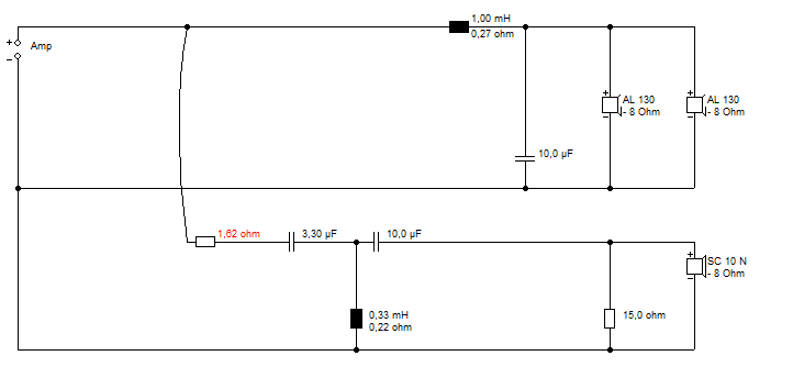

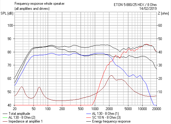

You can buy a couple of these puppies at CPC fairly cheaply: https://cpc.farnell.com/visaton/hw2-70ng-8ohm/crossover-2-way-8-ohm/dp/DP33248?mckv=s4gQDtx2s_dc|pcrid|224680571758|kword||match||plid||slid||product|DP33248|pgrid|46864214357|ptaid|pla-464524425811|&CMP=KNC-GUK-CPC-SHOPPING&gclid=EAIaIQobChMI-ZzC4Nm74AIVLrXtCh29PAK8EAQYASABEgLLTvD_BwE
I ran this up the flagpole in Software | Visaton. It's not quite the finished article. But definitely adaptable with an additional 10 uF Capacitor and some tweeter level adjustment. https://www.wilmslowaudio.co.uk/ceramic-resistors-205-p.asp
The modelling below. Looks doable to me. 🙂
I ran this up the flagpole in Software | Visaton. It's not quite the finished article. But definitely adaptable with an additional 10 uF Capacitor and some tweeter level adjustment. Ceramic Resistors
Steve, I have to pull you up on this.
What you've modelled is a totally different set of drivers, in a different enclosure, and suggested that the crossover circuit will work with the drivers the original poster wants to use.
These things don't transfer as well as you might hope.
Chris
Chris
