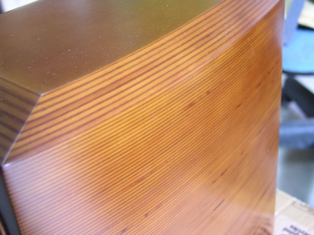

hi,
this is not selling products, I need more diyers advise !!!!!
I was thomas, owner of www.diyaudiocraft.com
I would lke to collect some information about Tangband fullrange speakers.
Hong Kong was very close to China & I had OEM speaker chassis factory on china. It had very good piano plywood & facelet funish as piano funishing procedure.
photos shows piano plywood.
let's talk with the detail. hw about the performance of tang band full ange speakers????
I ask for the factory already. price will let me know next weeks. If price really good I prefer prepare groups buy since te mininum order was at least 250 pairs.
The only one I can do was prepare chassis to save pstage.
thx
