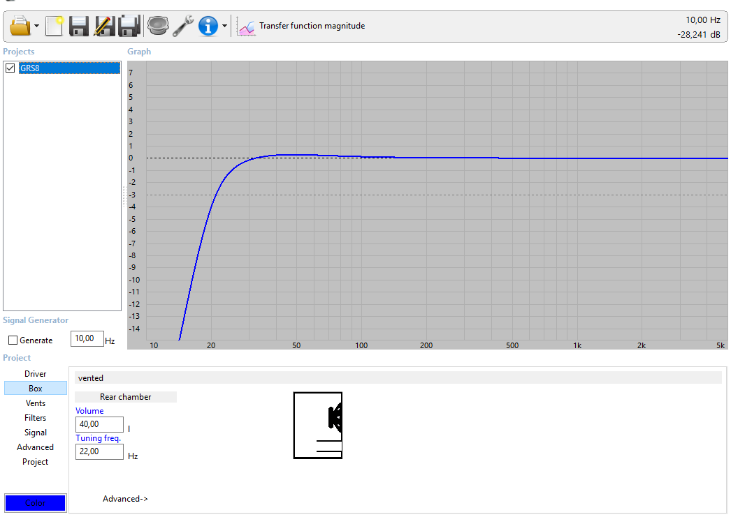

With a US$40.00 woofer, if you can buy it in your country, you can have a superb frequency response in a ported 40 liter speaker tuned at 22Hz.
F3=21Hz @-3dB. See below speaker suggestions.
Crossover at 300Hz / 4000Hz

Some of the cheapo woofers like GRS are high Qts so they need a large box.
The box looks average to small for 2x woofer.
Need something in the .3 to .4 Qts range likely.
Usually the classic series daytons work well in small boxes.
They pack a lot of magnet for the price and have Qts suitable for the box size.
