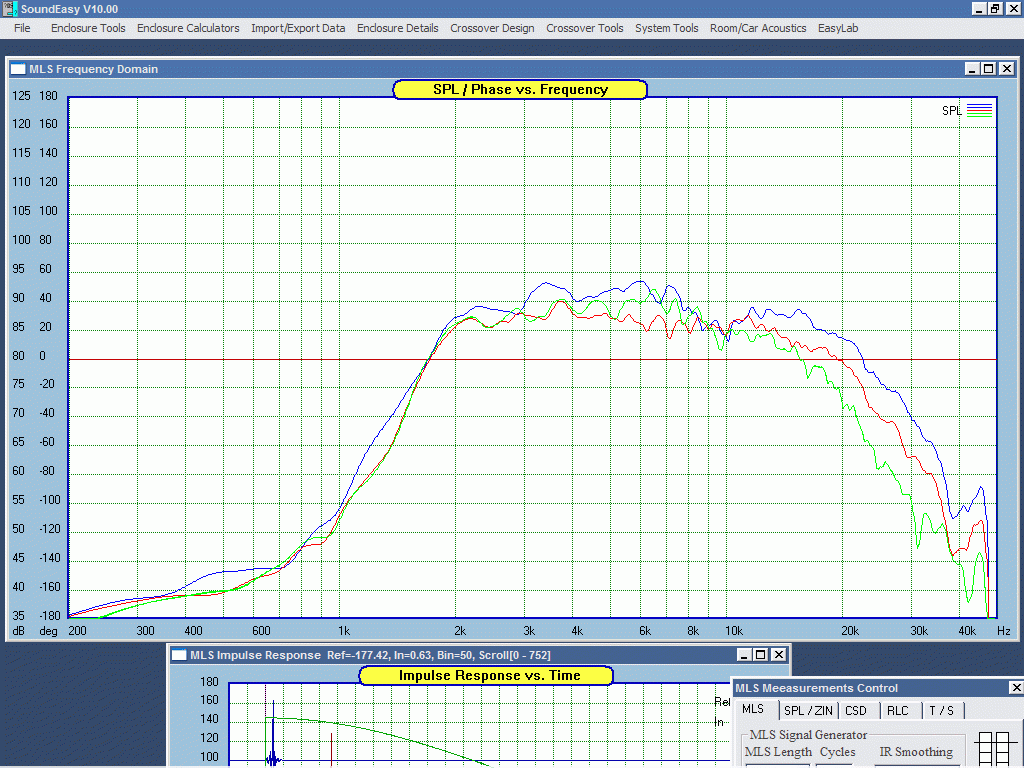

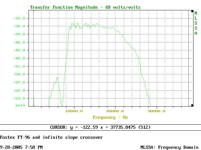

Arez,
Here is a MLSSA Scan of a nos TAD, ET-703 (linear not log) I made from back in 2005, the pieces are still boxed. Xover was a 10-kHz 2nd order with a trap at 9.5k for safety. ACO Pacific mike at 1m.
I was a little disappointed in that a very humble Fostex FT-17h measured quite a bit better, flatter and more extended

Yes will be interesting to see how the 703A has changed in behavior.
The measurements you linked are very similar to the ones i posted, with different smoothing.
The main disadvantage of the original 703 tweeter is still the constraints posed by the internal throat IMO.
And yes there are tweeters with a better behaved response at least, not that the 703 is a large challenge to filter.
Yup the FT16H and FT17H is surprisingly nice and clean for they're cost 🙂
