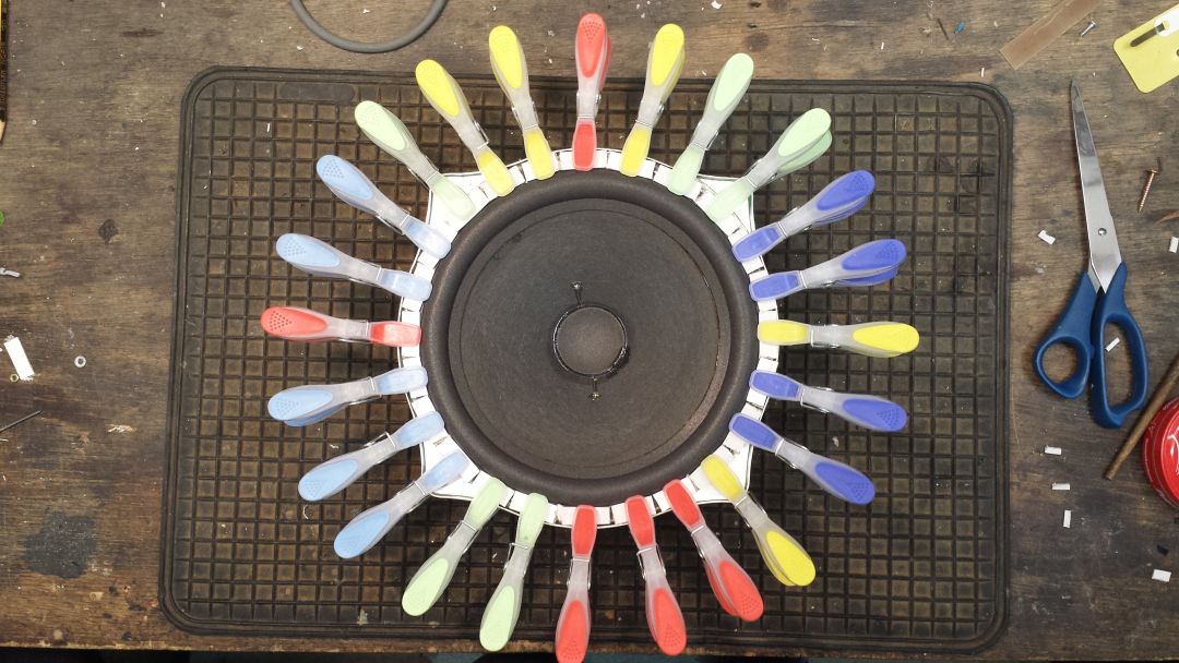

I did it by scraping carefully most of the old glue, put copydex on both sides, let it rest 15min and then pressed it by simply laying the driver upside down (it's an inverted surround with thick felt for back mounting). It is holding fine for now.
