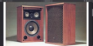

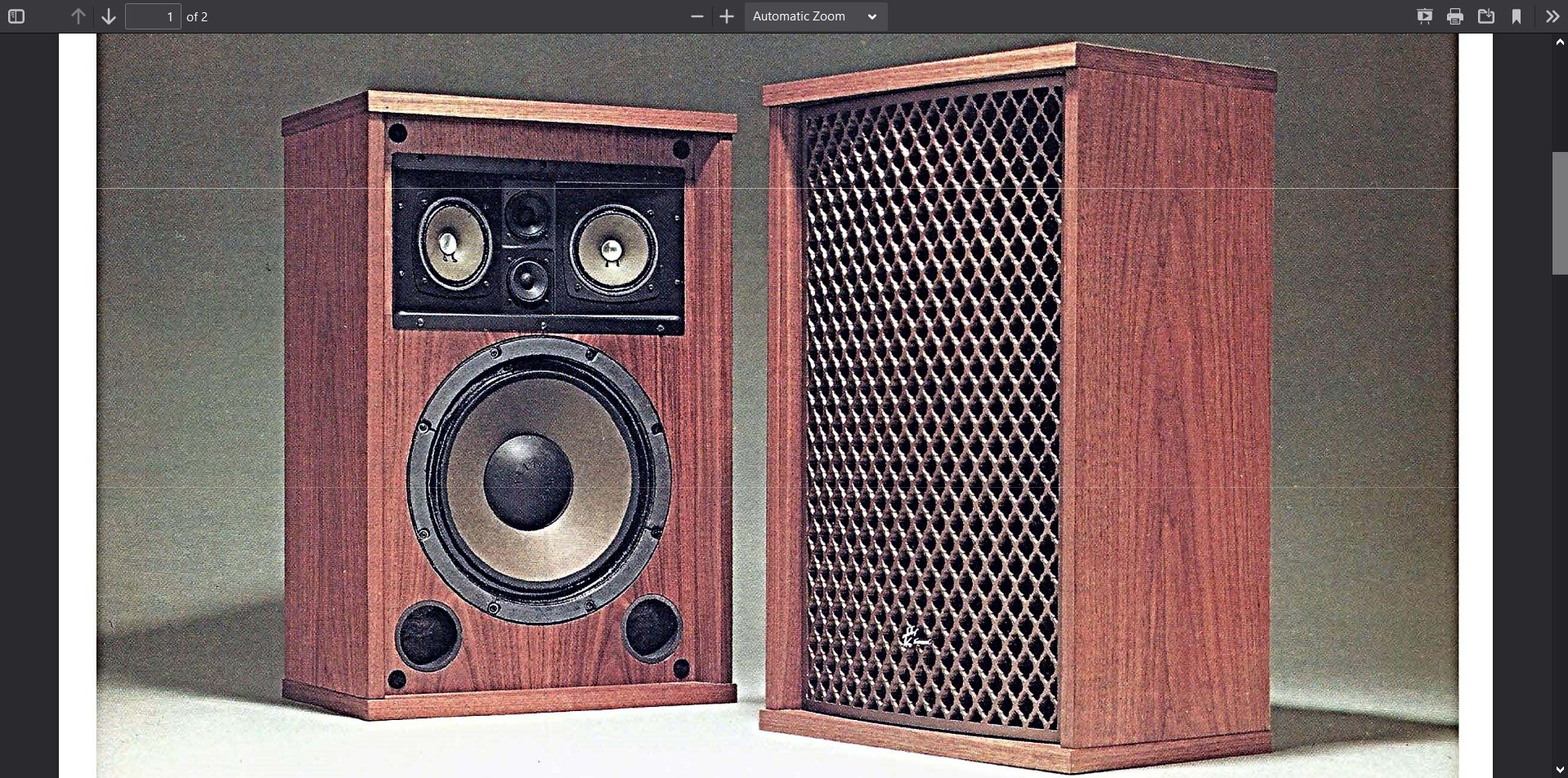

Hello everyone!
This is my first post on this forum and my first true DIY audio project (other than soldering and de-soldering stuff). so my expertise may not match my ambitions, please stop me in my tracks when you think what i'm trying to do might be too much.
I'm trying to 're purpose' (or honestly re-design) a pair of speakers from the 70s using the knowledge that we have today to better fit my room. The speakers are Sansui SP1700 (pic below)
I want to keep the enclosure (plus the dust/air filter) because my boyfriend is very much attached to these speakers (i mean they look gorgeous too) because his grandparents gave them to him when the moved to a smaller house. I've tried so much to convince him to no avail so this is what i can work with.

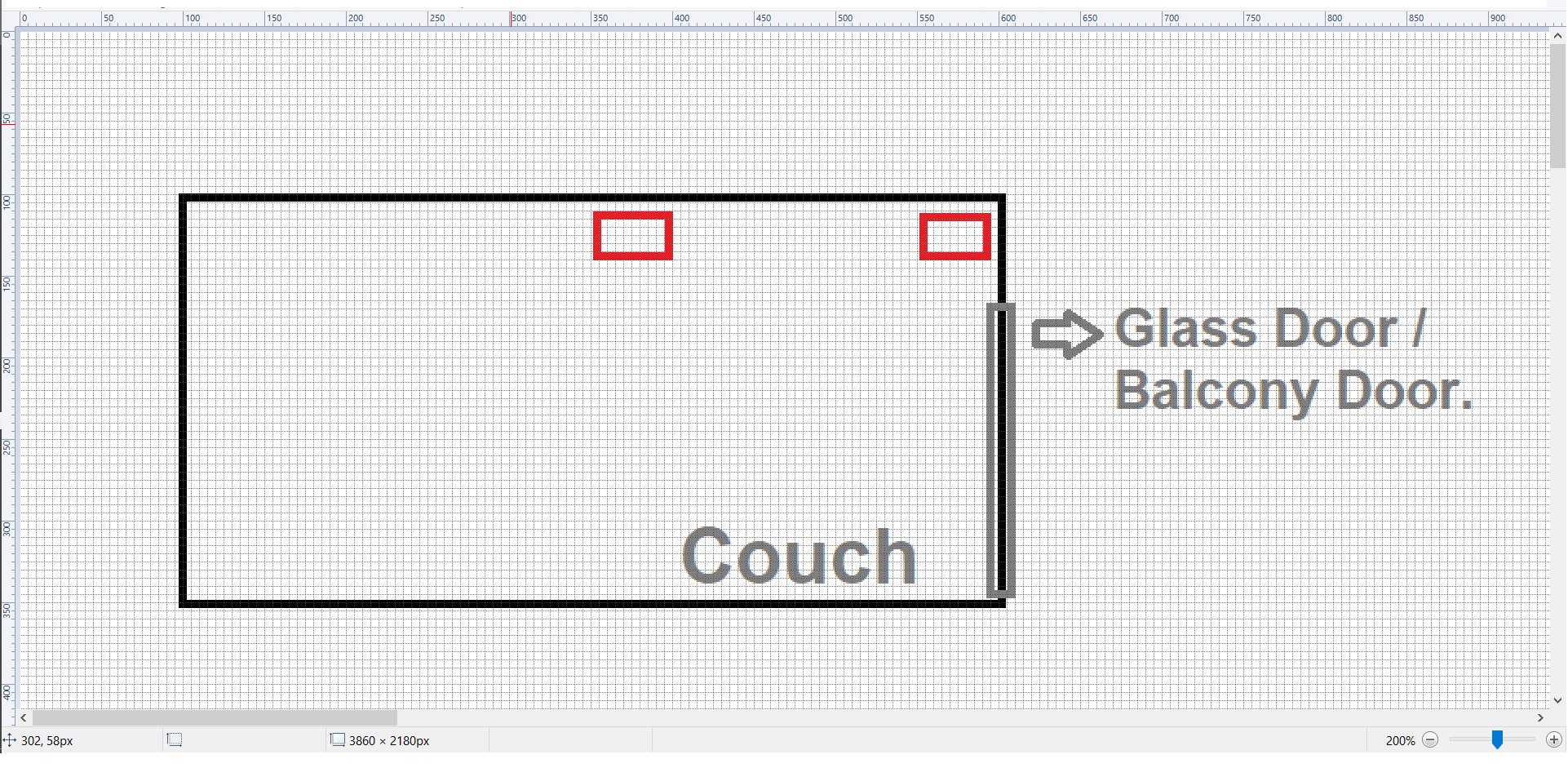

This is the room configuration (non-negotiable too )

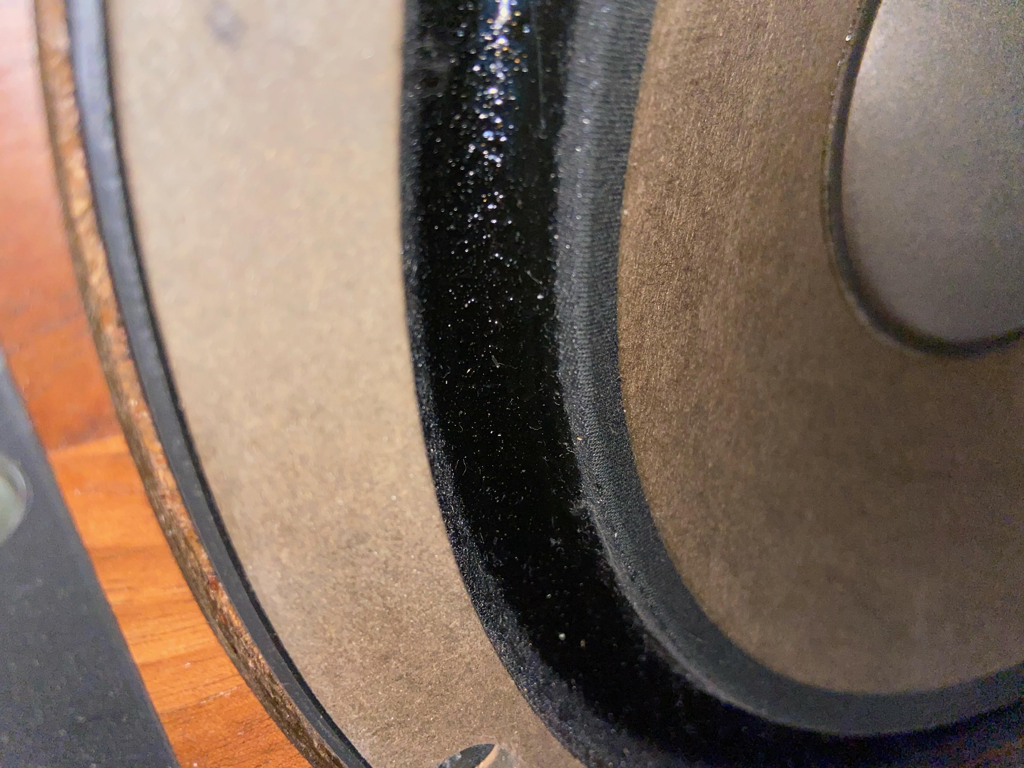

To start with you can just to check if speaker units have good elastic surrounds which seems not highly probable for their 50+ age.

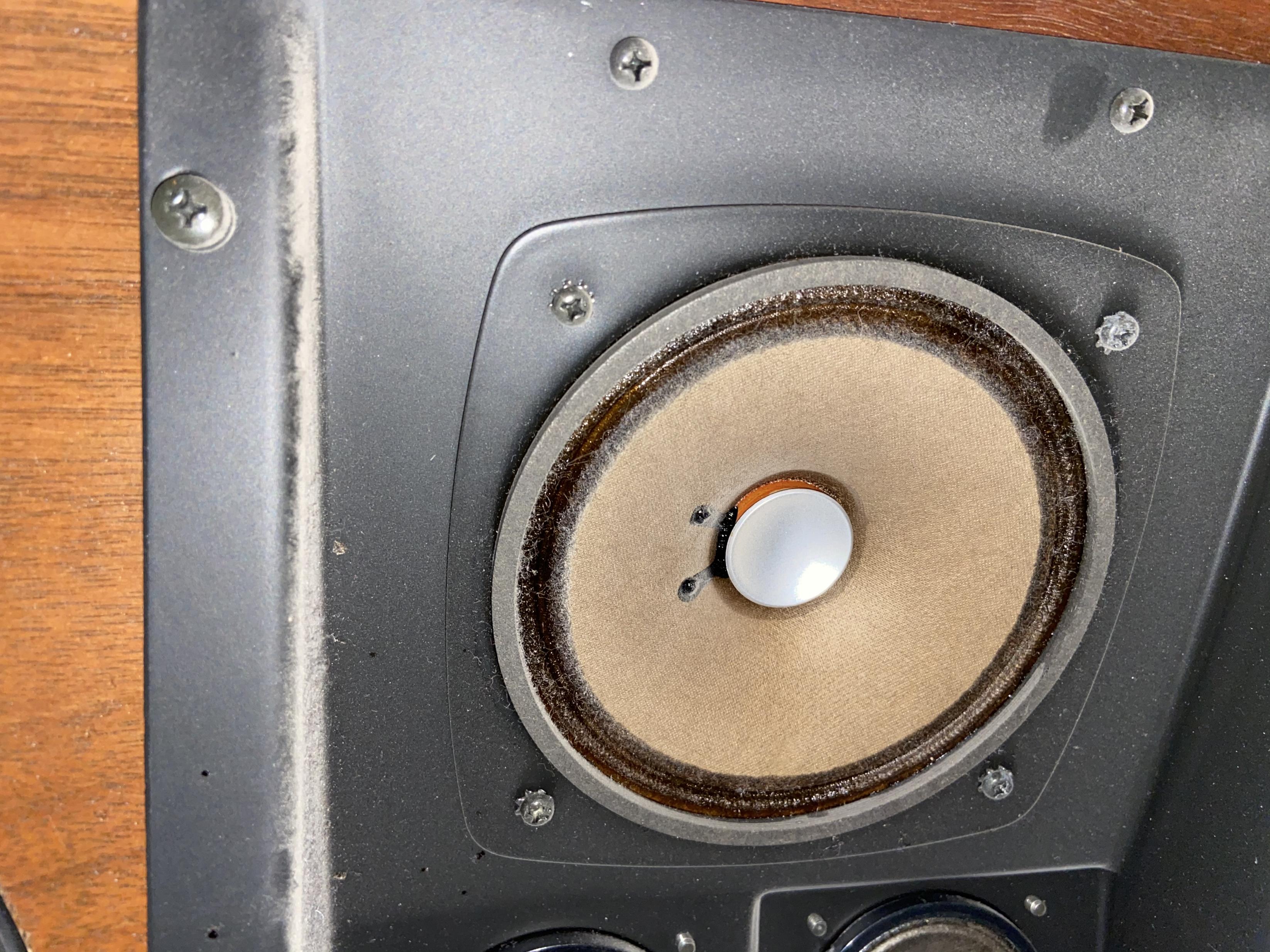

How do you test the elastic surrounds? I mean there is nothing deeply problematic about their sound, it’s just meh.
Very lightly press the cone in a couple of mm. Even distribution of force on the periphery, or at least ensuring no offset load. How does it move under that (light, and please don't do this with the tweeters) pressure, and does it spring back nicely when released? If so, surrounds should be OK.

Not clear from your pictures and not mentioned in brochure but IF they are foam edged, foam self destroys by oxydation and UV, cracking or becoming a gummy mess, easy to see.How do you test the elastic surrounds? I mean there is nothing deeply problematic about their sound, it’s just meh.
IF treated cloth edge, it might still be fine.
Or it plus cone suspension/"spider" might have become stiff, it´s 50 years old!
But if it was used more or less regularly,"exercise" might have kept it in good shape.
Apparently from what you say, they are fine, so don´t mess with it.

Around 2010 acquired a pair of Sansui speakers that were probably just slightly older than yours. They had almost the same speaker and crossover compliment, though all the drivers were front mounted and the Kumiko grill was not curved.
Even though they had been in the high, dry, desert for years, and were probably purchased by a US soldier via PX, (post exchange) during the Vietnam War, all the drivers and crossover components still worked "as new", and probably still do, they still worked fine in 2016 when I sold them.

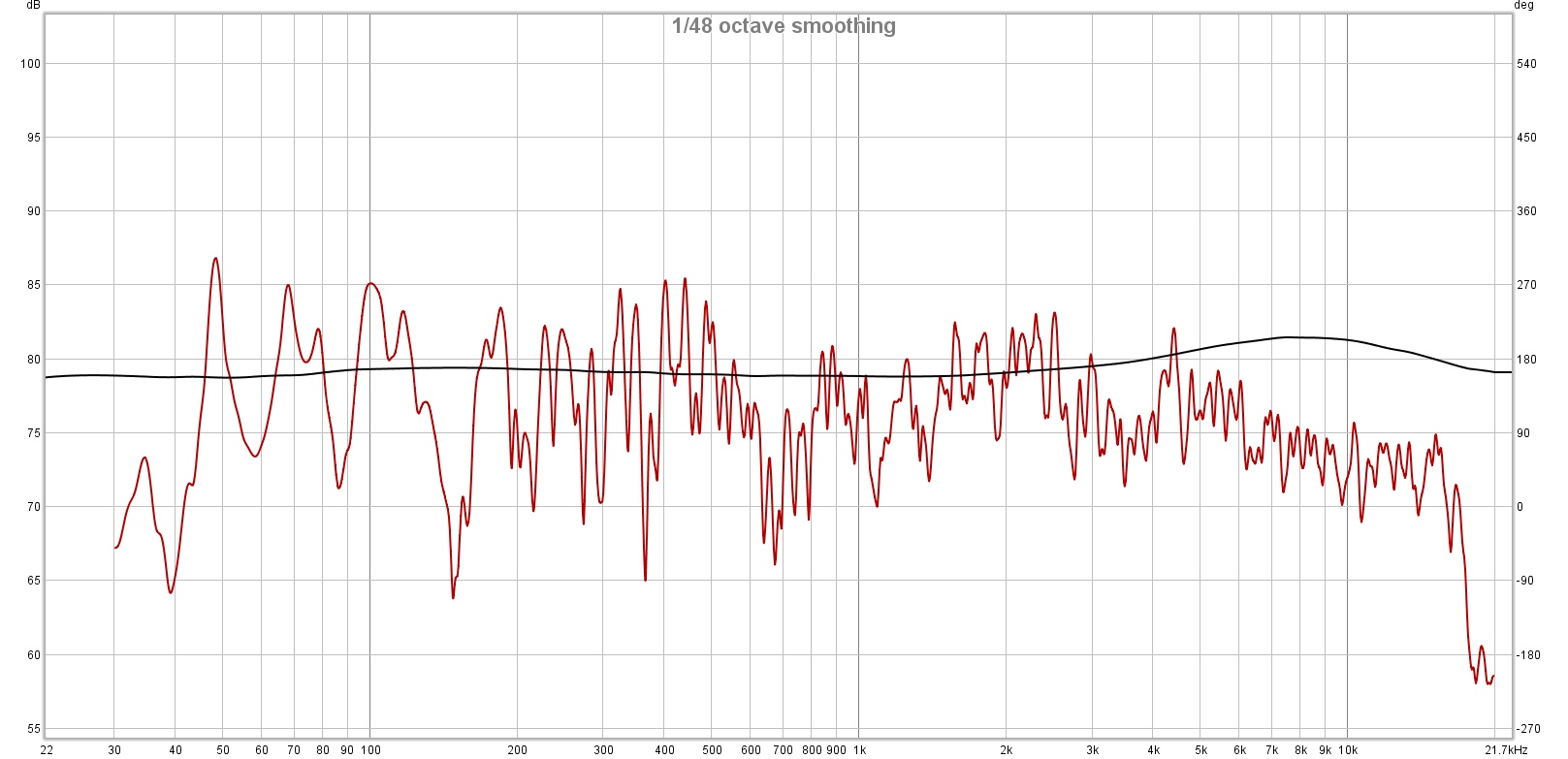

Your non-negotiable, off center on the long wall placement of the speakers to some extent renders any improvements a moot point, but I won't try to convince you any further of that .

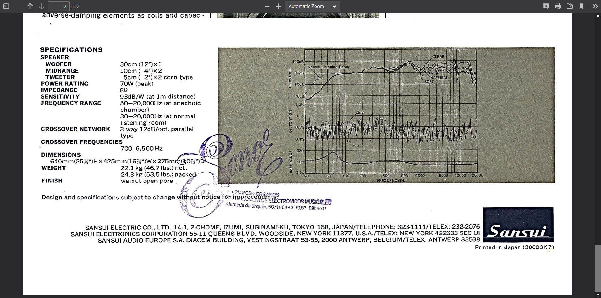

1) Unless you are looking for louder or lower response than the drivers can provide, no need to "pump them up".
2) Horizontal placement on the ground is bad for stereo imaging, but if you are set on that option, there are some options.
3) The speakers are voiced quite "hot" in the mid-high range, so bypassing one of the mid and high drivers would be OK. Rather than removing them, unwire them from the crossover, and put a shorting wire across the unused terminals.
Wire resistors of the nominal speaker impedance (IIRC, they may be an "odd" value like 12 ohms) to the wires that formerly went to the bypassed drivers.
This should bring the mid-high response down around 6 dB, and eliminate some of the comb filtering.
Since the speakers are horizontilly floor mounted, you will want to mirror image the cabinets with the mid-high placed center, the lower, up-firing mid connected, and the inward pointing tweeter connected.
The range around 700 Hz may still be a bit "hot" even with the attenuation switch set to "soft", the woofer may be responsible for most of that. That peak could probably be tamed with some felt placed in front of the 12" cone on the inside of the grille. A passive notch filter could be used, but would require impedance testing and acoustical measurement to design it.
With the simple changes listed above, little EQ needed to the correct the speaker's response will be needed, they should sound 'OKAY'.

In post #10, meant to write the peak at 1500 Hz, above the nominal 700Hz crossover, may be due to the woofer, which is directly connected to the input with no coils or capacitors.The range around 700 Hz may still be a bit "hot" even with the attenuation switch set to "soft", the woofer may be responsible for most of that.

Hey guys thank you for all your comments!
I already recapped them like a month ago, night and day difference.
In the attachments are pictures of the elastic surrounds, they look really gleamy, as if they're dipped in Tar. they're not disintegrating and they're still somewhat elastic (bounce back when lightly pushed with fingers).
Do you recommend that i replace the elastic surrounds?

How do you find the bass of the original speakers anyway? The surrounds are basically cloth doped in something to seal the gaps in the weave but something that doesn't completely set. A bit like how soft dome tweeters are made. Years ago the doping material used to leave the tweeter sticky and would attract dust. The surrounds here look fairly dust free.
The midrange/tweeter unit looks like it would lift right out if you unscrewed it. This would allow you to make a new module that would slot right in. It looks like its recessed along the sides. A flat piece of timber of the same dimensions, with matching screw holes would work to cover the old hole then some strips of a weather sealing foam, meant for doors, would make light work of the recess.
You could then do whatever you wanted with a new mid/tweeter design, so long as the drivers would fit. Again a coaxial would take less space. The advantage being that this doesn't affect the old cabinet in anyway and is 100% reverseable.
If you wanted to go for a new woofer too I would advise a similar approach. Cut out a circle of timber the exact same size as the old woofer, so that the circle will fit into the recess where the 12" now sits. Screw that into the cabinet using the old screw holes. You can then reinforce the backside of the timber circle if it's too thin for rigidity. Like cut a circle of 18mm MDF out the diameter of the hole that the 12" driver fits though and stick it to the back of the timber circle.
Then all you need is a new driver that you can mount on the timber circle you've made. It will have to be smaller, probably a 10", but there are loads of those that would fit. You might have to seal the old ports. Again this would be reverseable too and require no modification of the original cabinet. Unless you can find a new 12" that fits the old recess. Do you have the exact diameter of the bass driver?
I've done the above methods myself once or twice, to put new drivers in old cabinets, and it works very well.
The bass is the highpoint of these speakers, it's excellent. in fact, it's too excellent that I had to do an EQ (200Hz and below) to get its amplitude some where similar to the rest of the frequency curve.
This is the frequency response curve at 75db target, -12dbfs. it could honestly be my room placement but i really think they need help.
Not a lot you can do about room modes unfortunately. Well except multiple subs and DSP EQ.
