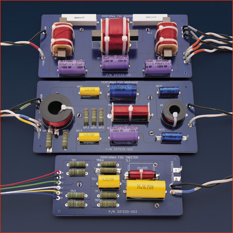

btw... here's the crossover picture... can anyone tell me whats going on here in terms of circuitry or components? I guess I'm going to have to start reading up on crossover design to try to understand what is going on.

So do I! I bought the set of swapped-out drivers I mentioned above, so now I'm also looking for a crossover schematic.
Revel has a high-res pic of the crossover on their site (same as what you posted). I can read some of the capacitor values, but the coils are a mystery. I might just decide to roll my own, though. The owner's manual shows some of the main box dimensions. However, I would like to build a box with a bevelled fron baffle. Would you like to share ideas? I also have both mid drivers.
