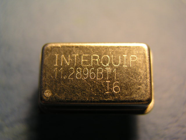

tube-lover said:hi all,
I was used this TCXO Oscillator 30PPM for the reclock circuit.
I prepare used for my twins TDA1541a DAC, any suggestion?
All good XOs I have come across are within 20 ppm of stated freq.
You want XOs with low phase noise. TCXOs have higher phase noise due to the added circuitry and are not necessary.

tube-lover said:dear fmk,
If I get the lower ppm than the 30ppm the cost will be very high.
so........... will U suggest that I use lower ppm crystal<30ppm to relief the TCXO's.
You don't need to, get the Tent XO avaiaolble in HK and you will find theye are accurate with low jitter.
