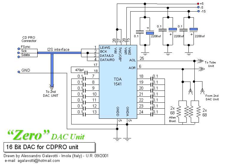

RE-clock schematic
Can anyone show me the scehmatic or the thread about the asynchronous reclocking of a DAC. I would like make one for my DAC.
Thank you a lot for your help.
Here you are,The third kusunoki DAC...The 74AC74 + CLOCK is for the asy re-clocking
cd re-clocking
Thank you X.G. for your schematics.
Can you clarify where should pin 1, 4, 10 and pin 13 be connected. Is it should be connected to 5V voltage. How about pin 14.
Thank you for your help.
This way of drawing means that pins 1,4,10 and 13 are connected to 5V, just as pin 14 of course. Please check the pins that are connected to ground to see the difference in symbols. Pin 7 has the ground symbol and pins 6 and 8 are Not Connected.

cd-reclock schematic
Thank you Jean Paul
Do you mean, pin 1, 4, 10, 13 and pin 14 should be connected all together to same 5v voltage and pin 7 is the gound?
Furthermore, from the schematic, the JX07 seems to be a 50MHZ oscillator, What is the function of that oscillator?
Thanks😕
Thank you Jean Paul
Thanks😕
Re: cd-reclock schematic
Yes.
It is the 50 MHz clock ( canned oscillator ) for the asynchronous reclocker as implemented in that DAC. If you go that way make sure you use a low jitter module and shield the reclocking circuit like one has to do with RF electronics. Please bear in mind that whatever you do chances are high that stray RF in the order of a few hundreds of MHz will creep into your amp.
There are a few variants of the same DAC without the reclocker as well. Just do a Search here on Kusonoki.
TKK1010 said:Do you mean, pin 1, 4, 10, 13 and pin 14 should be connected all together to same 5v voltage and pin 7 is the gound?
Yes.
TKK1010 said:Furthermore, from the schematic, the JX07 seems to be a 50MHZ oscillator, What is the function of that oscillator?
