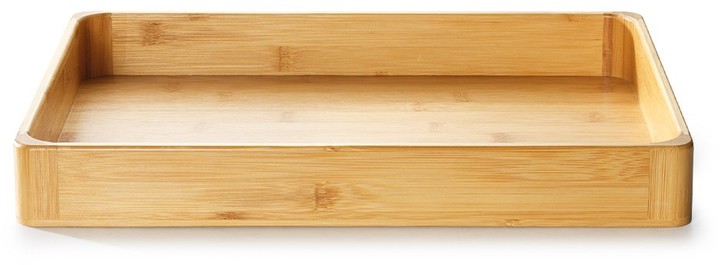

The kit has a recess cut into the back plate, which links the air space of the halves.
The easiest way to duplicate this would be to use a found object that has this recess already built in.
