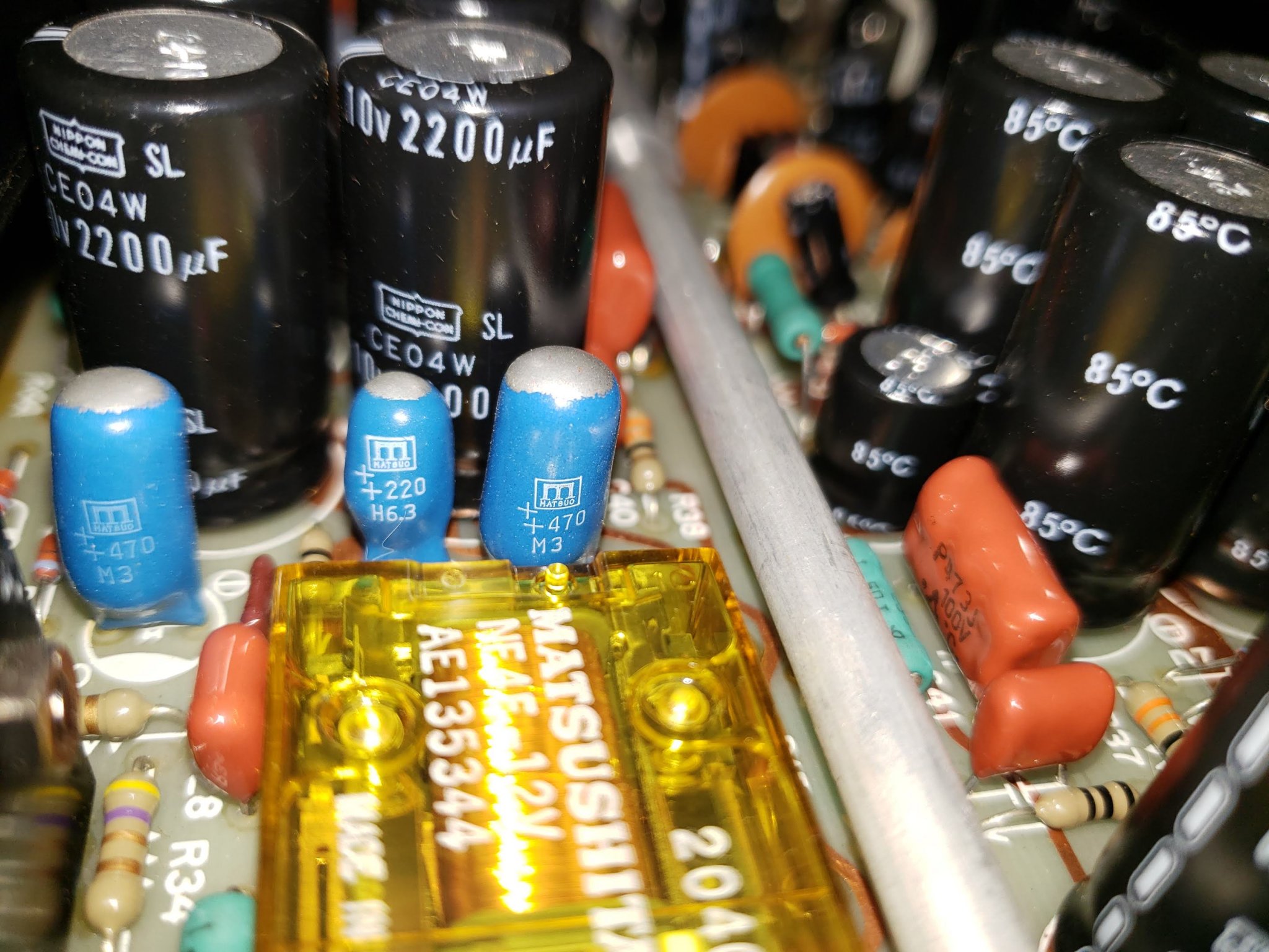

I've now learned enough about these cap names to understand what you mean. Those matsuo blue/silver on the outputs (picture above) are the Tantalums, and the Nichicon UKL are their low leakage type. I had found a thread at AudioKarma where someone mentioned they liked the UKL in the signal path as much as some of the nichicon muse capacitors.No experience with OSCON myself, but what I read is OSCON is not recommended for signal path usage. If you want to replace them, I would use UES or UKL. You might want to consider replacing the tantalums (C29-32, C37/38) with UKL.

Not sure, but the stuff around the capacitor looks like glue. Make sure you clean it up, if not they will eventually corrode the parts.
For the caps, it is recommended to bump up to the next voltage rating, ie. from 2200uf 10v to 2200uf 16v. They will last longer and have similar diameter and lead spacing.
The brown stuff is likely glue.. this glue is best removed though as it becomes conductive with age and causes all sorts of issues. Scrape it off anywhere you find it. While you're at it you can replace the capacitors, though it likely isnt needed. Don't go overboard with fancy "audiophile" caps, just use a good quality brand such as Rubycon, Nichicon, Nippon Chemicon or Panasonic. Avoid stuff from eBay.

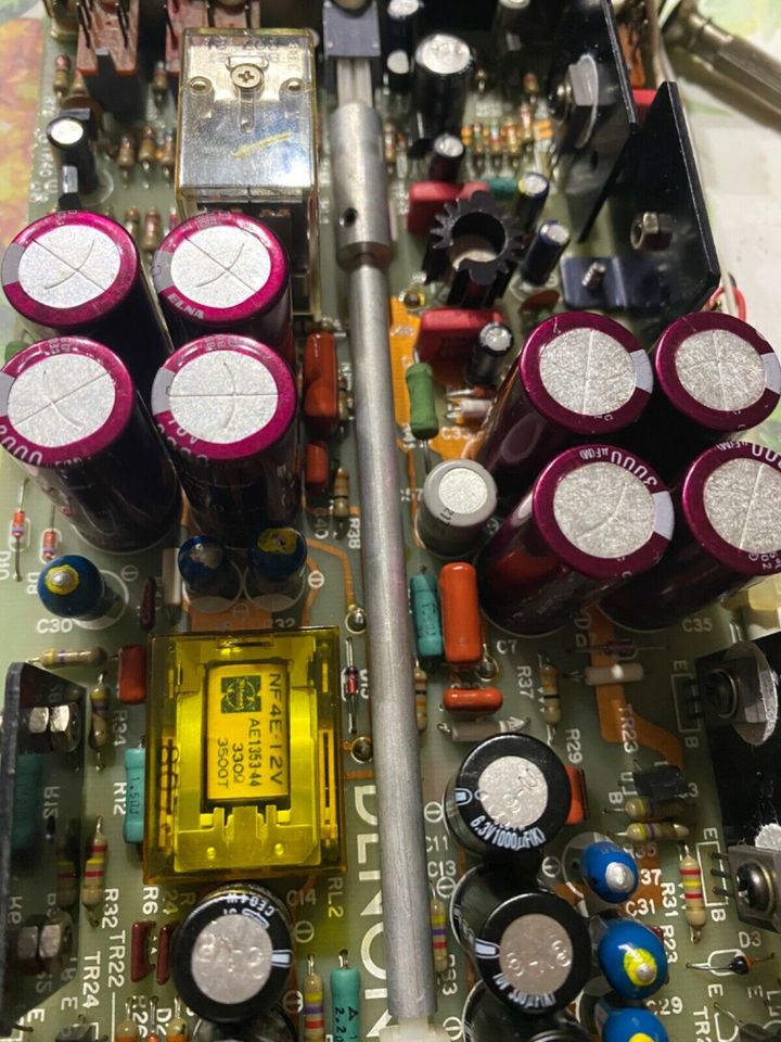

I recapped just the 2200uF/10V caps. Used the 3000uF/16V ELNA ("Pioneer" labelled) surplus lytics available on eBay. Great result. Denon did install 10Vdc smoothing on a 9.9V (my meas) supply rail, which may explain why they get leaky. I did not find other caps to show any deterioration and left them as installed to preserve the character of this pre. To my ear the HA-1000 is one of the few components that can really make a vanilla DL-103 rock (i.e. supply ample thump).
