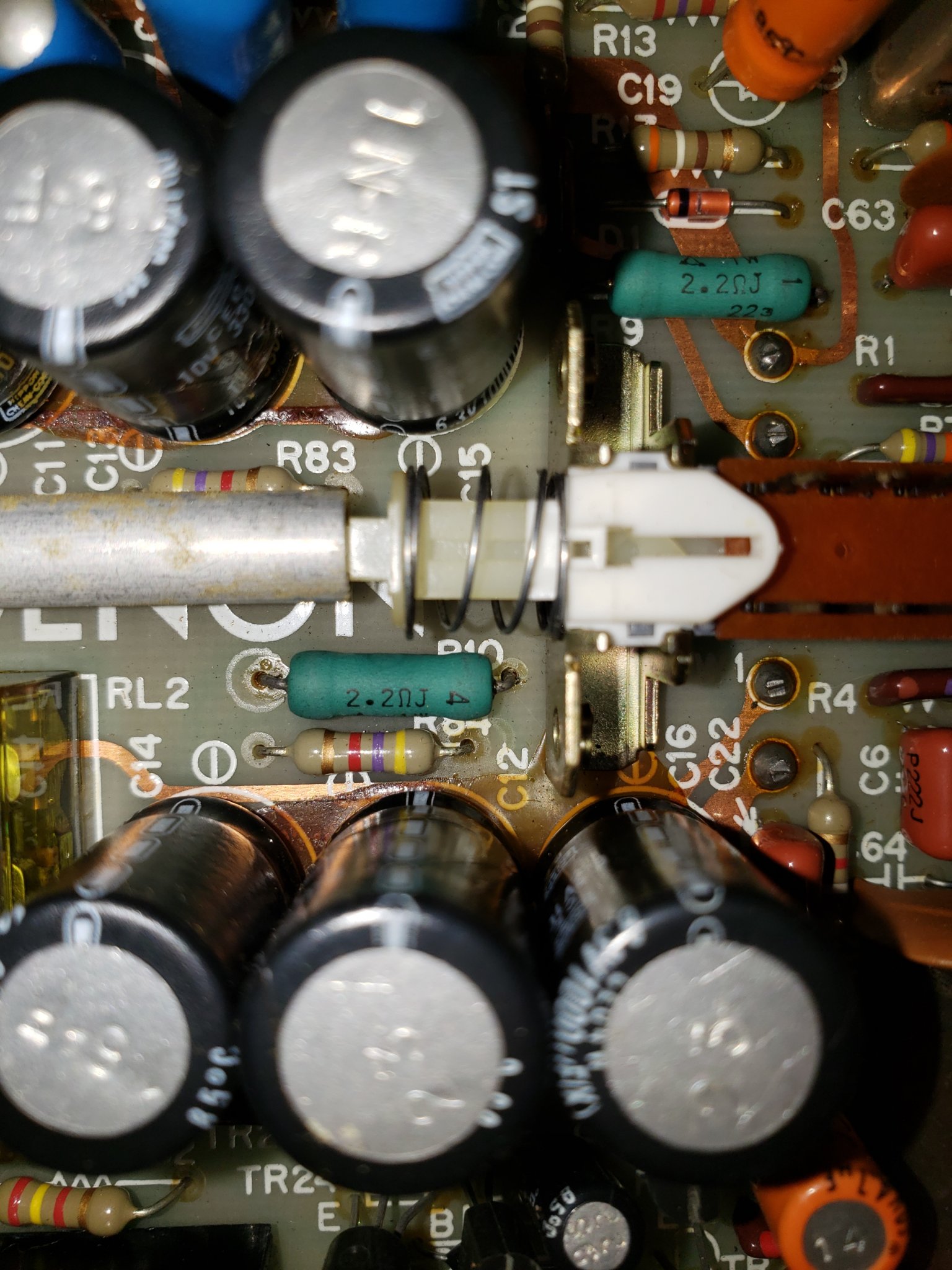

Hi everyone, I recently purchased a Denon HA-1000 mc headamp. It's in great condition, working fine and sounding fantastic.
I opened her up and there is either some mild leaking of some EL caps but it could also just be glue. Most of the edges are really smooth so that probably means glue. There is one place where some crystals are showing so that area is probably from a minor leak. All the other caps show no signs of glue or leaks. The unit is probably from the late 70s or early 80s so some preventative recapping is not terrible idea.
I've found a schematic online and I'm looking at what I might want to change. I really like the sound so I don't want to change too much right away, but I am open to discussion if there is something (like improved voltage regulations) which could elevate the sound. In general I don't like the shotgun approach of changing everything at once. I'll just start with a few select locations where the caps could be leaking or stressed from age, or where I think a more modern cap can be an improvement.
My plan so far is to focus on the rather generic black wrapper chemicon larger caps. I want to do Panasonic FR for the outboard PSU (2200uf/35v: C4,C5), the larger rail bypasses (1000uf:C11,C12; 2200uf:C7,C8,C9,C10,C33,C34,C35,C36; 330uf:C13,C14) and I'm also thinking about Panasonic OSCON for the input blocker caps (470uf/6.3v: C1,C2,C3,C4) and maybe for the 1000uf at C15,C16 which I think might be part of the feedback loop. The input caps are too big a uf value for film caps, so I think OSCON is a reasonable upgrade. Since it is just a MC headamp there is no RIAA circuit.
I still need to measure the diameters of the caps and lead spacing so I am in no rush. I'm just at a planning and thinking stage now.
I'm searching for some discussion on the circuit. Is there some other parts I should focus on?
After the initial re-capping, is there some part of the circuit that could use an upgrade like improved voltage regulation.

Hello,
IF it sounds fantastic i would not change to much.
If the capacitors are not stressed at all by high temperature of the surroundings or high current needed by the circuit they still can be very good.
Changing the input capacitor could improve the sound but you will have to be careful and use the right one. I dont know which one that will be.
Of course there will be people who will tell you to upgrade the power supply. There are some tiny boards available that could do the trick but then you could end up with '' destroying '' the inside looks of your device. AND you will need the knowledge or the help of some people to do it right.
Maybe there are some switches that you dont need and that could be bypassed?
Greetings, eduard

No experience with OSCON myself, but what I read is OSCON is not recommended for signal path usage. If you want to replace them, I would use UES or UKL. You might want to consider replacing the tantalums (C29-32, C37/38) with UKL.
Reactions: jeshi
C1 - 4 and C29 - 32 are in the signal path and will effect the sound. The rest are all power supply or local power supply bypass caps. They bigger supply caps will have lost some capacitance by now. The input and output caps largely determine the sound so if you replace them do it so you can put them back in if you don’t like the change. Modern PS caps are a lot better than the old ones so change those out with new ones that fit. Use the same or higher voltage, same uF. You can bypass the input and output caps with some small polystyrene caps to make them a little faster giving you better highs but that is totally subjective. The unit is well built and well designed so don’t mess with the circuit itself. The PS caps should give you lower noise and cleaner sound. The input and output caps will give you more clean detail. Just enjoy your new hobby. It will become an obsession if you are not careful and remember it’s all about the music not the technical numbers. If it sounds good to you that’s what matters!

That’s a pretty cool old amp there. What you are saying and what you are planning on doing are different things. The parts you are planning on replacing are likely standard types of parts. Both the oscon and fr are both extremely low esr parts, and may not play nicely, or may even cause oscillations if used in certain parts of that circuit.
I’d probably stick with more standard parts until you really know the circuit, like the designer did.

thanks so much. I'm glad to hear this is such a well designed and well built circuit and doesn't need any "tweaking". I'm still a little worried about those leaky capacitors in the photos.
Am I correct in thinking that replacing just the power supply and local power supply bypass caps with something modern like a Panasonic FR or FM shouldn't cause problems and it is good idea given the age of the unit? Or is "phase" correct above saying that the Panasonic FR is too low an ESR, might cause oscillations and that I should replace with a similar grade of bypass capacitor (maybe Panasonic FC)? I thought low ESR is a good thing for a local power supply bypass capacitor.
I will definitely be very cautious about changing anything in the signal path. I do like the idea of playing with bypassing the input/output caps with some parallel polystyrene or other caps (paper-oil, PP etc) to see if I like the change in sound. It would be easy to reverse (un-solder) if I don't like them and I would not have modified the original circuit.

will a low ESR capacitor cause oscillation problems in a simple local power supply bypass? I can see how a lower ESR capacitor might cause problems when in series in the signal path (like a blocking capacitor), but when tied to ground as a power supply bypass I thought that would be ok?

I would just get parts that are more standard replacement and enjoy that amp, low esr parts aren’t going to improve much there, and have a risk of more noise, stress on other parts.

I checked my photos and it looks like they are Nippon chemicon SL and ST series capacitors. They aren't made anymore and I haven't found spec sheets but I did find this seller of NOS SL which says they are long life low ESR milspec capacitors.
https://richelectronics.co.uk/produ...electrolytic-capacitor-1000uf-16v-85c-mbe002fI'll keep searching for more information on the ST series.
I might also just send an email to Nippon Chemicon and ask them what a modern equivalent for the ST and SL series would be.

If you have the meter to measure the power supply caps, unsolder one and see how far gone it is. If close, don’t worry about them. Any modern cap is likely to have a lower ESR than those old caps and since this is an audio frequency preamp I doubt you will get into trouble with too fast a cap. Remove the parts so you can reuse them if you don’t like what you hear. Try the bypass caps on the signal path caps. Yes, all caps effect the signal but the ones in which the signal enters and exits the preamp are what I’m talking about. You will end up with a sound that has more transparency and darker background allowing you to hear more low level detail. Preamps are not hard on power supplies like amps are so just replace the caps with the modern equivalent according to the manufacturer and don’t oversize them as many like to do, there is a reason they were that size. Do one step at a time and listen for a while. If it you like it keep it. Like is said before, it only matters if you like the sound not some know it all telling you what you should like.
