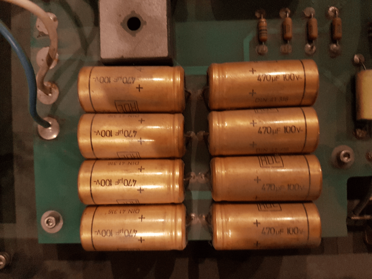

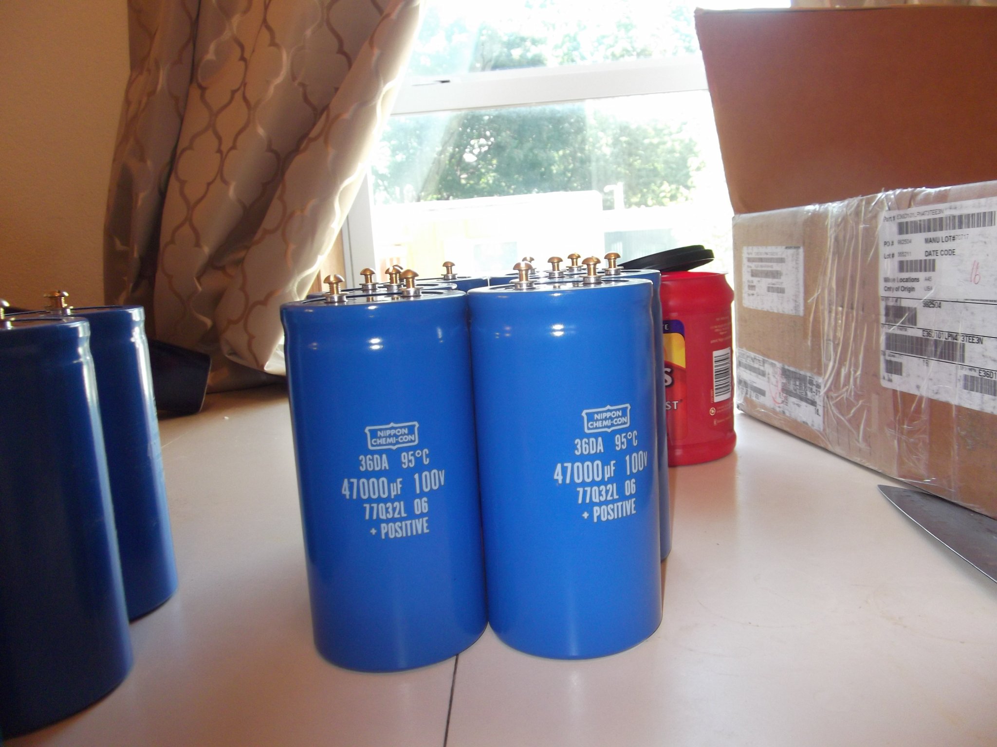

HI.
YOU NEED 12 (47000UuF 100V AT 95C USA MADE UNITED CHEMICON CAPS REPLACING EITHER MALLARY OR OLD SPRAGUE 40000uF 100V.
ALSO GERMAN 32 AXIAL ROE CAPS MADE IN GERMANY MUST BE REPLACED WITH VISHAY part# MAL212019471E3 MADE IN AUSTRIA IN STOCK AT MY HOME STATE IN MINNESOTA. OR CHECK WITH MOUSER. THE BIG CAPS MUST BE MADE AT UNITED CHEMICON. THEY ARE 95C ALL SOLD. NEXT TO IMPOSSIBLE TO GET. 44 CAPS ARE YOUR POWER SUPPLY.

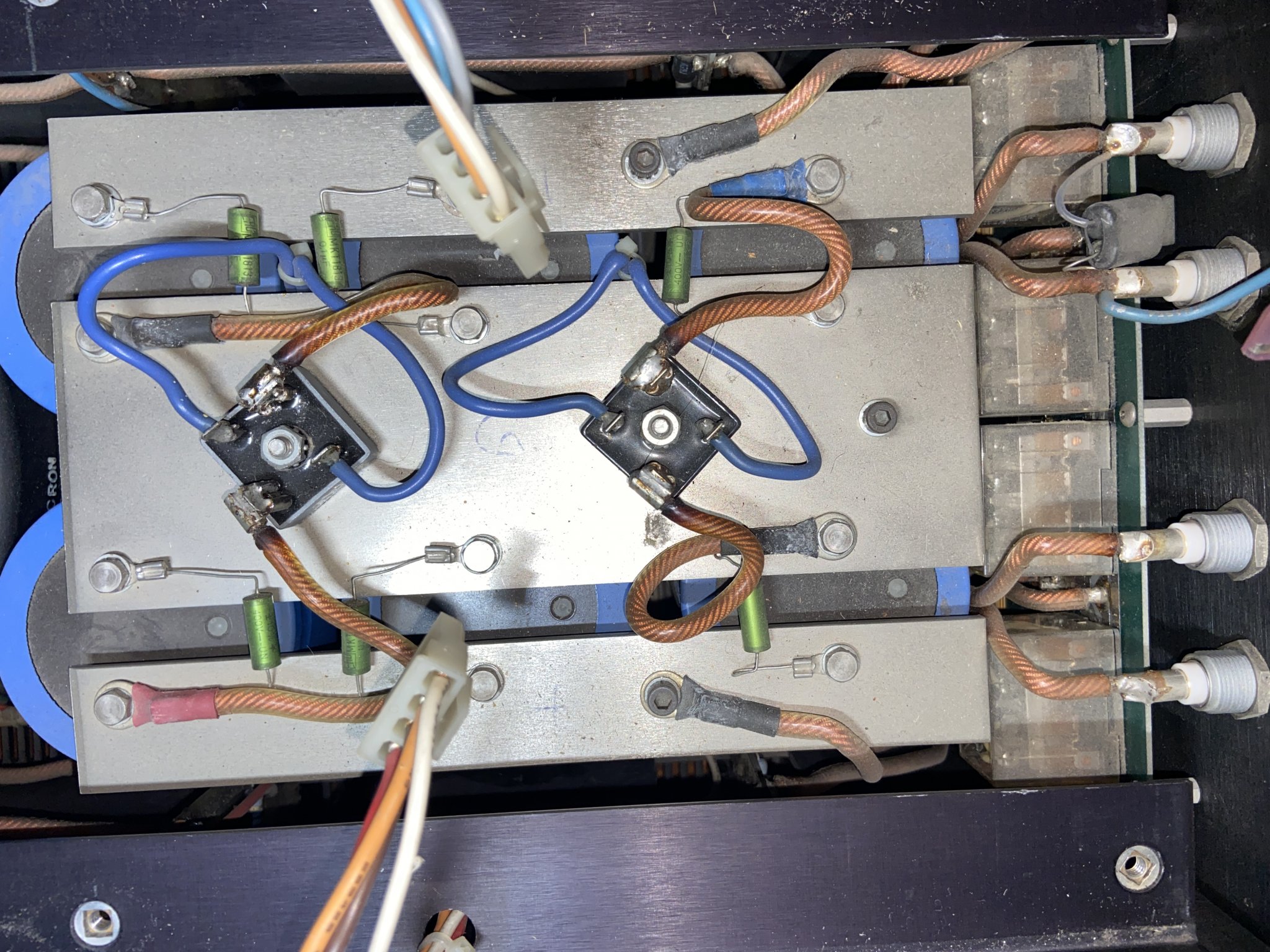

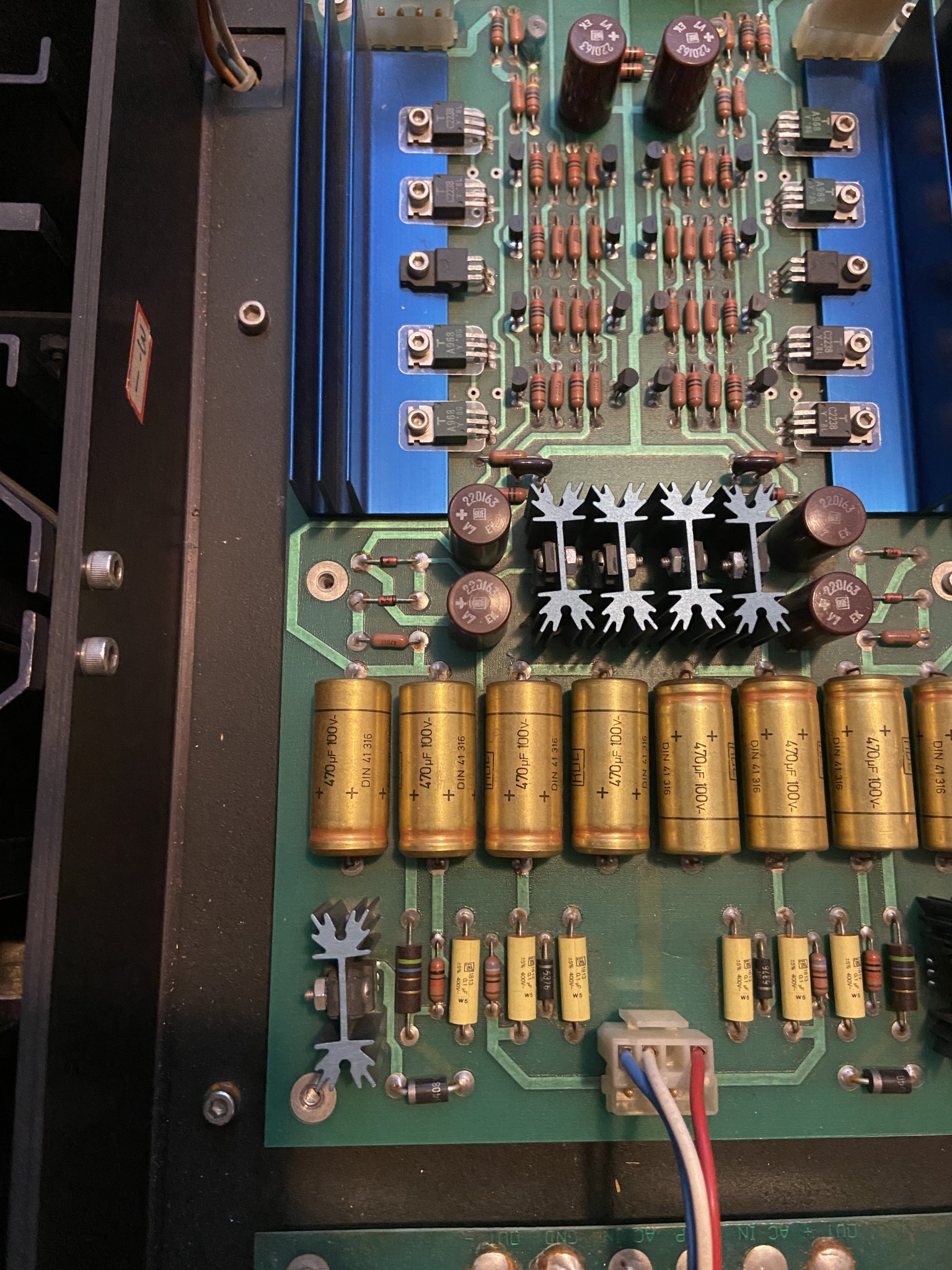

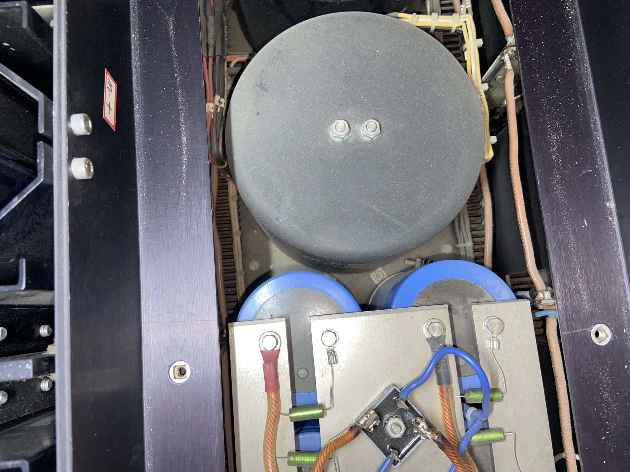

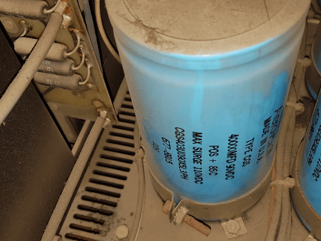

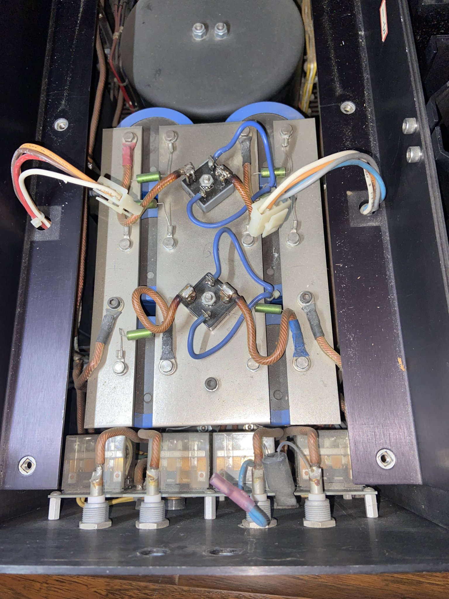

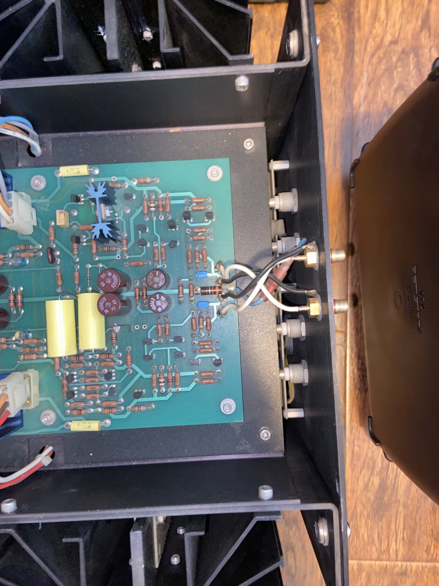

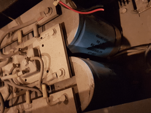

Okay, I believe my gold ones have been replaced before. Here is a photo or two
