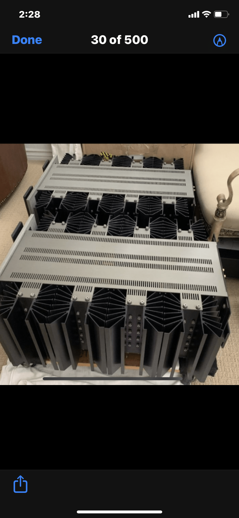

ALRAINBOW The owner of the ML.No.33 Mono Blocks completely over hauled with brand new ultra high end parts. it is working like a new amp. Huge improvement in sound. Replaced 28 power supply caps made by United Chemicon and Cornell Dubilier and all the radial caps.
The only caps we are waiting from Cornell Dubilier factory is the 330uF/100V ultra Low ESR high ripple super expensive 301r331u100je2 these caps are replacing the original URZA (United Chemicon ultra Low ESR caps since Chemicon will not make those anymore. Cornell has better spec. The amp uses 24 of them for power supply.

The ribbon cables used inside were the cause of one amp not turning on. They are very sensitive. I'm ordering new ones soon. A big thanks to renjy651 without him I would never be able to get the correct caps. The man is a capacitor god. The 330 Caps had to be made and a min order of 100 pcs was needed. I'll be selling off the bal of them when done after keeping a few Spares. I cannot say for certain anyone who did change all caps like I did. But I truly doubt it as this is a very long and exp process.

What I did was this first all main psu caps and reg supplying caps this alone is 14 caps
Put it back and check and adjust some 14 test points cold and hot per amp
Then again take it apart and do the rest of the caps some 60 or so
On Addition o verify each new cap with a capacitor analyzer as well as my own methods of charge and discharge
