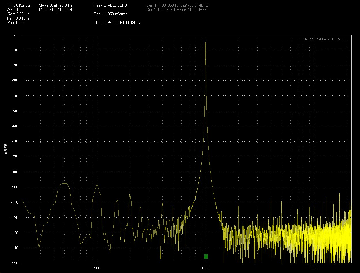

Like the SMSL SD-1955 or one with the AK3499. I have the CDP-222ESD, but that is using the TDA1541.

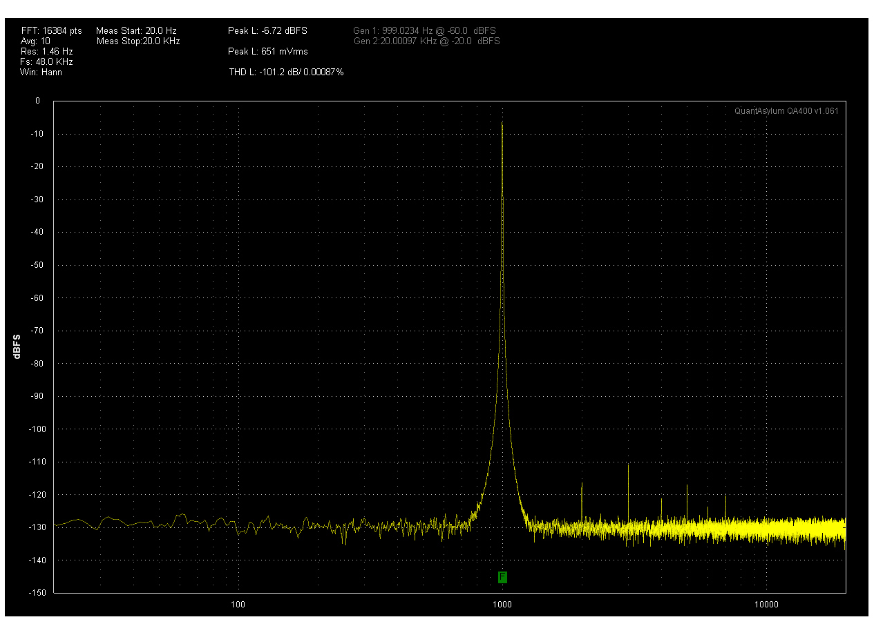

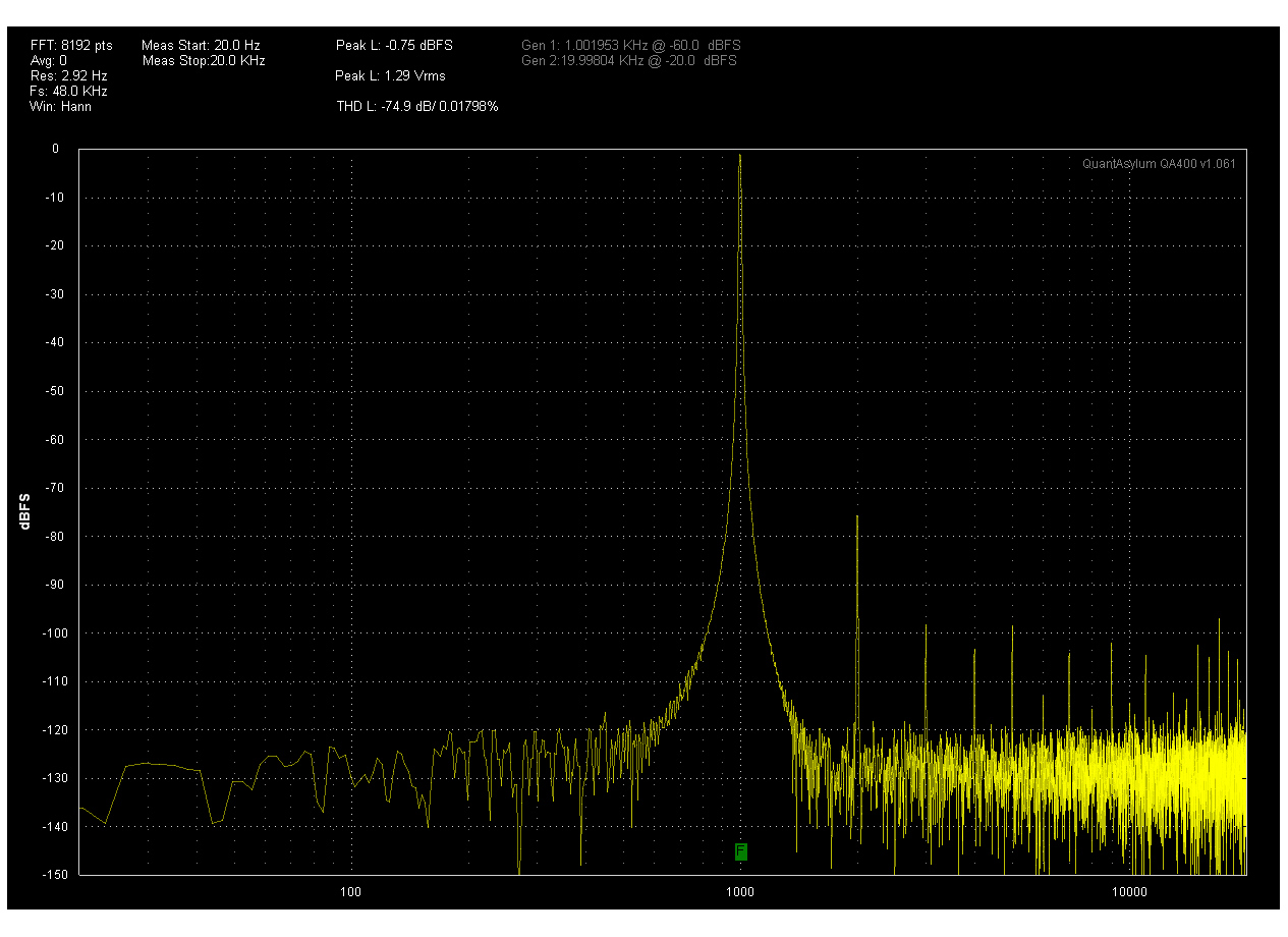

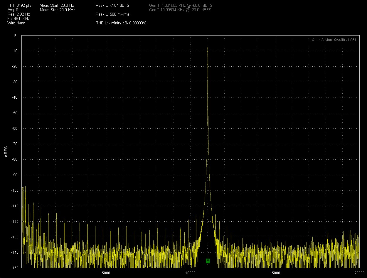

Last year I measured it with a QA400, a bit better than a CDP-490 which using the PCM56. Jitter track is Wakibaki's Jitter3.
Pics CDP-222ESD 1kHz 0dBFS, jitter, CDP-490 1kHz 0dBFS

I think the first generation was distorting , certainly on 0 dBFS signal. The + - PS to the op amps where to asymmetrical. I bypassed the protect diode on the PS input and that cured the thing. I found the AK4399 is a better DAC than the SMSL SD-1955, but with not much.

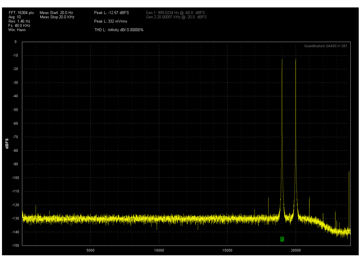

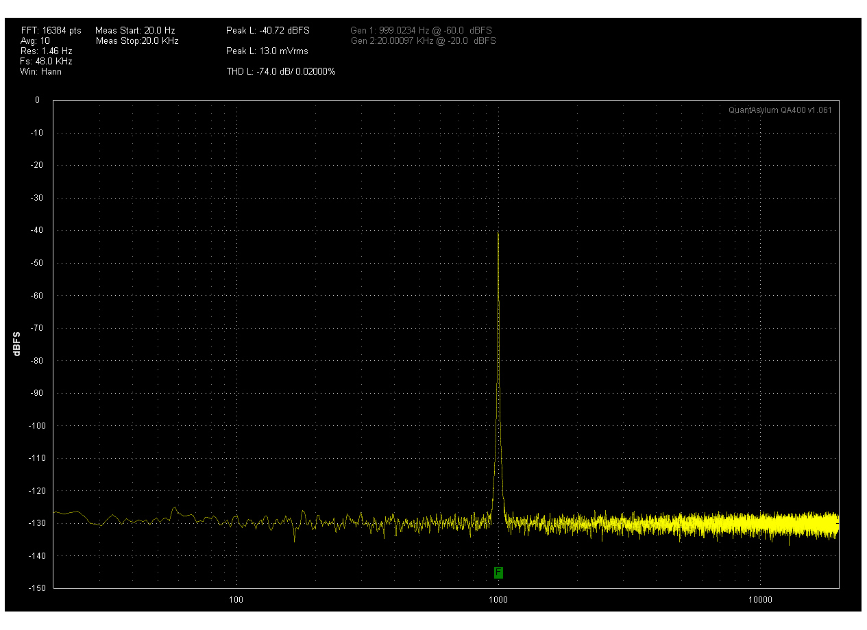

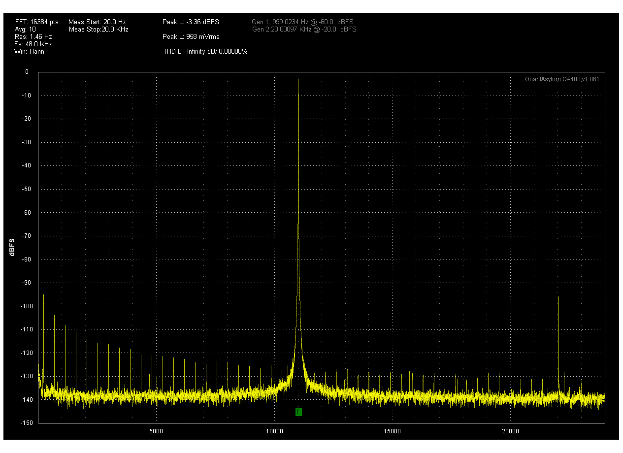

The easiest way to get higher quality sound for your CD's is to buy a 10-14 years old DVD player. Blue Ray made them obsolete for many people. Very good one's the Pioneer DV-45a and the 47Ai, they go for less than 100 bucks on ebay and they are hard to beat. Also they play SACD and MP3 to. Pictures from left to right are: -6dBFS, -40, IM and jitter.
