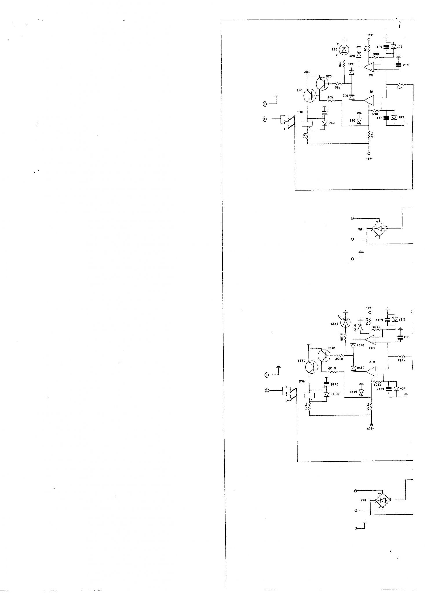

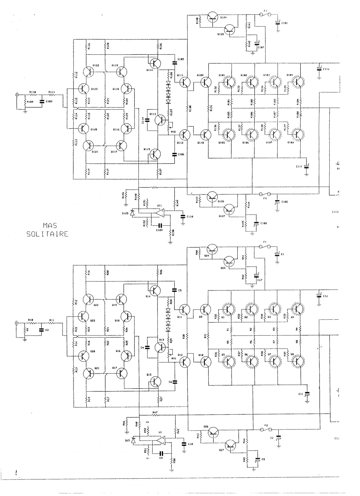

I have a pair of Metaxas Solitaire Amplifiers that drive my Infinity Kappa 9 speakers
The amps were sent to a reputable Perth electronic service outfit ,but were deemed unserviceable by the technician.
The amps in question were revealed on the techs' Hall of Shame
The Hall of Shame is the only page dedicated to exposing bad hi-fi repairs
So I have decided to rebuild myself , but the question is - Is it a Bridge too Far for a novice to undertake?
I have plenty of time at my disposal as I'm retired.
Any comments would be gratefully received.
Thank You.
In short:
1. yes, it's a helluva task for a self-described 'novice' to undertake - irrespective of how much time you have available!
You may end up after lots of time and money spent ... with an unusable piece of junk.
2. The amp is on the "Hall of Shame" list for a reason; why do you think that 're-building' it - even if it was well within your sphere of competence - will correct the things that were the cause of its promotion to the HoS?

Whatever this means, the amplifier in question has a traditional multi-stage topology.To the best of my knowledge, Metaxas amplifiers are single-stage designs ...
Did the OP manage to do the repair ?
an audio power amplifier should have at least two stages of gain.
Don’t tell that to Nelson.
dave
