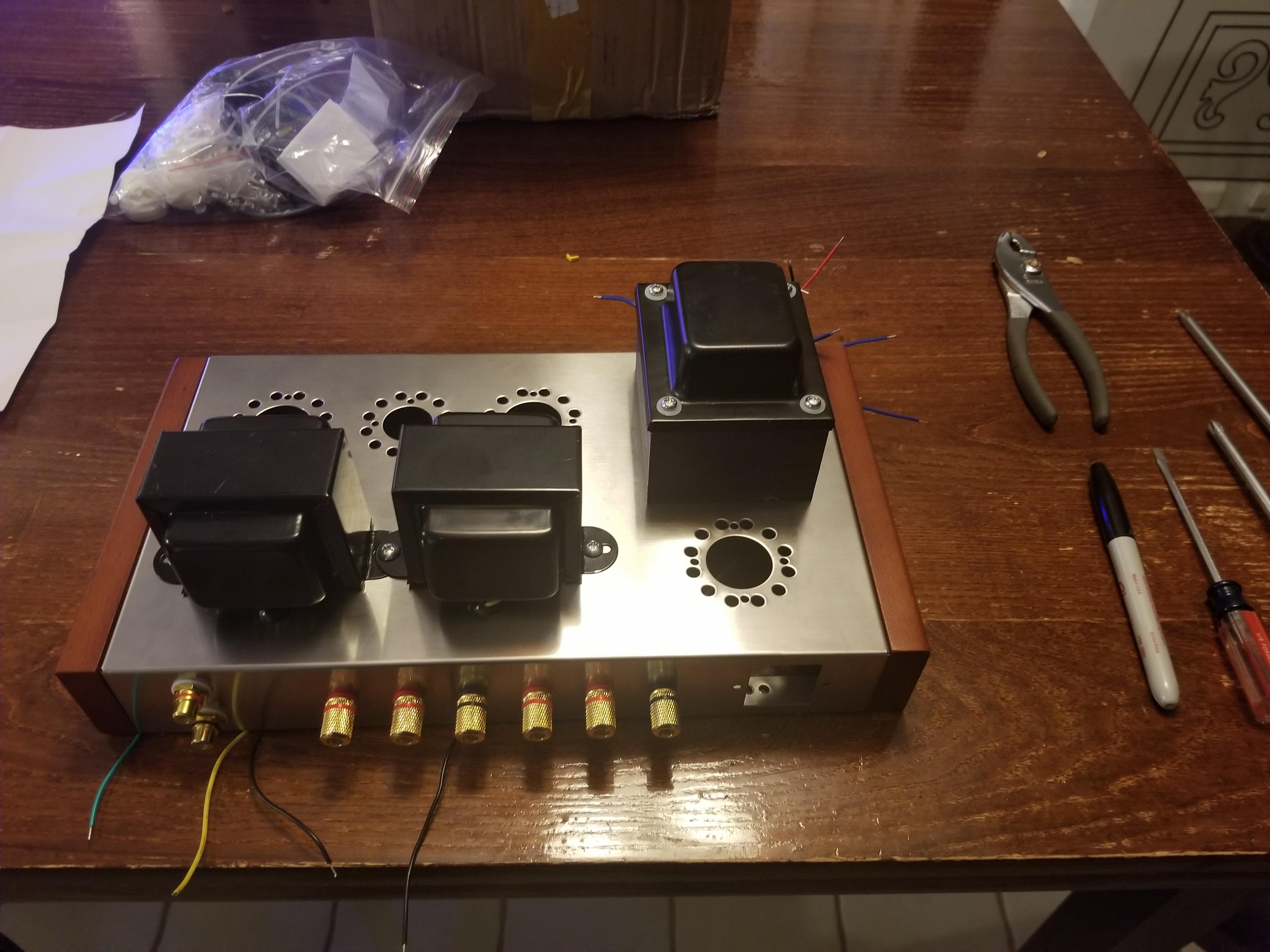

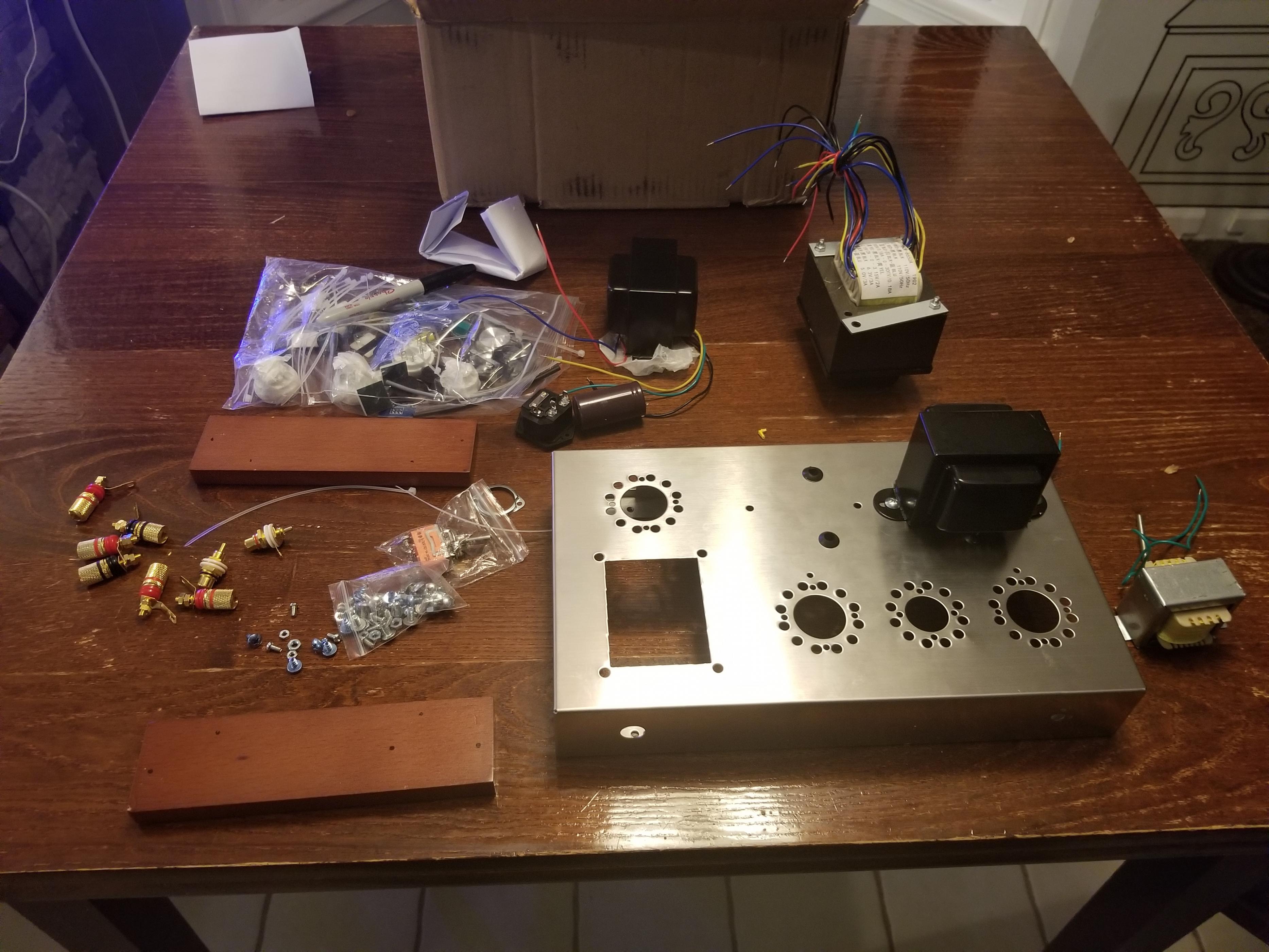

Attached is a picture of the parts after unboxing:

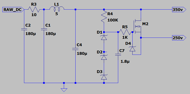

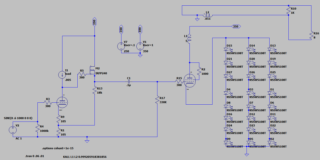

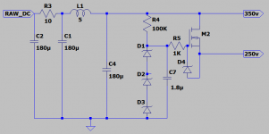

Schematic I'm going to use. I'm also planning to use a CRCLC input filter for the B+ and also regulate the input triode voltage with a zener/Mosftet follower regulator. I'm also planning to use DC on the input triode heater as well.

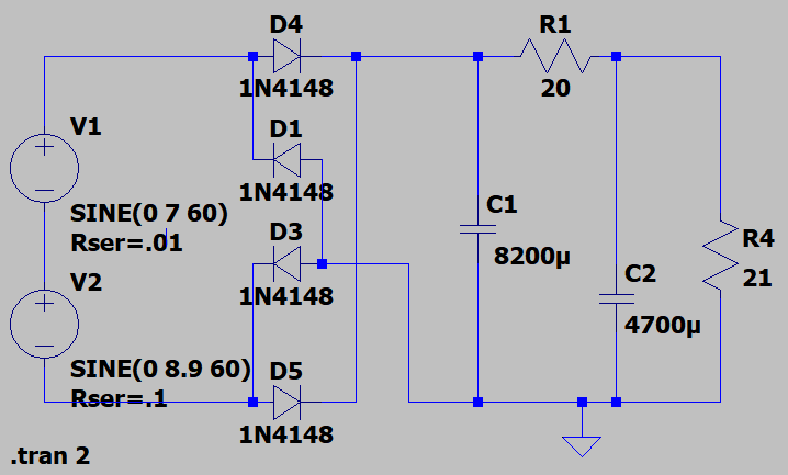

The 6N1P heater runs at 6.3v and .6 Amps, which is equivalent to 21 ohms while hot. The heater circuit uses a bridge rectifier and a CRC filter to give me a ~9v tap and a 6.3v tap (with a little AC, but not much).

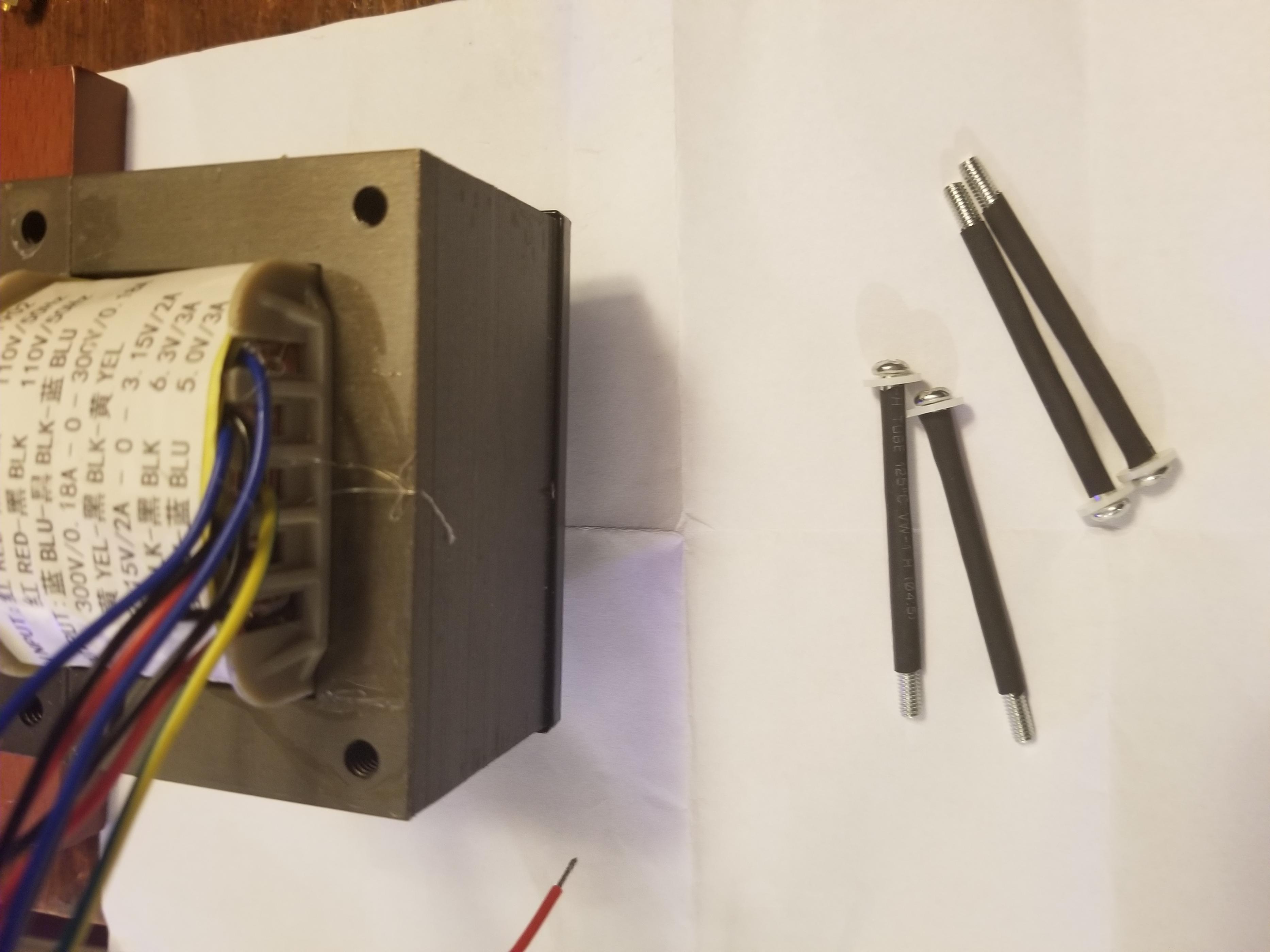

The first step was to insulate the screws that hold the transformer together with plastic washers and heat shrink tubing (thanks Wavebourne!) to pevent eddy currents and vibration.

The first test of the top components. Two of the output transformers share a singe screw, and the choke on the underside shares one of the output transformer screws. I hope there's no magnetic coupling, but there's nothing to be done about it now.

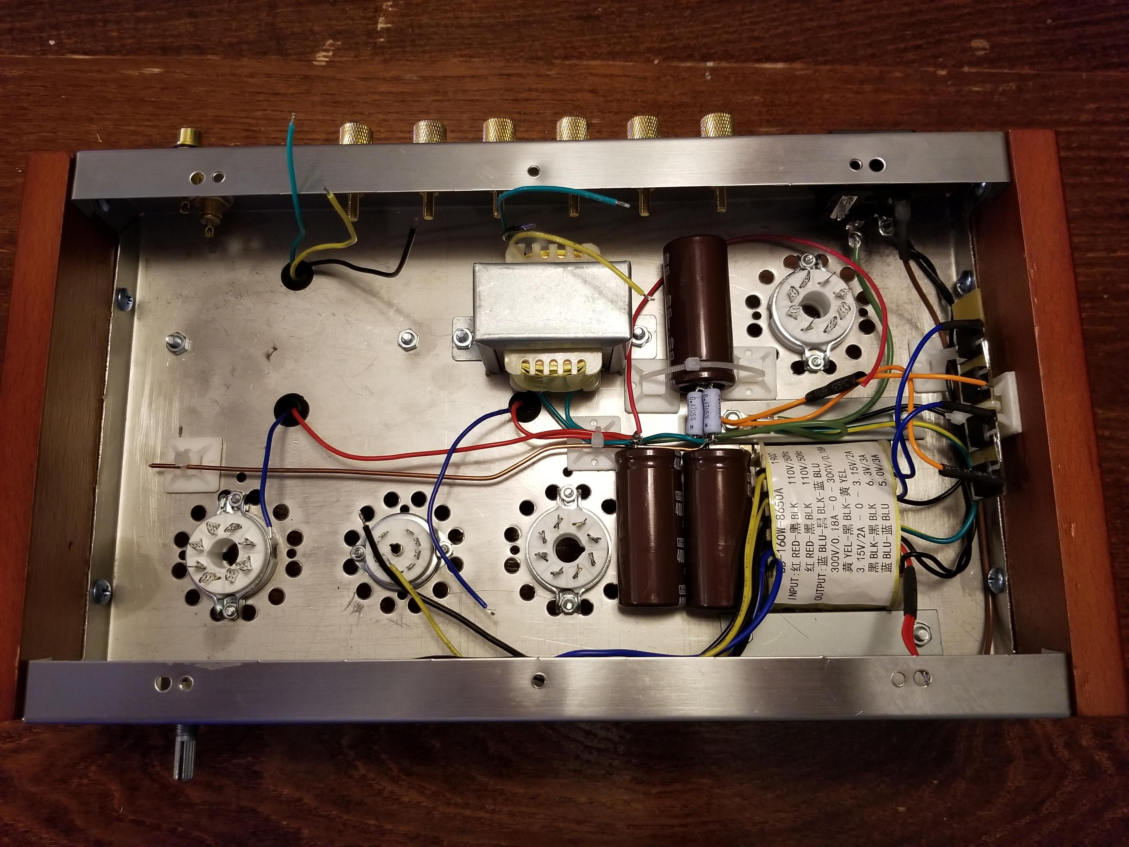

Here's the first test fit of components. The Ground connection is using a piece of 14ga ROMEX as a bus bar.

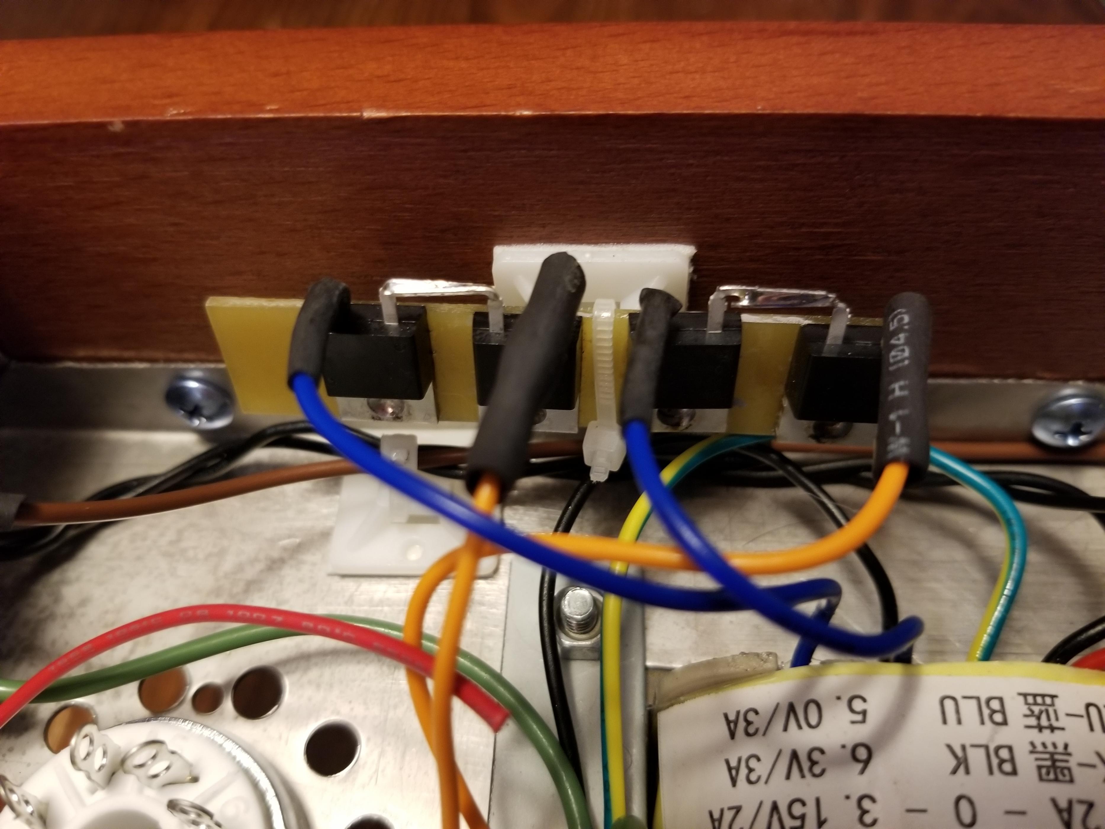

I also decided to use solid state rectification instead of the tube rectifier. Because the transformer is a 300-0-300 meant for half wave rectification, the rectifiers will see at least a 600v difference. My Schottky diodes are only good for 600v, so I doubled them in series to give some overhead. They're soldered to a piece of PCB for mechanical structure and mounted to the side by the transformer (the right side of the picture).

The 300-0-300 with two diodes is full-wave.
300VAC will rectify out to 420V DC. Your plan shows 350VDC. There's almost no drop in the too-small resistor or choke. Also 180u 10r 180u is almost no different than one 360uFd cap. I figure this resistor will end up nearer 500 Ohms. I'd start with two 500r 10W in series and see where that gets you.
If roughly stereo class A amp with 6L6 tubes would consume 120-140 mA of current, and 10% drop under the load would be around 40V, you get like 380V rectified, or about 375V on anodes, with voltage drops on a choke and output transformer primary. Minus cathode bias. If it is too much for 3K5 primary output transformers, then yes, the resistor for a power filter can be added and calculated. For 50V voltage drop and 140 mA current it should have 360 Ohm value. Power loss on it would be 7W, so 10-15W resistor would be fine.
The resistor in the CRCLC is primarily to reduce initial inrush and drop enough voltage to keep under 400v across the capacitors until the tubes warm up enough to conduct. The source follower in the driver stage at start up will have a load of about 16ma per channel until the tubes conduct, so hopefully this is enough load to keep the voltage down and the capacitors safe.
Such transformer with SS diodes and 470 uF first capacitor does not cause any inrush problems. "Keep under 400"? Calculate for yourself. Find online calculator for RC time constants. Voltage drop on 16 mA you can calculate using Ohm law.
"Hopefully" in electronics does not work, you can calculate everything.
