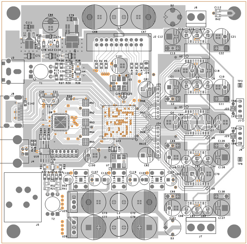

How are you handling the ground with the FPGA being such high speed, is there possibility of it interferring with the PCM ?

There are separate ground planes for FPGA and PCM - and we did not found interferences.

Top layer layout for RD30.

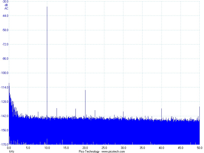

Did you see the jitter measurements?
Any PLL has intrinsic jitter. I would have preferred the usb slaved to the DAC, but I reckon this approach is more flexible and it works for the other inputs (where otherwise a clock signal would have been required).
I guess the term "PLL" induced some misunderstanding. The USB is actually slaved to the dac; when usb is active the Si570 is programmed with a fixed frequency (22.579 or 24.576 Mhz) depending on the signal sample rate; being asynchronous, all transfers are made after this clock, which is as good as a fixed oscillator.

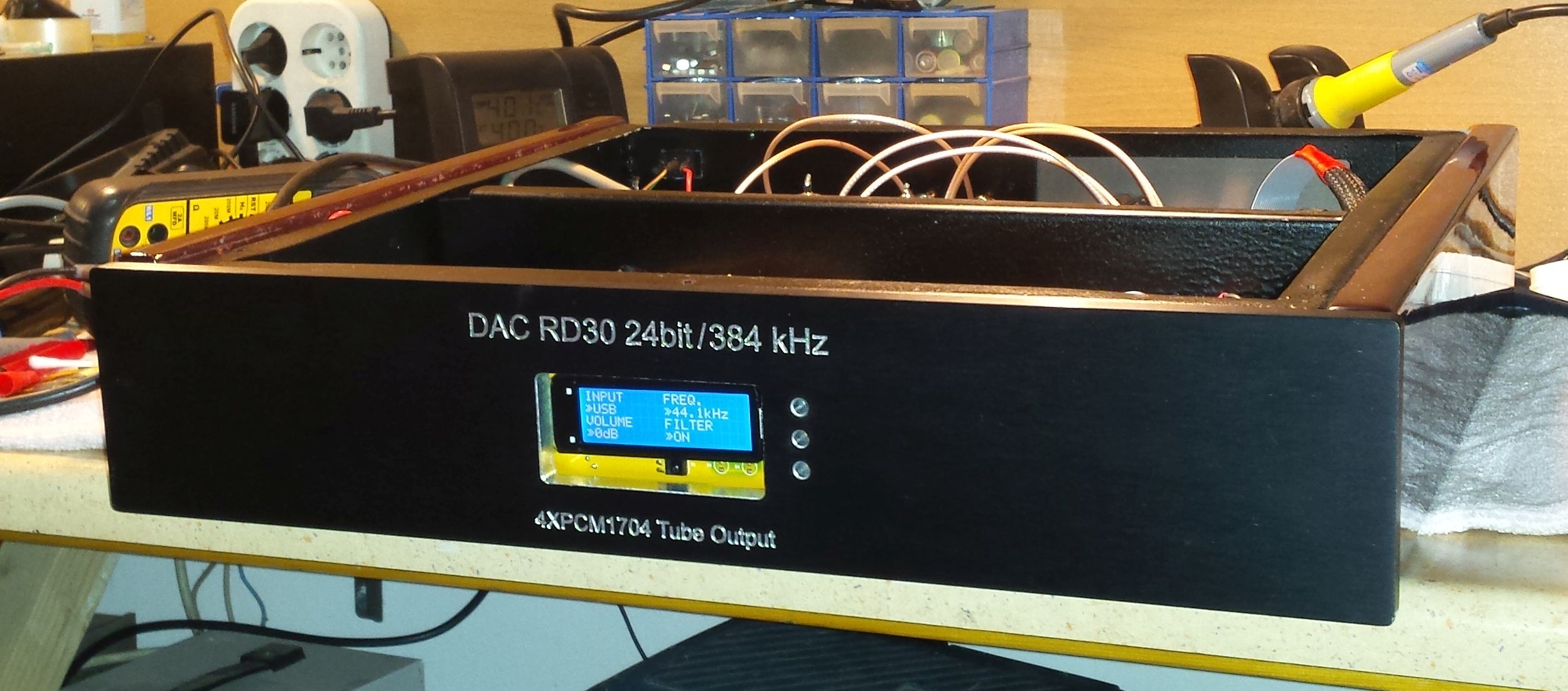

The filters are simply switched with the remote using the dedicated menu entry.
You can switch between 2 types for now - you can specify me the type of filter(s) wanted.
