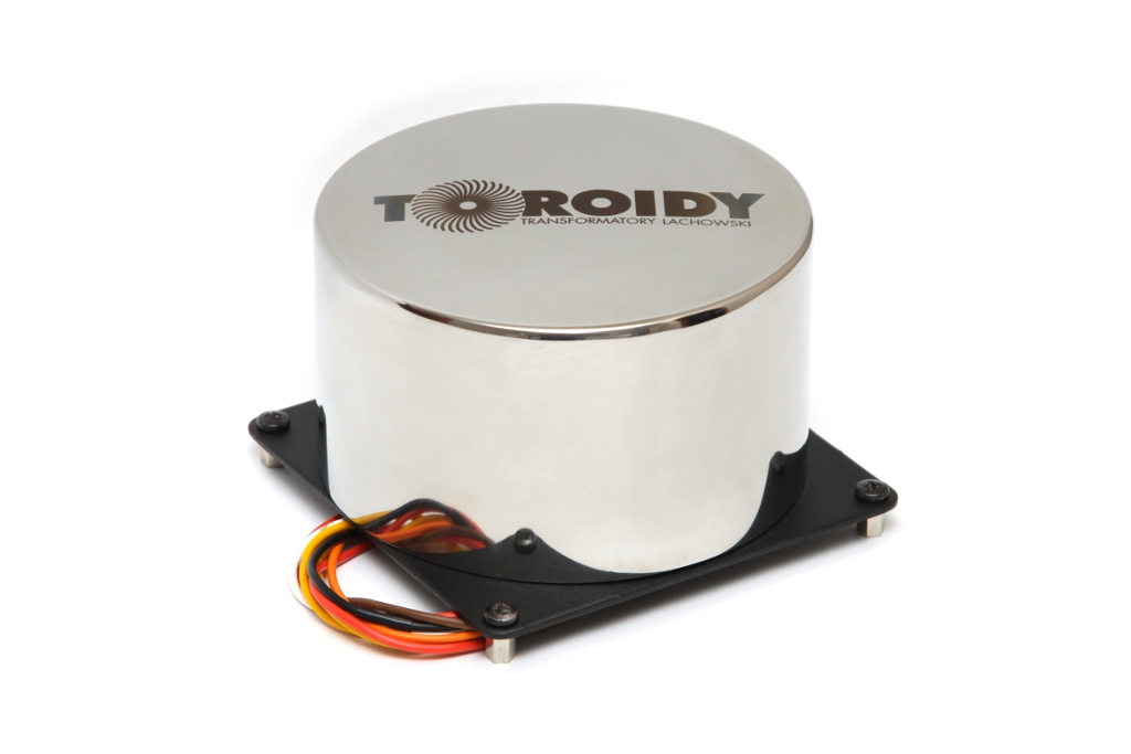

Because of the unattractive distortion toroid cores innately generate.
This claim doesn't make sense at all.
mctavish,
the distortion is a consequence of the torodial shape, high material density, high permeability, that is, high efficiency. High efficiency implies high distortion. No exception to this generalization.
So what?
Distortion at low frequency happens due to increase of magnetizing current, with increasing flux density, which, when approaching saturation, results in a drop of inductance, hence more elliptical load line for the driving tube.
Distortion in the micro-swing zero crossing region is dependent of the core hysteresis, which is dependent of core material type, air gap amount, but I'd like to see numbers of the significance of this before overall claims.
Distortion in the HF region occurs again due to ellipcal loadline resulting from total shunt capacitance and/or leakage inductance.
IMHO, the problem with toroid transformers has mostly to do with the use of mylar insulation, which sounds nasty.
+1. Is an unattractive toroid core then acceptable?
Well said! That's exactly the kind of humour that attracts me 😀.
Personally I would prefer C-cores and would stay far away from the cheap designs. Cheap means cheap materials and winding methods.
Do you say that toroids are made of cheap materials, applying a cheap winding method?
Why does it?
Well, let me try to think about it. The dielectric constant of Mylar foil is considerably larger than that of oil paper, for instance. That's why especially musicians or makers of boutique guitar amplifiers swear on oil or Kraft paper in their transformers. But what's the truth? I dunno, 'cause I never had the chance to compare two OT's, one with Mylar, the other one with paper insulations, in the same amplifier. And most probably I never will.
Best regards!
