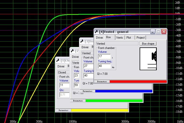

The above is the driver under discussion ? not the linked to 12" ?
Interesting driver, good xmax, but Fs is higher than a typical hifi driver.
Vented you want the port frequency to be = low E = ~ 40Hz.
The extended shelf alignment is moreorless 1cuft and this is rather
large for an 8" driver, possibly a compromise here. Any box larger
than Vas is usually not a good idea.
I'd go sealed for the monitors possibly, 5L to 10L stuffed.
🙂/sreten.
