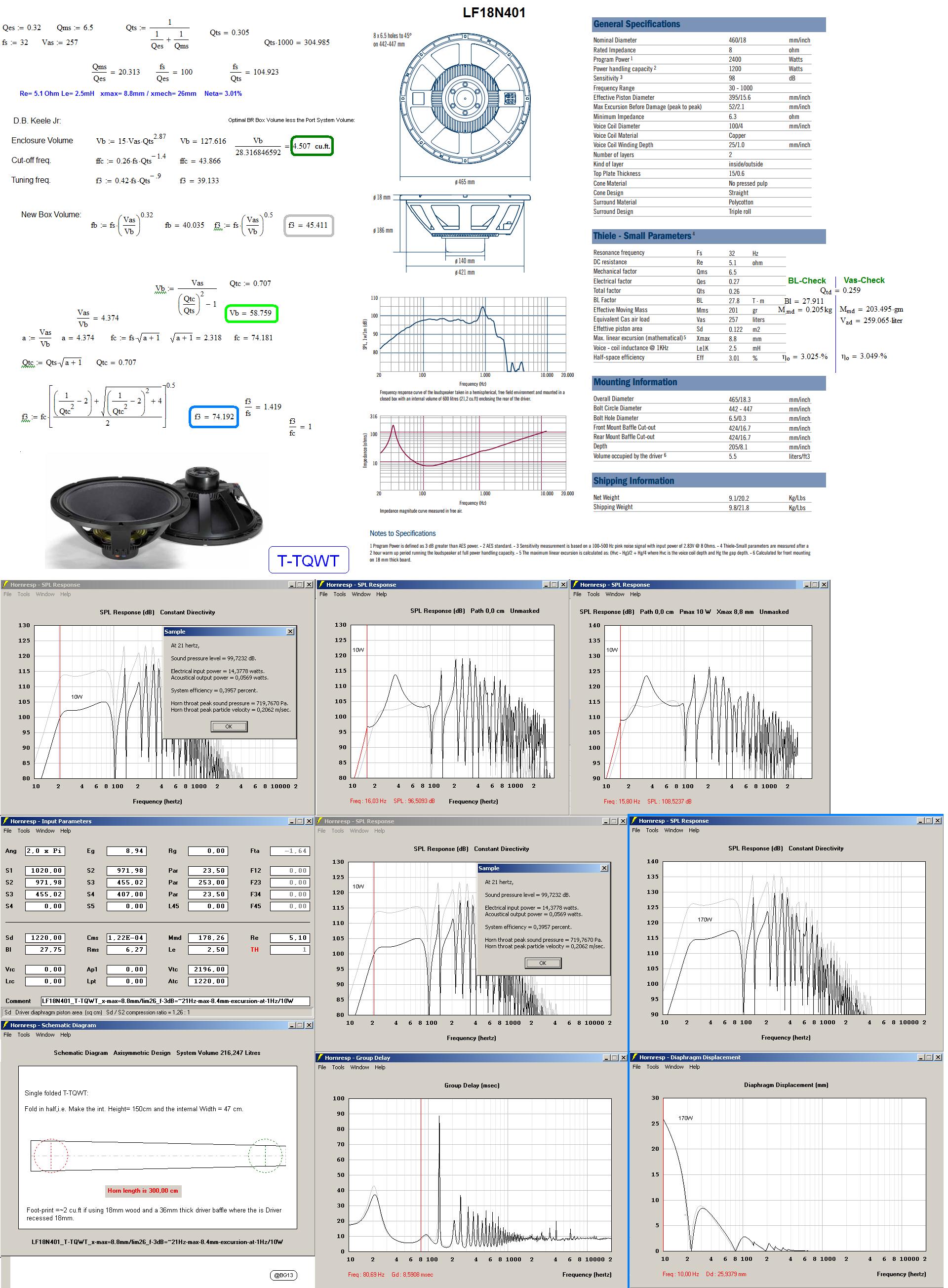

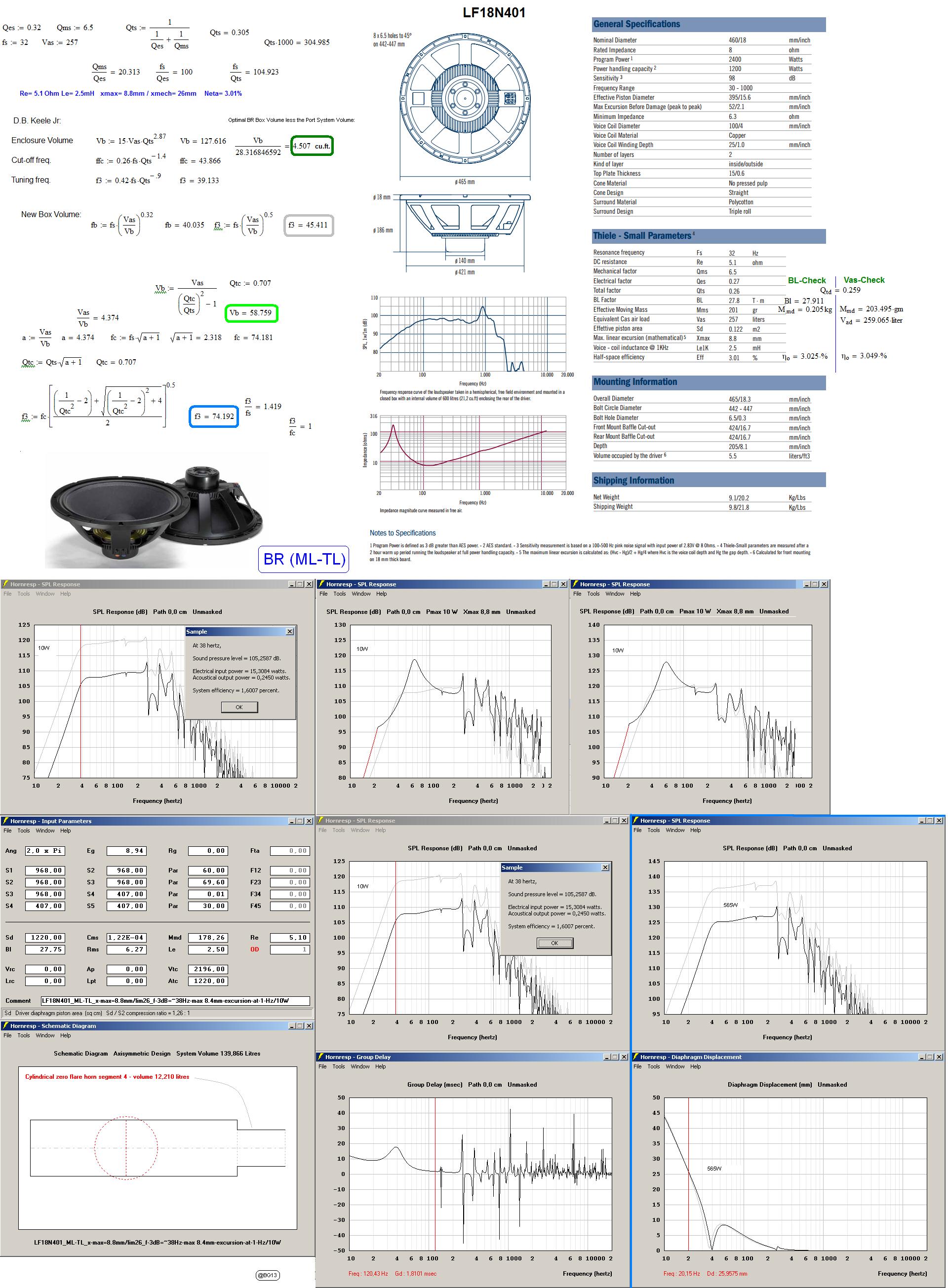

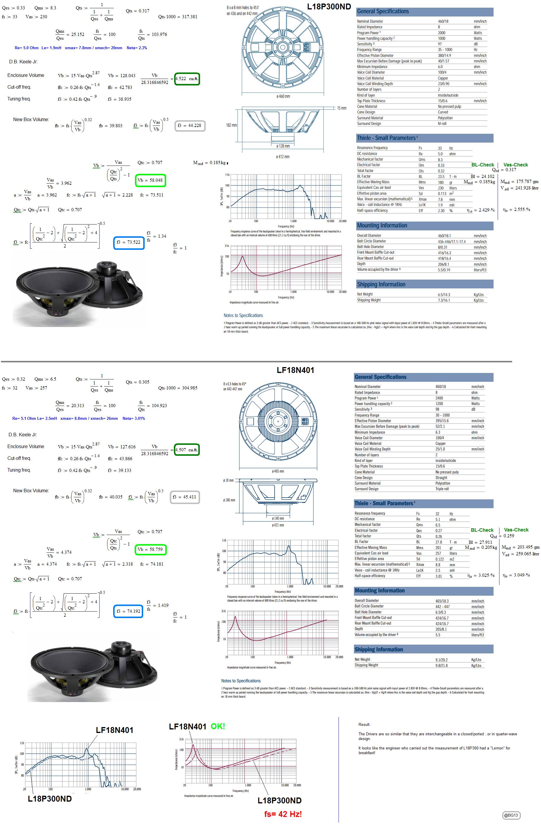

don't know the prices of the rcf woofers, but the bms 18n860/862 is more suitable for ht .
nothing wrong with rcf drivers,but they are more suitable for >30hz .
