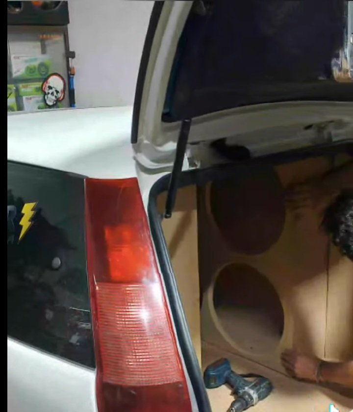

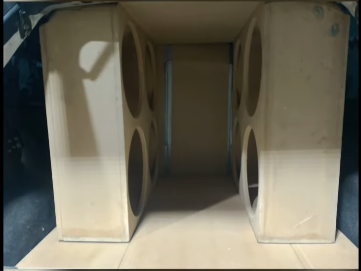

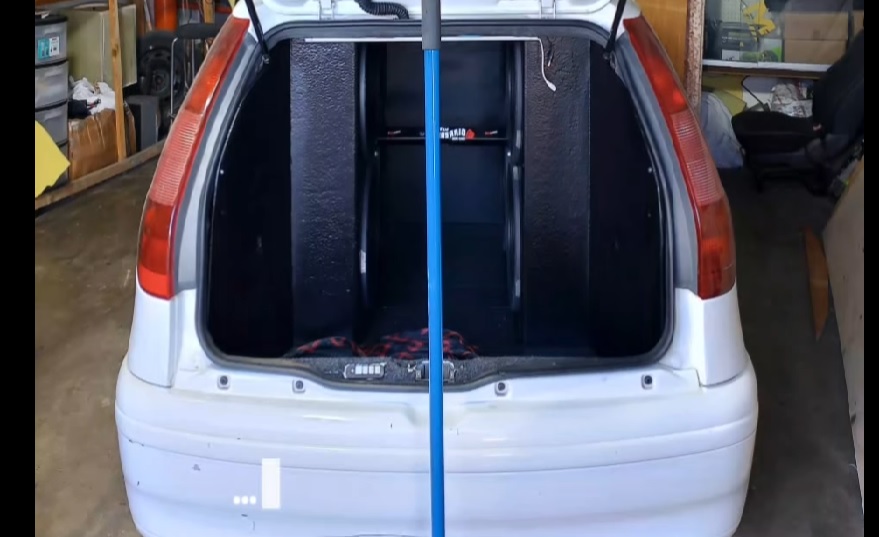

Thank you for your answer. The reason is..... I want to put them in my car. Please don't laugh, but we like to make some kind of rave party playng music with both doors and trunk open, using the car as a portable stage. 4 10's and a big horn with 1.4"compression driver in each door and the 4 rcf's 15's in the trunk pointing outside. As i mentioned we don't listen inside the car, so the main goal is a system that can have a lot of pressure for music like trance, techno, edm, and similar. I saw a man building something similar with 8 15's, i share the photos here under. Please give me your opinion about that and if the rcf's LF15X401 can be a good choice for a thing like that. Thank you in advance.

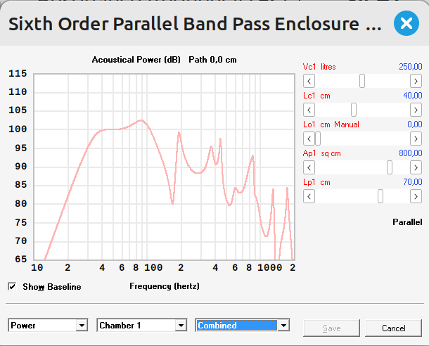

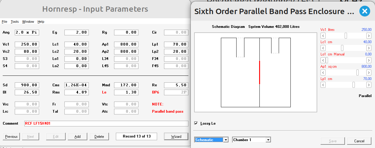

I don't know how big your car is, but these drivers seems to need quite large boxes. Since you asked for a 4th order BP I tested that first, but I believe a 6 th order parallel BP is better suited for your needs. This is a design for two 15 inch drivers, with a focus on a slightly pronounced midbass to suite the style of music you mentioned. Since I don´t know anything about your horn-reflex hybrids, I can not comment on the sound character or any difference between them. I just want to give you a baseline of what can be done with those drivers.
