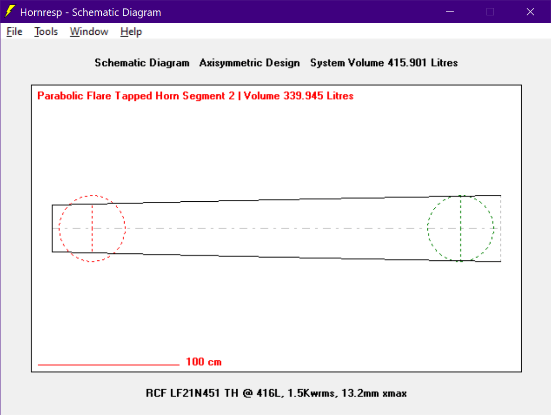

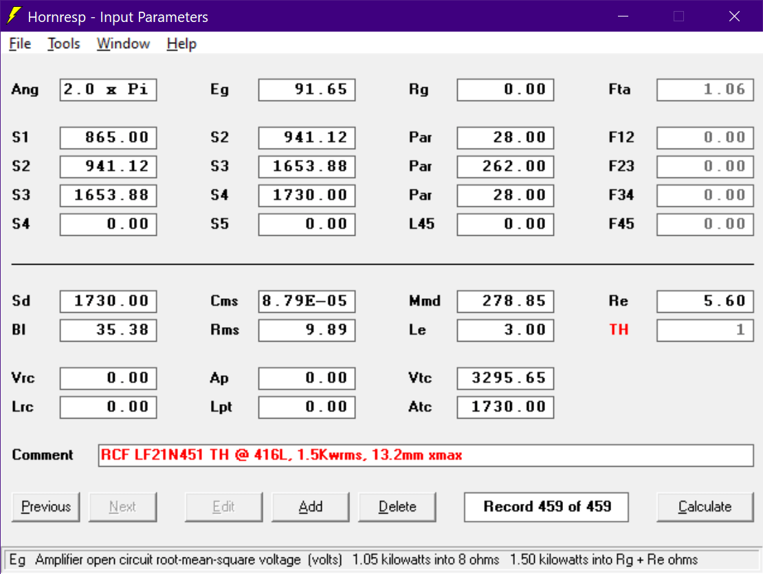

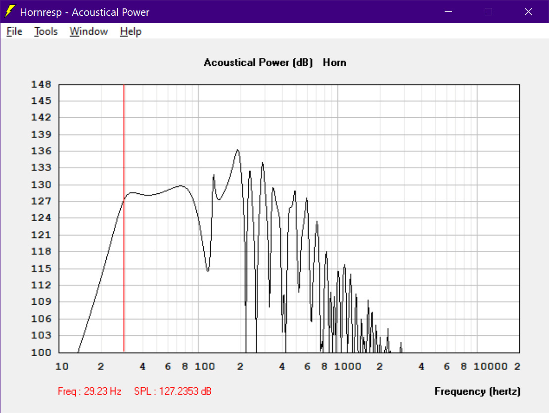

The cabinet in the link has an Fb of 32 Hz, like any bass reflex, not much useful output below Fb. It's large elliptical profile port really does reduce port compression and noise, important to get the most out of such a large displacement driver.
Very good design for size vs extension for PA use, but a larger cabinet tuned lower could get useful output down to 20Hz (or lower) at reduced level, still enough to shake the walls of your house and stomach.
I come from a PA background, but find extension below 30Hz worth the reduced output potential for a fair amount of the music I listen to. If your video games are like a lot of current movies, they may have response well below 20Hz.
Tapped Horn or High Order Quarterwave designs could get even more output down low, but have to be much larger to do so.

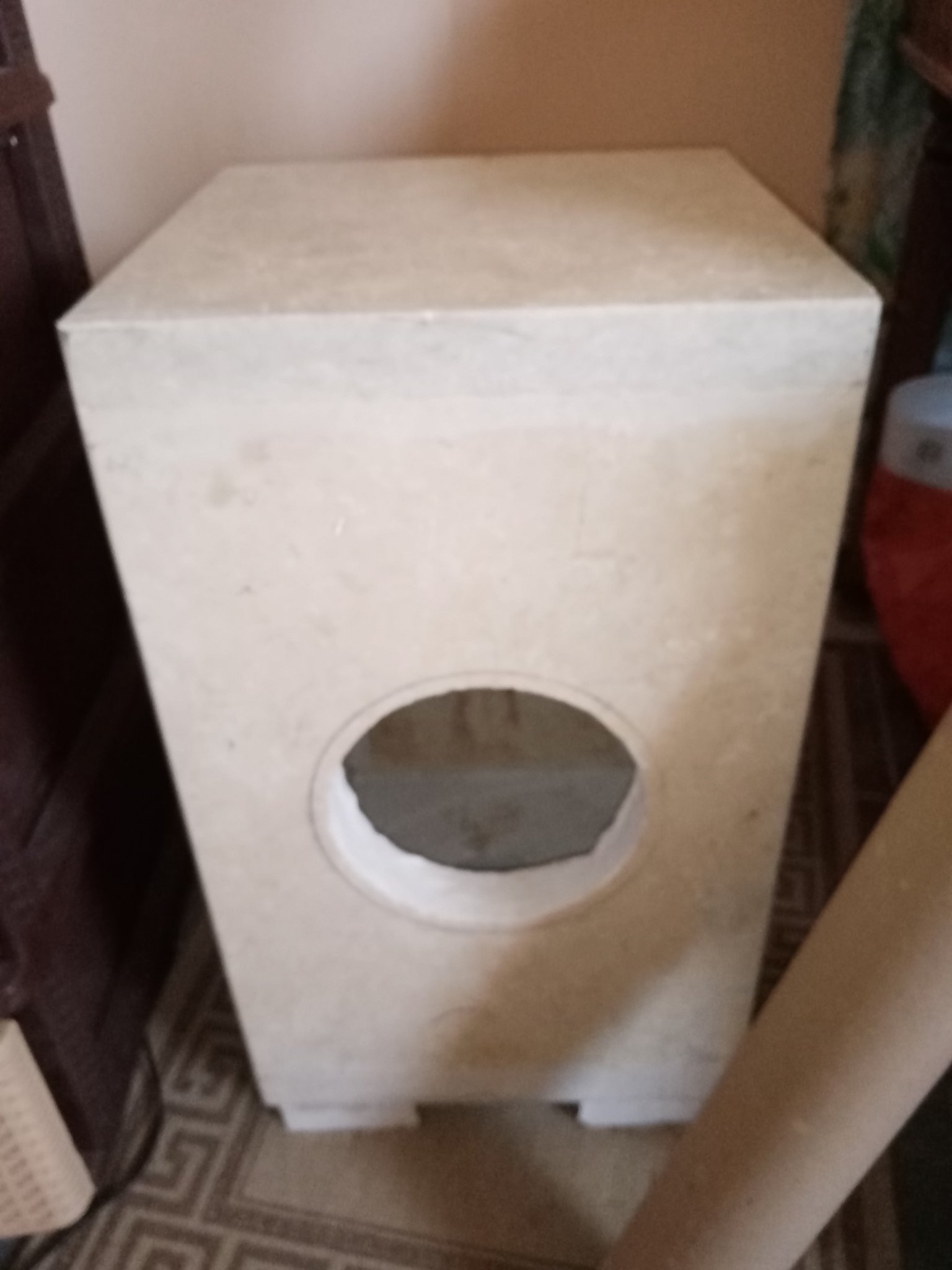

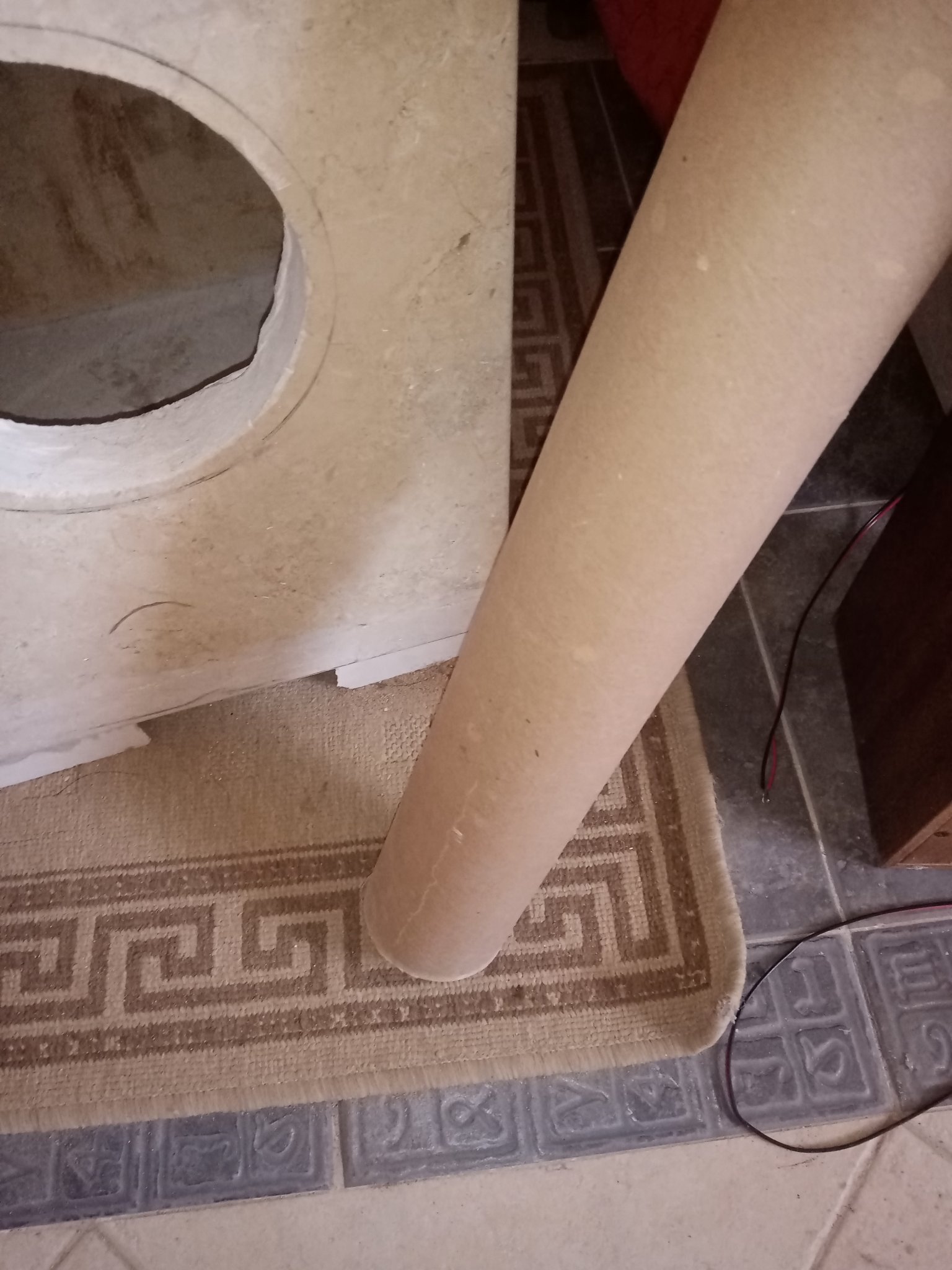

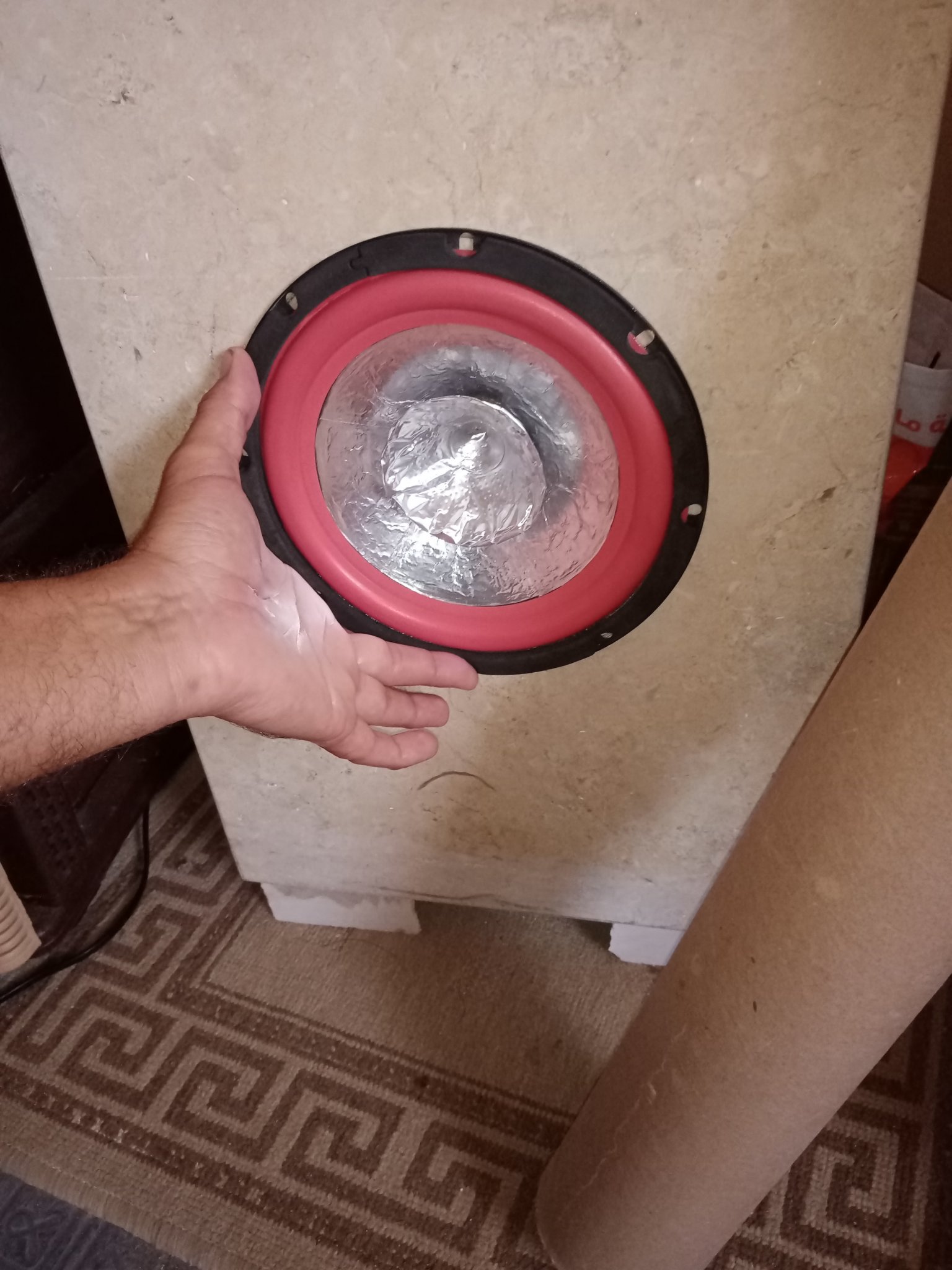

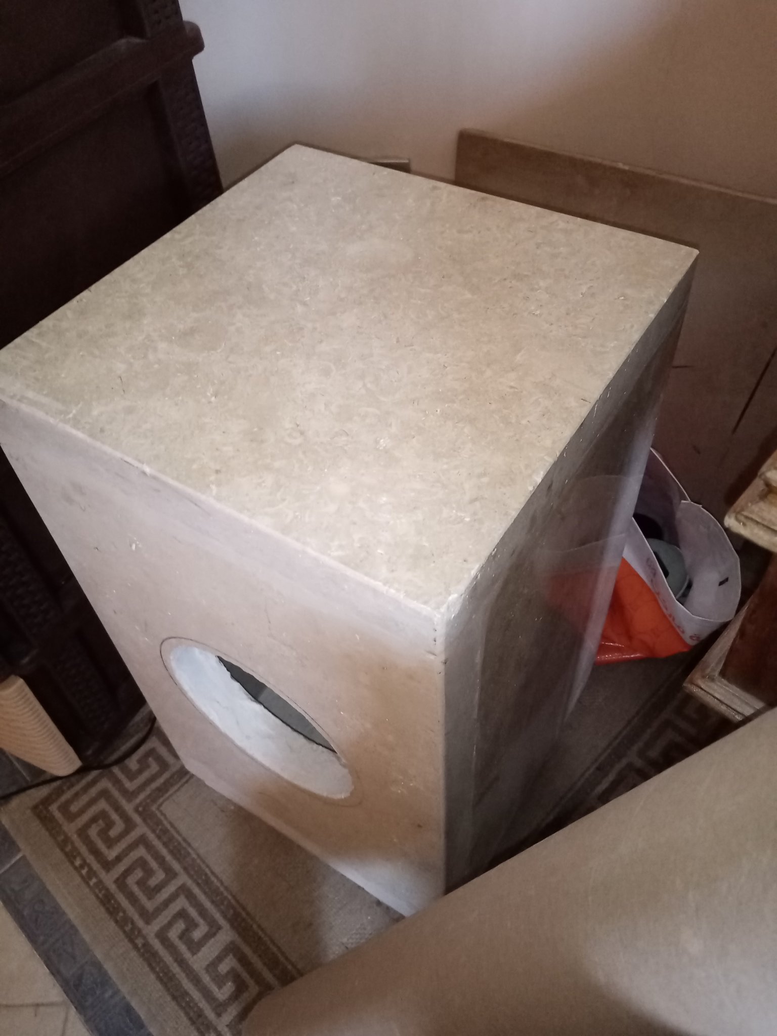

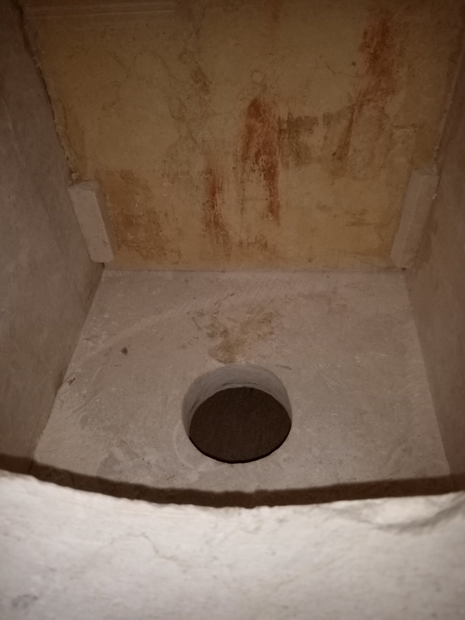

You have space and move into a new house.
If you do not mind you can do a fixed installation with a box out of stone.
You can use bricks for doing that.
I have access to marble which I can get ready made from the stonemason
8cm reflex Port for 8 inch driver will be added
I've heard of people building enclosures out of cement but I've never seen marble before. I think I'm probably going to stick with birch ply for this though haha, I'm not ready for a stone subwoofer box.

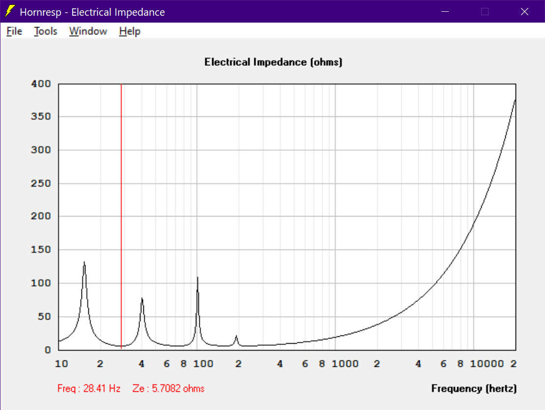

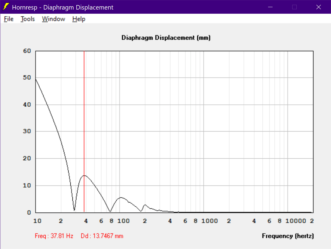

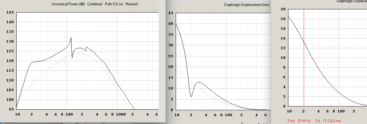

Here is what the output of the RCF LF21N451 in a large sealed cabinet compared to ported 20Hz Fb of the same gross volume looks like:
Using the 13mm Xmax (linear displacement) figure from RCF's spec sheet, the sealed cabinet (regardless of size) can only produce about 107dB SPL at 20 Hz in half space (2.0xPi), while the ported cabinet can do near 120 dB.
At 20Hz, around 5dB increase in SPL sounds twice as loud, the ported output would sound around four times louder than the sealed.

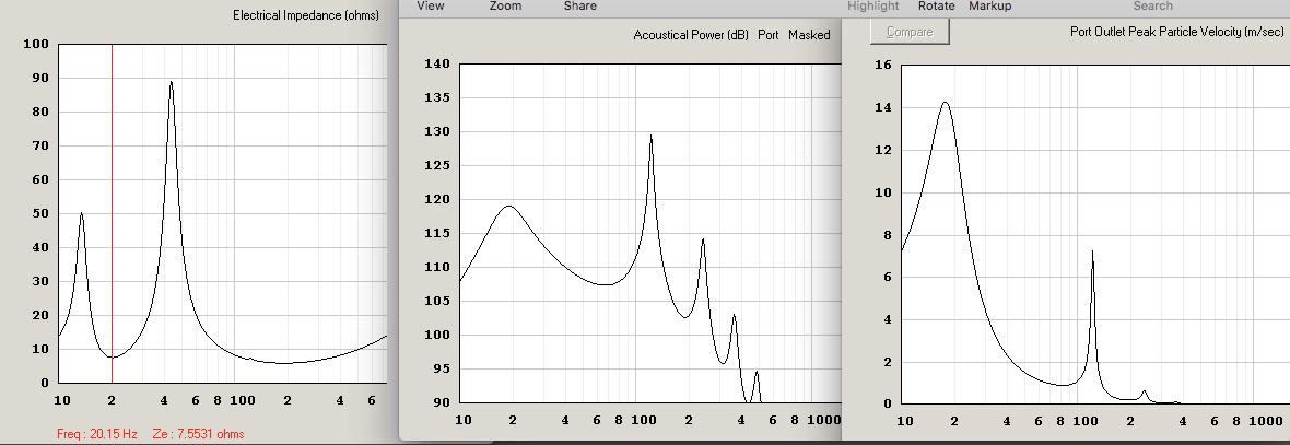

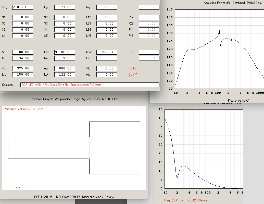

Here is a further look at the 20Hz Fb Hornresp simulation:
The port resonance peak/dip around 125Hz will probably not be as severe as the sim predicts, and as the port may be folded to fit in the cabinet, may be pushed further up out of the sub's pass-band. The rising response can easily be tamed with DSP, and may actually be less, as the voice coil Le of 3mH likely will higher at sub frequencies than the 1kHz specified in the TS parameters.
There is a Hornresp "large voice coil" (or something like that..) function that can be engaged to emulate the effect.
A BW24 HP a few Hz below Fb will keep excursion under control, though the driver's suspension won't allow near as much as predicted.
The large port has low particle velocity, so it won't "chuff" or compress at the voltage required to push the cone to Xmax above and below Fb:
Impedance:Port velocity.png
Using an elliptical port profile would reduce port velocity further, you could probably get away with less port area, which would allow a shorter port length, pushing the port resonance higher.
Anyway, getting a lot of output down low is possible with a driver like you have- go for it!
Art
Reactions: 3 users
