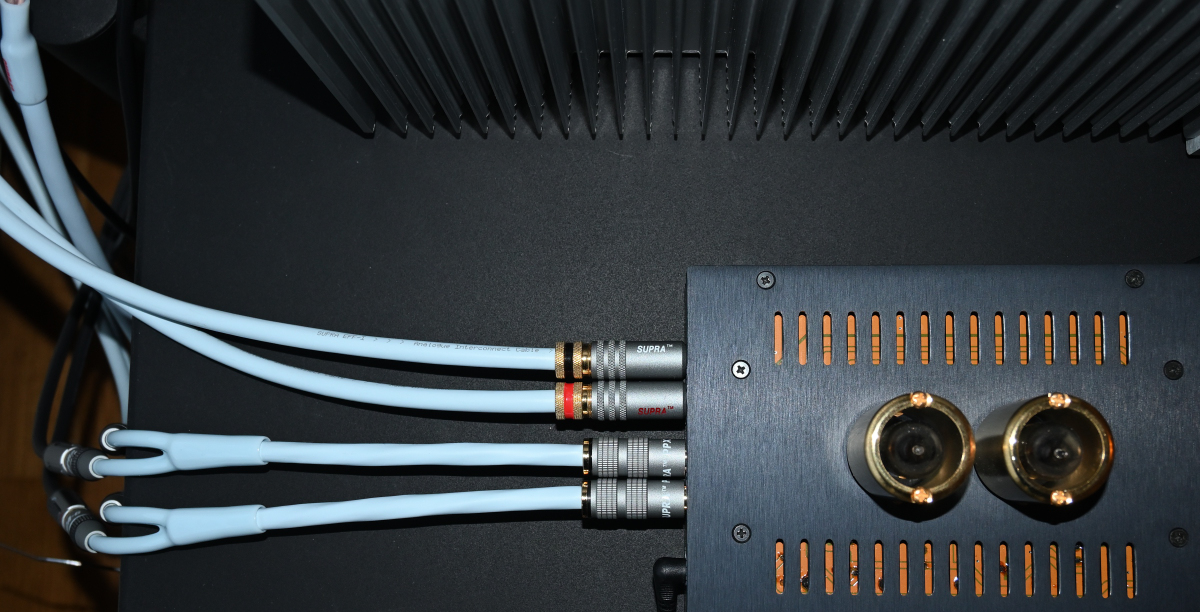

I know that e.g. Supra cables makes a 25 cm Y-fork that has 1 x male to 2 x female. Such an adapter could be used so single cables are connected to the "female fork".

An easy way to try something out is by using two standard subwoofer cables (I now understand your problem with length) and extend one arm of each with a standard Male to Female RCA cable. Always handy to have lying around, and besides the option of buying them they are easy to make yourself.
Yes, it should be easy to make a DIY-version.
With this one standard interconnects can be used:
Y-LINK 1RCA-2RCA M-F BLUE 25CM

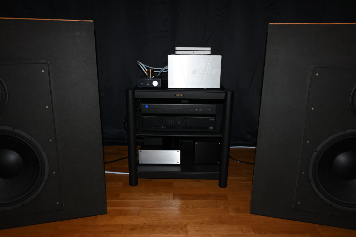

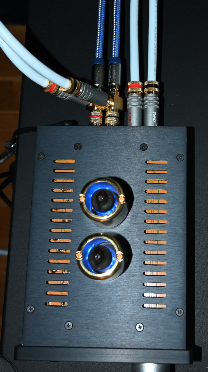

Until I get the Supra Y-cables it look like this (not very elegant) but it works.
It was nice to get the pre-amp back in the system. The STA-1000D amp has 5k input impedance and it seems the DAC has 650 ohm so it had a hard time driving both 1000D and VFET amp. Some distorsion at treble level. Running DAC at fixed level out into preamp made wonders.
The curtain behind is to dampen room resonances a bit. It helps....

The Y-splitters are 25 cm long so additional cables are needed at the "fork-end" to reach the two amps. I had a short 50 cm cable for the bass-amp and use a 75 cm cable for the VFET amp. The output levels out of the splitter are the same. Bass-amp has input level control so level can be adjusted. I did that using a DMM and a sine test tone. I measured voltage out of VFET amp with speaker connected and adjusted bass-amp to same level (via the input level controls).
The SS-II preamp has power mosfets as outputs and can drive a 32 ohm head phone (so it has a lot of "drive power"). However to the RCA out 100 ohm resistors are installed. I wrote a mail to Pete Millett (the designer) and asked if a 5k load was ok. His answer was it should be fine "as-is" but I could lower the 100 ohm to 22 or 10 ohm. I have considered that. Pete like a small resistor to ensure stability in a capacitive load.
It works very well "as is". Before the installation.....if you had very bass heavy music a small low power amp will sound "compressed" at high output level but not now. You get more punch in the low end and it can play "insane" loud without sounding "compressed". I can now enjoy the VFET more as it has optimum working conditions.
