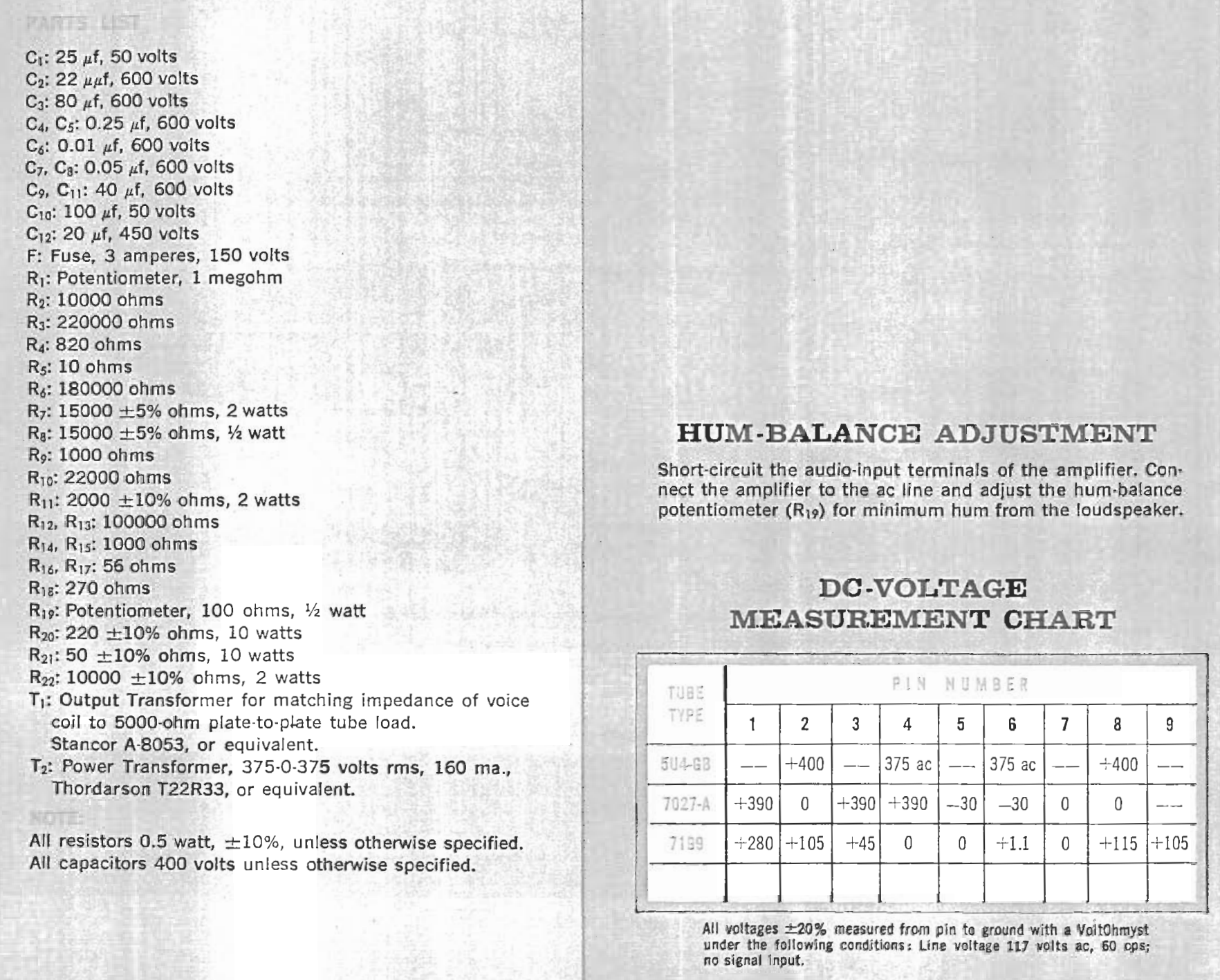

I can not read the schematic and parts list.

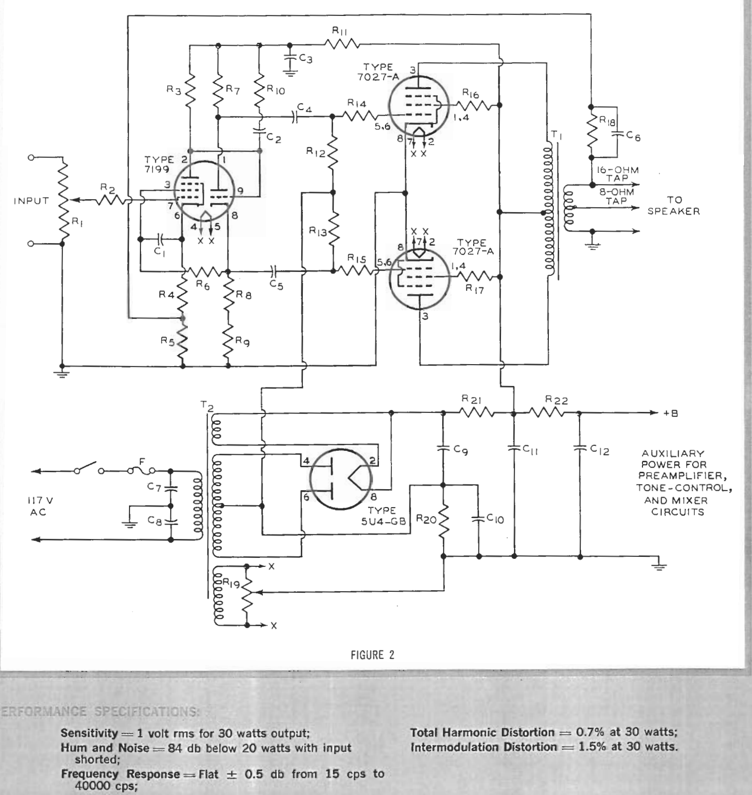

5) The schematic is unreadable for me (can not read the C numbers, values, etc.).
That includes the coupling caps from the 7199 plate to the 7027 g1 grid circuit.
Do not use electrolytic caps for coupling caps.

Note that C10 is incorrectly drawn (reversed polarity) in the above. Also, that these "back biased" power supplies are not optimum for several reasons. Electrolytic power supply caps are easily affordable in the needed voltages these days to avoid the "back biasing". Compromises in output valve individual biasing and driver valves' B+ voltage just aren't worth it.

C10 goes to ground. Why is it incorrectly drawn?Note that C10 is incorrectly drawn (reversed polarity) in the above. Also, that these "back biased" power supplies are not optimum for several reasons. Electrolytic power supply caps are easily affordable in the needed voltages these days to avoid the "back biasing". Compromises in output valve individual biasing and driver valves' B+ voltage just aren't worth it.

Yeah I know but are you really sure that C10 must be installed the "wrong way" round. I thought C10 is a simple series connection of the capacitance with C9 ? (Sorry if it should be a "stupid" question ;-) )Polarity is reversed, curved line is conventionally the negative, matters for electrolytics.
ch
Chris is right. The most negative potential in this circuit is the secondary's CT. C10 is in series with C11 and C12, not with C9.
Best regards!
Best regards!
Oh, oh, I am totally lost now. Can someone please send me a simple sketch how to connect C10 ? Many thanks! BRChris is right. The most negative potential in this circuit is the secondary's CT. C10 is in series with C11 and C12, not with C9.

got it!Oh, oh, I am totally lost now. Can someone please send me a simple sketch how to connect C10 ? Many thanks! BR

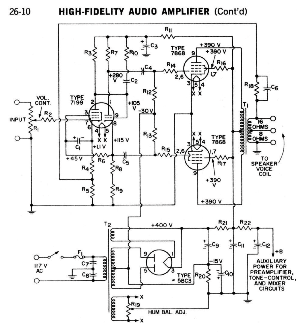

in a maybe later rca design (using 7868 tubes instead of 7027-A) the schematic looks correct here at c10 .
R20 and C10 provide a positive voltage to raise the filament voltages.
The 7199 triode's cathode is very positive.
7199's filament to cathode insulation breaks down with large DC voltage, plus the positive swing with signal.
That insulation breakdown becomes a resistance that is in parallel with the triode's cathode signal load of R8, R9, and R6. Those resistances are the effective cathode resistor of the 7199 concertina phase splitter; as a result the triode plate outputs more signal than the cathode outputs (un-balanced concertina output).
So, the voltage across R20 raises the DC potential to prevent that.

I don't think RCA Engineers were so stupid to ignore this situation. Moreover when published in their own manuals.

R20 drops 30V. Instead of using that circuit to raise the filament voltages, use a 2 resistor divider (and bypass cap, C10) off of B+, to get +30V to raise the filament voltage above ground. With R20 out of the circuit (removed and replaced with a jumper wire), we gain 30V of B+ (added 30V to the B+).
And, with the resistor divider off of B+, we have also just 'created' a B+ bleeder resistor.
The original circuit does not have a bleeder resistor.
Use bleeder resistors: Prevent the "Surviving Spouse Syndrome"
Add individual self bias resistors and individual bypass caps.
Now, the voltage drop of the added individual self bias resistors (with that voltage drop) it takes away from the plate & screen voltages to the cathode voltage; but is made up for by the extra 30V of B+.
Or, just keep the original circuit, and get your extremely well matched 6L6GC from eurotubes.com.
The RCA engineers were Very Smart. They included the circuit to raise the filament voltages.
But, as Smart as Dyna was, the Dyna Stereo 70 did not raise the 7199 filament voltage (not smart!).
The filament to cathode insulation degraded over time; I once took a 7199 out of its socket, and measured 100k Ohms between the filament pins to the triode cathode pin; talk about a very un-balanced concertina!
The result . . . lower power out, and higher 2nd order distortion.
