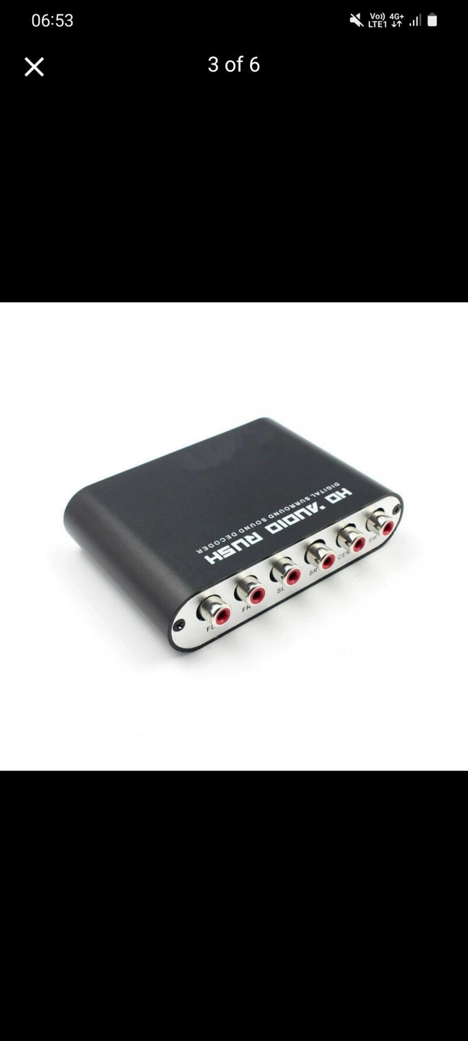

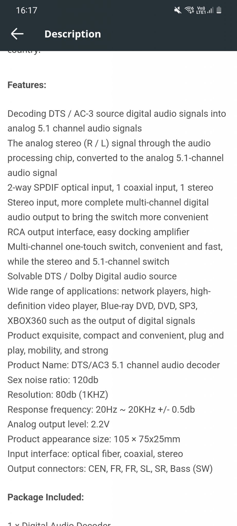

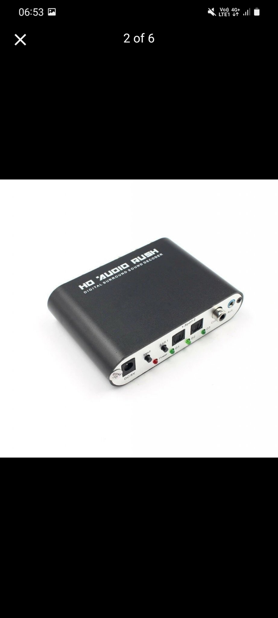

Ok.
You don´t actually need one; control volume from your decoder or any signal source you use to drive those subwoofers .
Don't think it has a volume control for the individual outputs. It's one of these in the images.
Ok, no physical volume potentiometer for any of the outputs, but don´t you have one built in the software?
I think you should, please check that.
In any case, IF you want to add a volume pot to your 1>8 passive splitter box, you will need to add a buffer.
Decoder box (of which you should have posted brand - name - specs or link to user manual from day 1 if you want good answers) can probably (I must guess because you did not supply any data) drive 8 subwoofers, it "should" be able to drive a 2k or higher load , but f you introduce a passive pot in the equation it does not work any more, hence the need for a buffer.
Basic connection would be IN RCA > Buffer board > 8 x RCA Out.
Can you build a small PCB with, say, 10 components?
You will also need to feed that buffer with some kind of supply.
What do you use to feed the decoder?
Any technical answer requires data.
