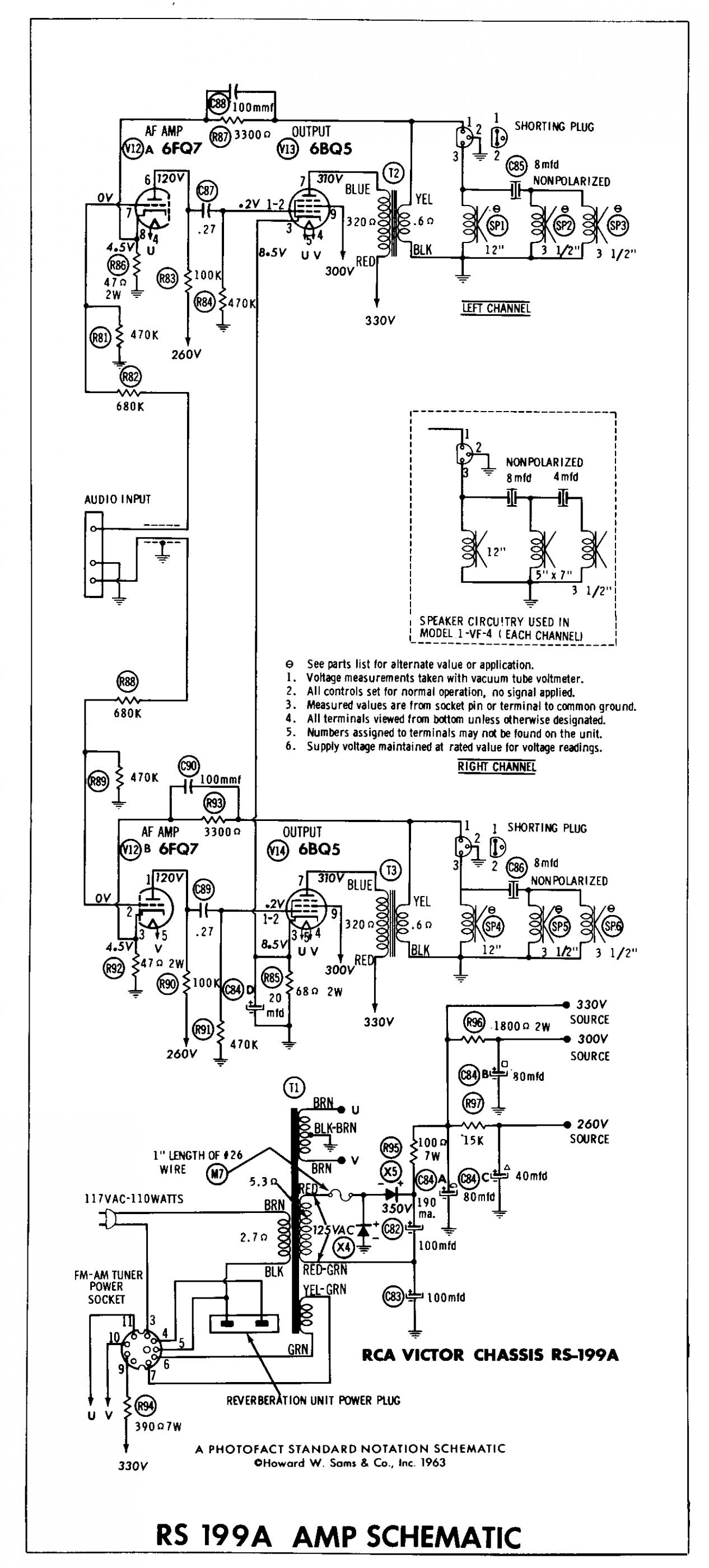

Weird thing is, I looked up the RS199A schematic, and it seems like maybe there was a mistake made in the RS199B? The 47 ohm resistor is the cathode resistor, with the 3.3k/100pf NFB resistor going right to the cathode. Does not sound good this way either 🙁

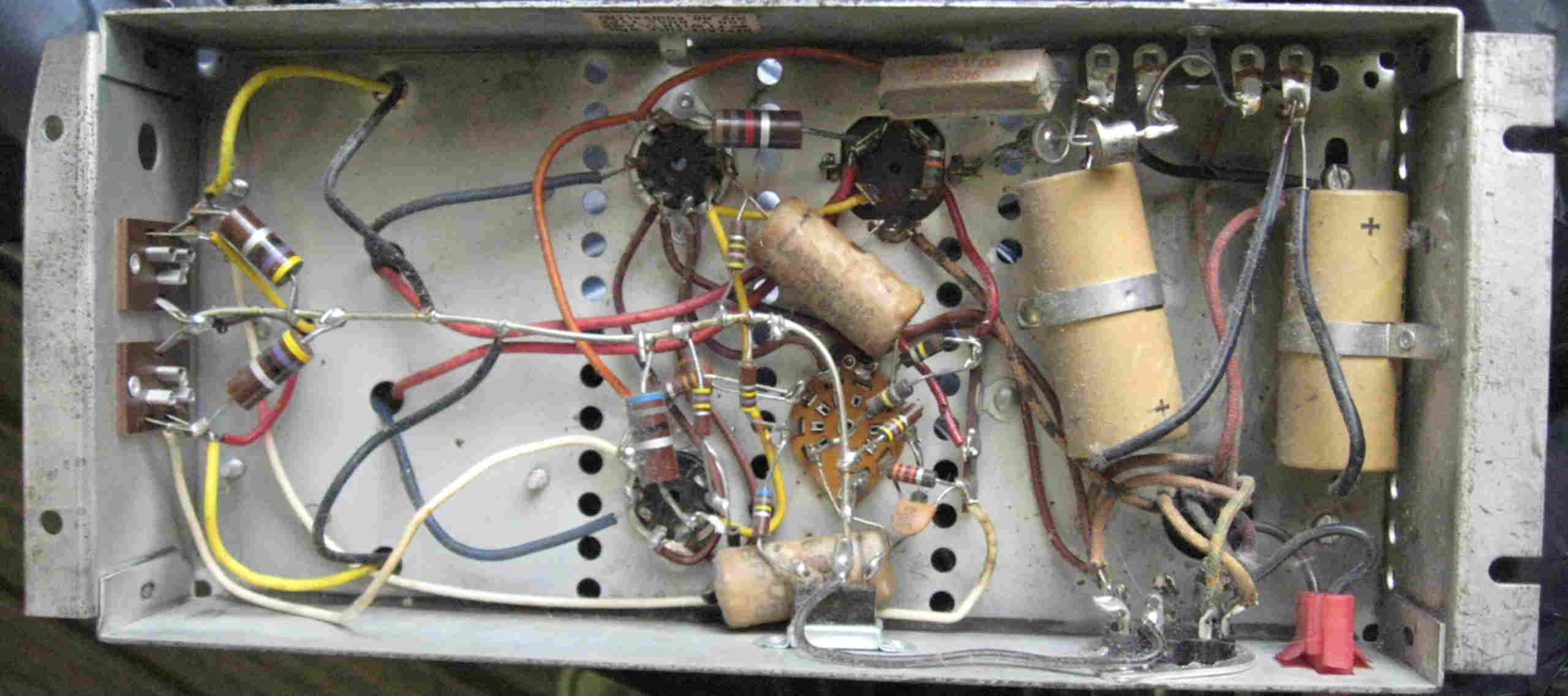

one more fwiw
I'm not him but here's mine--no clue what's orig/not (haven't even looked at it yet). Guy I got it from had it running and it came well-regarded with the same surprise.

RS-199A Schematic?
I know this is a super old thread, but I just picked up a buddy's old RCA Victor 1VF-324A radio/turn table. It's not outputting any sound and I was looking for the schematic for the RS-199A amplifier. I noticed everyone has posted the RS-199B but someone said they found the RS-199A. I can't find the A version ANYWHERE. Does someone have it?
