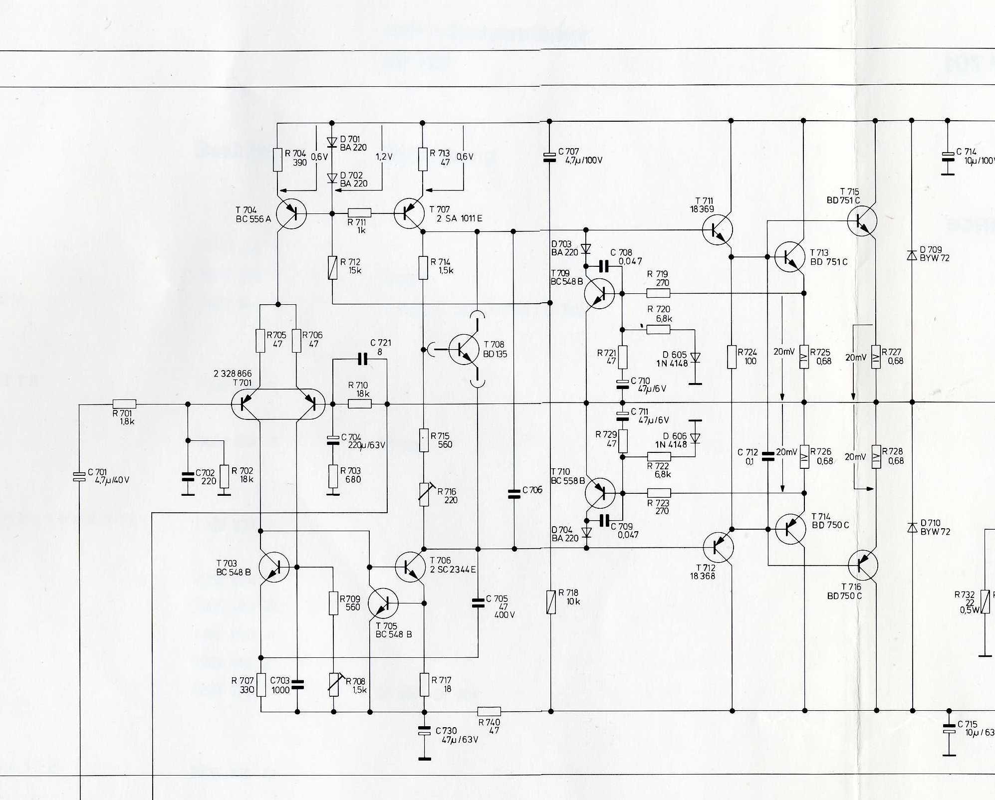

I recall, that I have had RCA Datasheets/application notes from the German Distributor Alfred Neye ENAtechnik in Quickborn. Unfortunately I don't find this sheets sine a long time.
Here the exactly naming of this papers:
1) "Power Transistors BD750, BD751 Series"
RCA File Number 1251
Titel: "Silicon Transistors for 80- and 100-W Full-Complementary-Symmetry Audio Amplifiers" (Printed in USA/11-80)
2) "Power Transistors BD550, BD550A, BD550B",
RCA File Number 1109
Titel: "Silicon Transistors for 70-, 120-, 200- and 300-W Quasi-Complementary-Symmetry Audio Amplifiers" (8.78/AT3679-10.78)
I don't know, whether the term 10.78 and 11-80 means the date of release, but it is not excluded.
Who can post this papers ??
Thank you for your efforts in advance.
In the attached files you will find a schematic, where this types are in use.

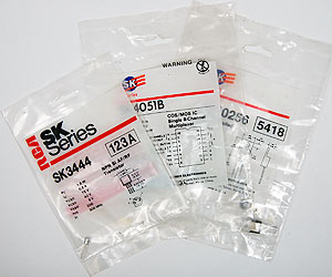

Don't have any RCA app notes but since I dug through the attic for you, you can read this & throw it away. 1986 RCA SK book shows BD550/a/b as SK9031. BD750/a/b is SK9033. These are NPN TO3 BJT, PNP complements 1 digit higher. SK9033 suffixed as 60, SK9034 suffixed as 61, and I own some NTE60's installed an 80V rail quasi comp amp. SK9031 Pt 150w, Ic 20a (9032 is 16a) Bvceo 160, typ hfe 20, typ Vcesat 2v@5a, Ft 2 mhz. SK9033 250 watt, 20A, Vceo 140v, typ hfe 75, Vcesat 2v@5a Ft 2mhz.
Parts seem to be a bit tougher than a 2n3055.
For those that don't know NTE started as a copy of the RCA SK and similar GE replacement part lines, using primarily imported parts. NTE is the only survivor of this marketing program. RCA & GE gave away the catalogs, NTE made the sale without having to hire any expensive salemen. The part numbers were the same except for the prefix.
