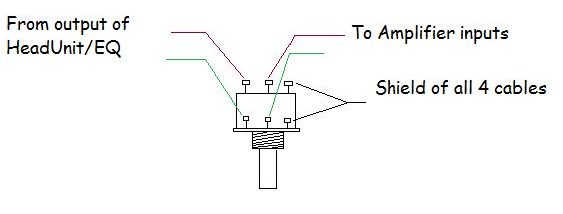

If there is a Radio Shack store in your country the following is a 100K stereo potentiometer that works great for what you are wanting to do. Part Number is 271-1732 Click here Following is a diagram. I have mounted these in removable dash panels with no shielding whatsoever and have never had a noise issue with it.
