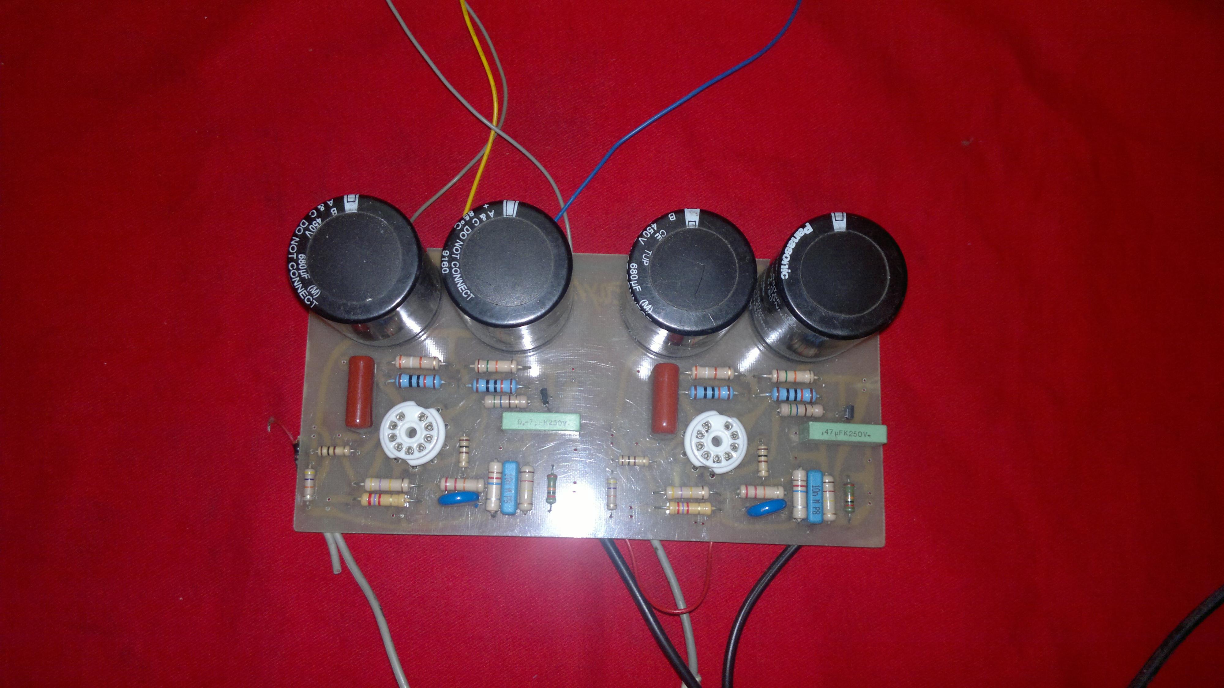

Here's a pic of the board, before installation. Currently using Tung-sol 12ax7 new issues. The Sovtek 12ax7WA's were very sterile sounding, and a little noisy.
Not at all surprising, as that variant has a very unsavory reputation. OTOH, the Sovtek 12AX7LPS has been consistently satisfactory.

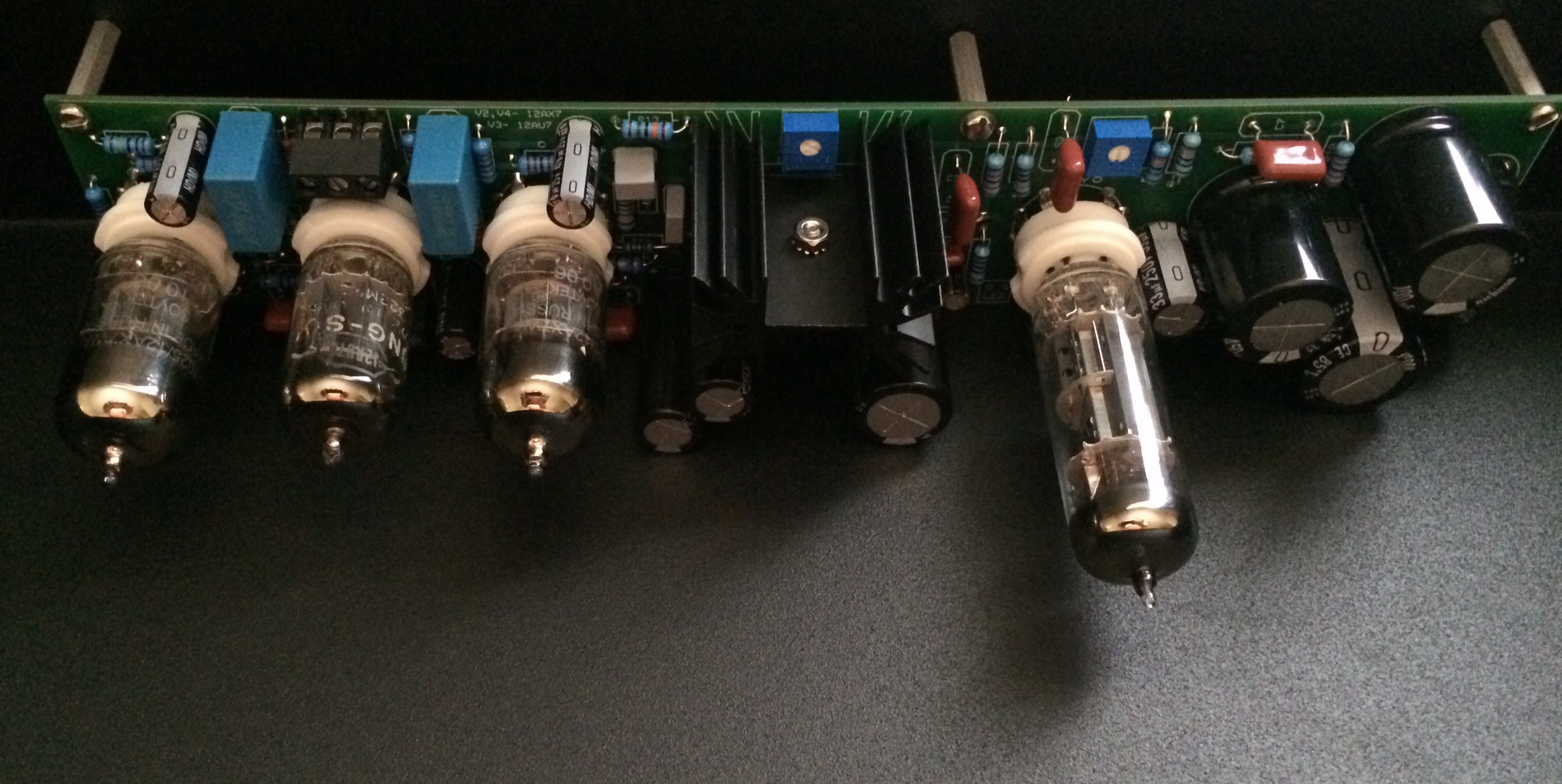

I have built this hybrid RIAA stage with the tweaks shown, and used Eli's idea of regulated B+ and also regulate 12V heater supply. The result is great with Sovtek 12AX7-LPS tubes, and also the new Mullard resissue long plate tubes.
I had some hum that required being sure the two regulated supplies' 0 volts were tied together at the first cap in the B+ suppy and the heater supply, along with a star connection to the 0 Volt rail of the preamp circuit. There is very little "hiss" or other noise.
I have fed this into amps using both 10K and 100K input impedances, and they are sound very good, from deep bass to the top end.

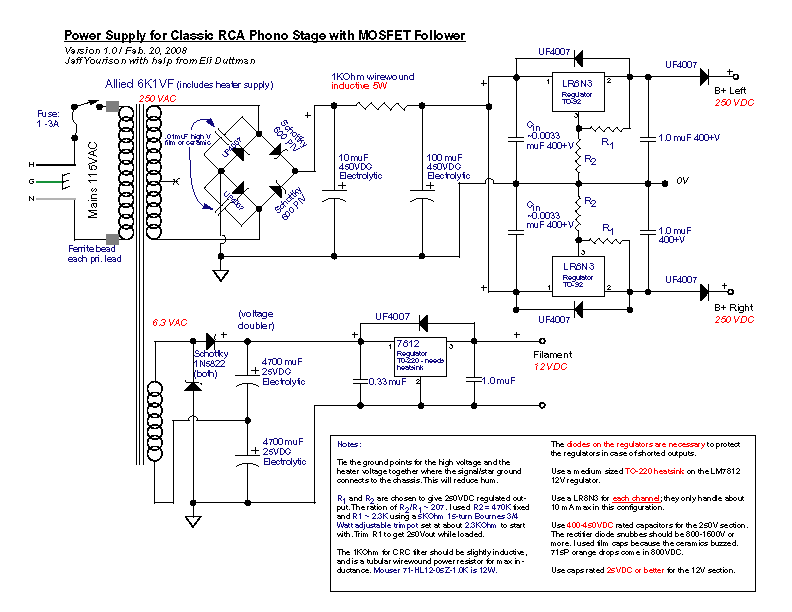

Here is the power supply I used with this phonostage:
Rather beautiful!Here's a pic of the board, before installation. Currently using Tung-sol 12ax7 new issues. The Sovtek 12ax7WA's were very sterile sounding, and a little noisy.
I did a prototype , it really sillent even i didnt use any regulator.

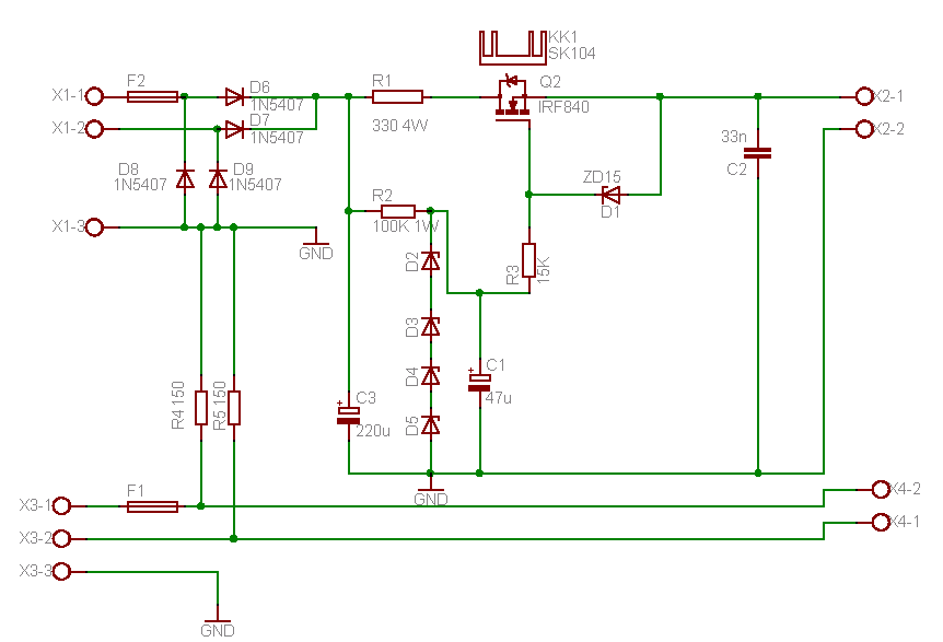

I coudnt find a chance to perform it without mosfet but i will, nowadays im intented to do a regulator. One example was posted by Jeff Yourison , it looks pretty good but im not sure about the power performance, the datasheet of the regulater tells that the max current is no more than 30ma.
Can you tell me about its performanca Jeff, is tere any heat on the regulator.
There is something in my mind i wanna do the regulator i post here, it looks more powerfull but meanwile i tried to do the one Jeff posted. ( sorry i coudnt find the source of the psu but im sure i found it from a German site). Any one do that regulator? please give me your thougths.
Thank you

Huseying,
Because I am using a regulator for each channel of B+, there is little excess heat at all. The current draw of the 12AX7s is very low. I have small "hat" style heat sinks in place. Same for the heater regulator, using that power transformer. With the 6.3V doubler, regulating to 12VDC doesn't use up much extra voltage. I do have a heat sink on the LM7812, but it barely feels warm. The ZVN0545A follower has no sink -- none needed.
Thank you Jeff
It seem to me that LR8n3 has better noise ratio, i thin it gives more clean voltage than the one i post , i never search the LR8n3 before , i hope i can find it in my electronic shop.
