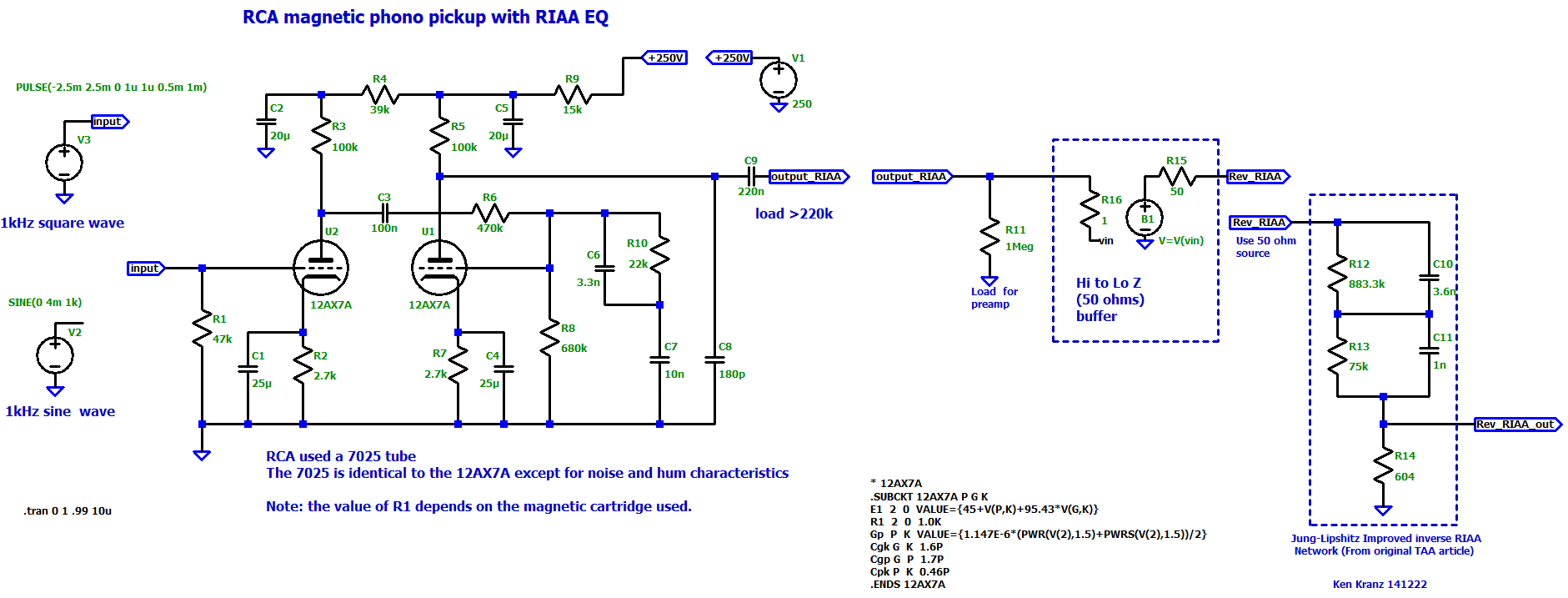

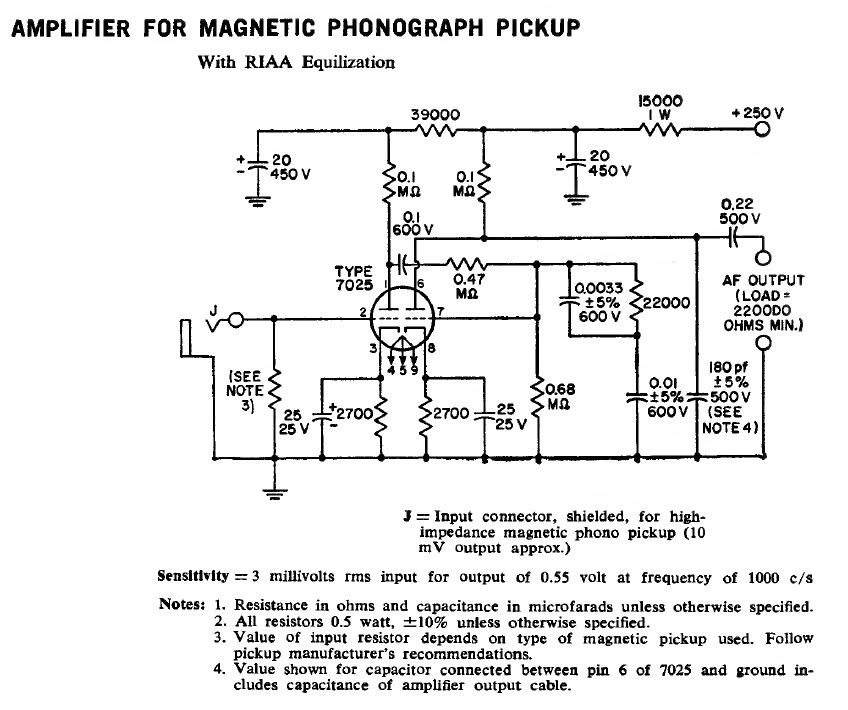

I have created a spice simulation using the RIAA phono preamp from the RCA tube manual.
Included is reverse RIAA network, the Jung-Lipshitz Improved inverse RIAA
Network (From original TAA article).

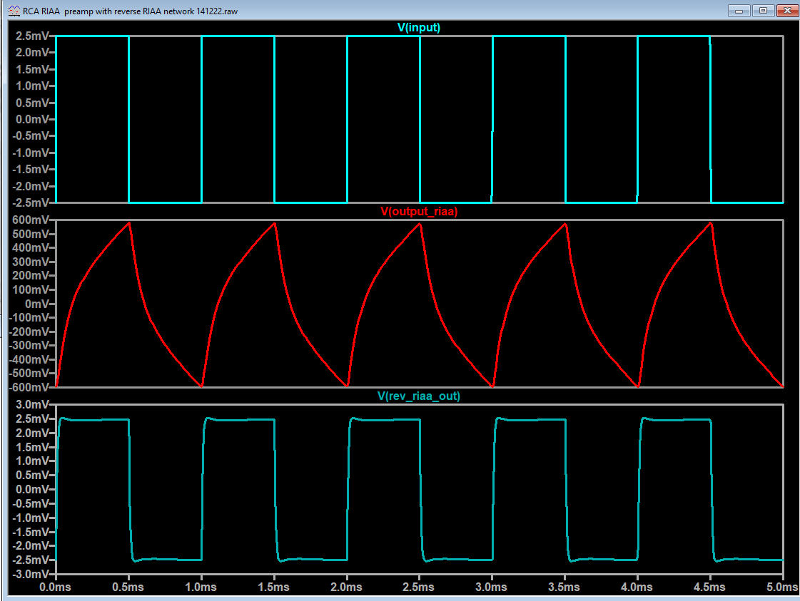

Two signal generators or on the sim a 1kHz sine wave and a 1kHz square wave.
The waveforms show a square wave fed into the preamp, the output of the RIAA and the restored
square wave out of the inverse network.
I'm certain a better spice model for the tube could be used.
Please feel free to improve on this work and repost.
The original RCA component designators were used.

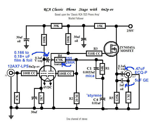

Eli Duttman would suggest a mosfet follower to buffer the load of the volume control.
Hi Rayma thank you for your reply.
As you suggested using something to lower the output impedance would be required in most applications.
My aim was to simulate the RCA circuit as it was originally produced by RCA as a tribute to them.
The Inverse RIAA network and buffer in the spice simulation are of special interest as they can be used with any RIAA preamp to test for compliance with RIAA equalization. In the days before all the sophisticated equipment we now have, all that was required to test a preamp was a suitable square wave generator. a reverse RIAA network and an oscilloscope. I used to have a reverse RIAA network about and should make a new one, very handy if designing or building RIAA preamps.

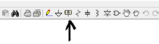

Tubekwk: Reading your interesting post I noticed in the LTspice schematic the use of labels like "output RIAA" and" ref RIAA".
Never used this kind of labeling in LTspice and I am interested how to do this in the way you are doing this.
Is it possible to publish your .asc circuit diagram here?
Thanks in advance,
Joe.
Hi Joe
The .asc file was uploaded with the images, if you have trouble downloading it I will re upload it.
Go to the net name icon at the top of LTspice it is a capital A in a rectangle icon.
If you give a name to a node it will automatically link to wherever you place a copy.
It automatically names any "oscilloscope" traces with the node name. No spaces are allowed in node names so I use an under score.
I will reattach the **.asc file here.
BTW you may need to change the font size.
Ken K
Wow, no sorry.. big WOW !! @Tubewkw
I have a simple diy ecc83 phono amp sounding smooth and (too) meaty which output is noisy..
I was looking into the RCA material and its variations (including Eli Duttman's of course) to improve it.. lots of food for thoughts here, and getting going noobs with Spice simulation is a very big plus, thanks a lot for posting this!
Thanks in advance,
Joe.
Thank you very much Tubekwk, much appreciated!
And I have to confess that, although I also use the "label" in my LTspice schematings, after years of use I never noticed that you also can define its "Port Type" !! :ashamed:
I simply put a name in the box and then connect it to a node.

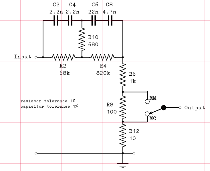

I myself are using a slightly modified inverse RIAA network, the one which Merlin Blencowe published in his book "Designing High-Fidelity Tube Preamps".
Which is on page 344/345 of that book. This because you do not have to use then rare capacitor values. I do not give that circuit diagram because I do not want to violate
copyrights. So first I have to pm MB for his O.K.
