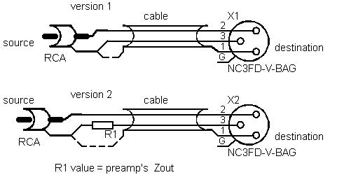

Brian Donaldson said:Now let's solder up the XLR as it shoud be on one end and the pos wire to the center of the RCA and the neg and shield to the outer conductor on the other.
Any thoughts?
you are on the right track.
I'm often using the wiring diagram as shown in the picture below.
Steve Eddy said:Even the slightest imbalance at the source can dramatically reduce the input's common-mode rejection.
Any link with measurements?
Milan
