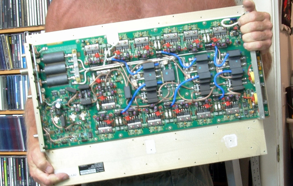

The older MRI amplifiers ran MFR150 transistors and put out up to 2 KW on 13.56 MHz. Many of the amps were broadband enough to cover 40 through 10. Each MRF150 can make up to 150 watts and there were circuits and PCB's all over the web running from one to 4 of them. These amps were being replaced by newer amps 5 to 10 years ago and pullouts could be found cheap. I grabbed several at the Dayton hamfest over the years for $50 each or less. Some had as many as 24 transistors on them.

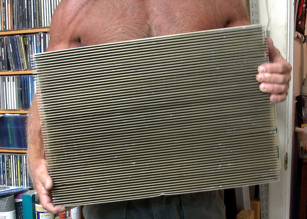

I picked up one of the newer versions a few years ago. It was dead, but cheap. I mined it for the parts, then resold the heat sink to a class A audio guy for more than I paid for the dead amp. Picture shows the new amp before disassembly. I think it was a 5KW amp.

There's a fellow in eastern europe that makes all the bits less the semiconductors to make a nice linear. Even has bandswitching filters to keep the neighbors happy. Aftermarket legal limit SS amps range from 7 to 10 thousand dollars. A little out of my league.
