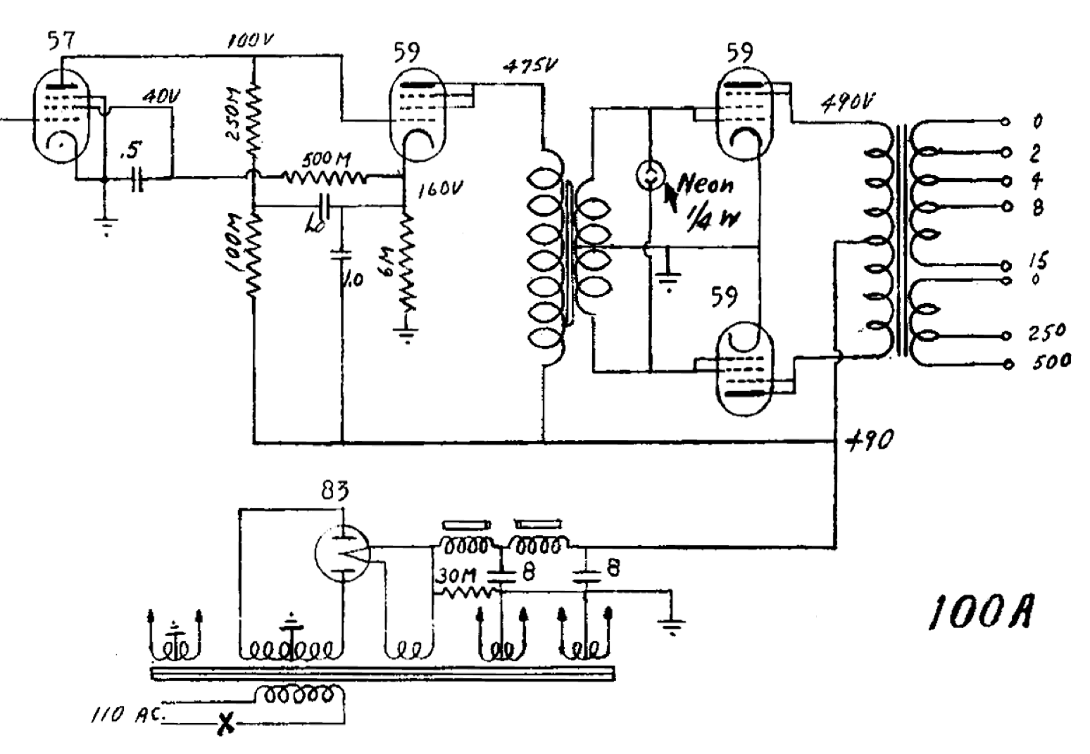

It would seem that the 59 uses zero voltage bias; this is the 100a from Lafayette
It would appear that the symbol M means k Ohms.

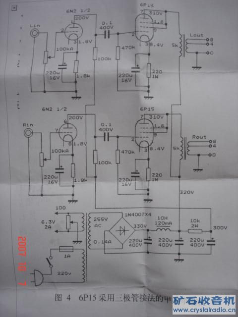

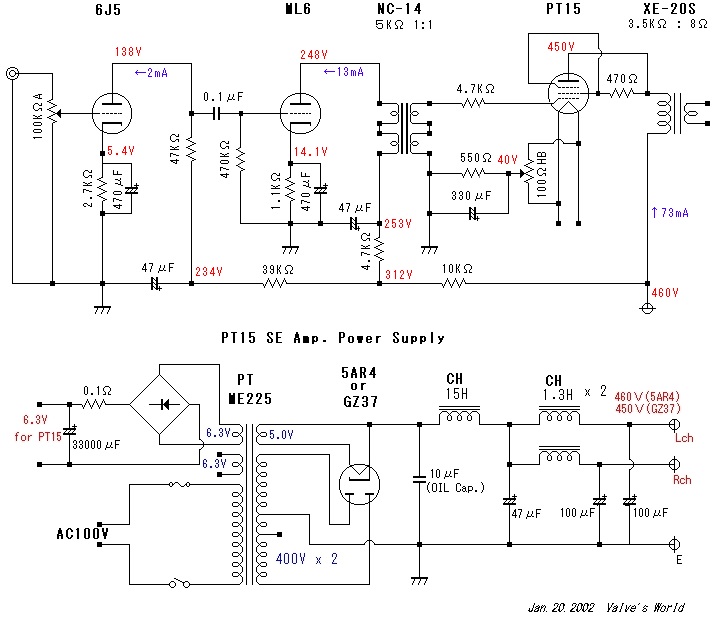

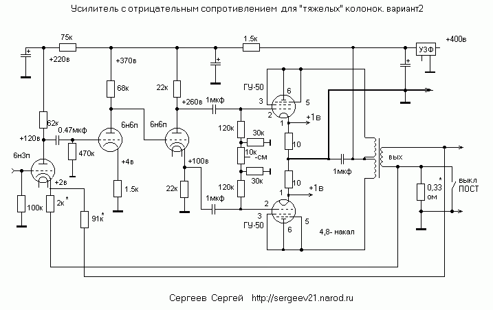

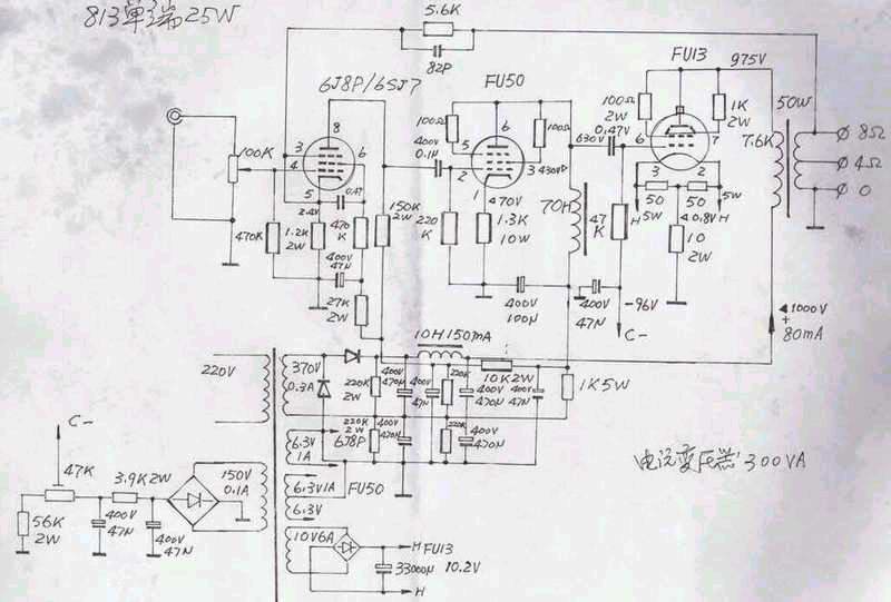

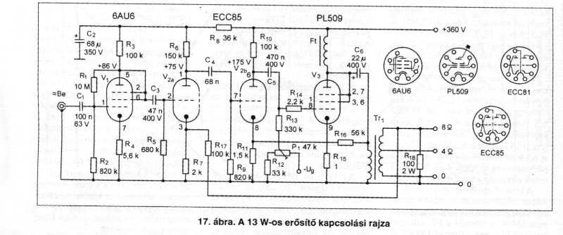

I have 22 schematics (including the Randall you mentioned, and only counting output stages) where the supressor grid or the beam forming plates and the screen grid are tied to the plate. Here are 8 of them (I use the term 'supertriode' in my database of schematics for the situation that both the screen grid and the suppressor/beam plates are tied to the plate):
6AU6 supertriode + ECC85 + PL509 supertriode parafeed se.jpg53.6 KB · Views: 191

6J5 + ML6 transformer-coupled + PT15 supertriode se + 5AR4.jpg105.4 KB · Views: 139
