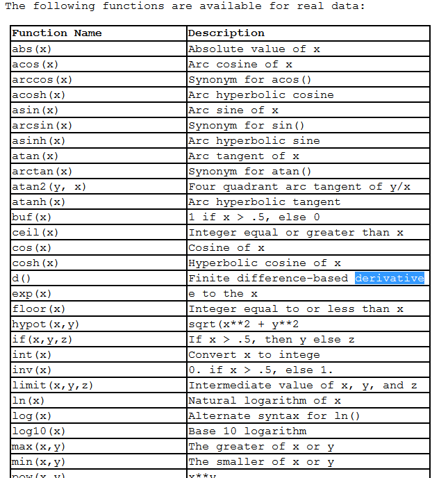

Oscillatory ringing occurs when the flyback voltage (L x dI/dt) exceeds the diode's Vfwd. Obviously the choice of diode doesn't affect L, but it does affect dI/dt and Vfwd.
Since your simulations have shown big differences in the oscillatory behavior of 1N diodes versus UF diodes, why don't you run those same simulations and this time plot the diodes' dI/dt? Maybe diodes with big dI/dt also oscillate big? It's a worthwhile hypothesis to explore.
In LTSPICE the Waveform Arithmetic function to take the derivative is d( ) ; see image below. Thus to view dI/dt in diode D6 you would plot the expression "d(I(D6))" . I assume other simulators offer similar features.
I think you will be shocked and delighted to compare the dI/dt of your 1N4007 circuit, versus the dI/dt of your UF4007 circuit. One will have (kiloamperes per second) of dI/dt, and the other will have (megaamperes per second) of dI/dt. Really.

So, why a faster diode could lead to a lower dI/dt? You mentioned Vfwd, so you mean that until Vfwd reaches 0, it has become momentary lower that L(dI/dt), so we have ringing? So for a fast diode, this would happen so fast, that it could barely be "detected"?
And if so, what is the relevance of Blencowe's point about reverse conduction during transition time? Still a bit confused on that one. 🙁
That alone should call into question the simulation, while it is possible to coax high dI/dt's out of diodes in reverse recovery, some attention needs to be paid to reducing inductance and maximising dV/dt.
There is not enough voltage available at the point of recovery to produce that sort of dI/dt with the inductances present in this type of circuit.
Even if the diode switched at the zero crossing, the dV/dt would be just over 0.005V/us for a 1us switching delay that is 5mV over voltage, to achieve 1A/us dI/dt would need an inductance of 5nH. The diode is not switching at zero crossing so the dV/dt will be less. In a real life application a fast recovery diode will see dV/dt's of tens of volts per microsecond, yet we do not see the associated kA/us dI/dt's that this simulation would suggest.
