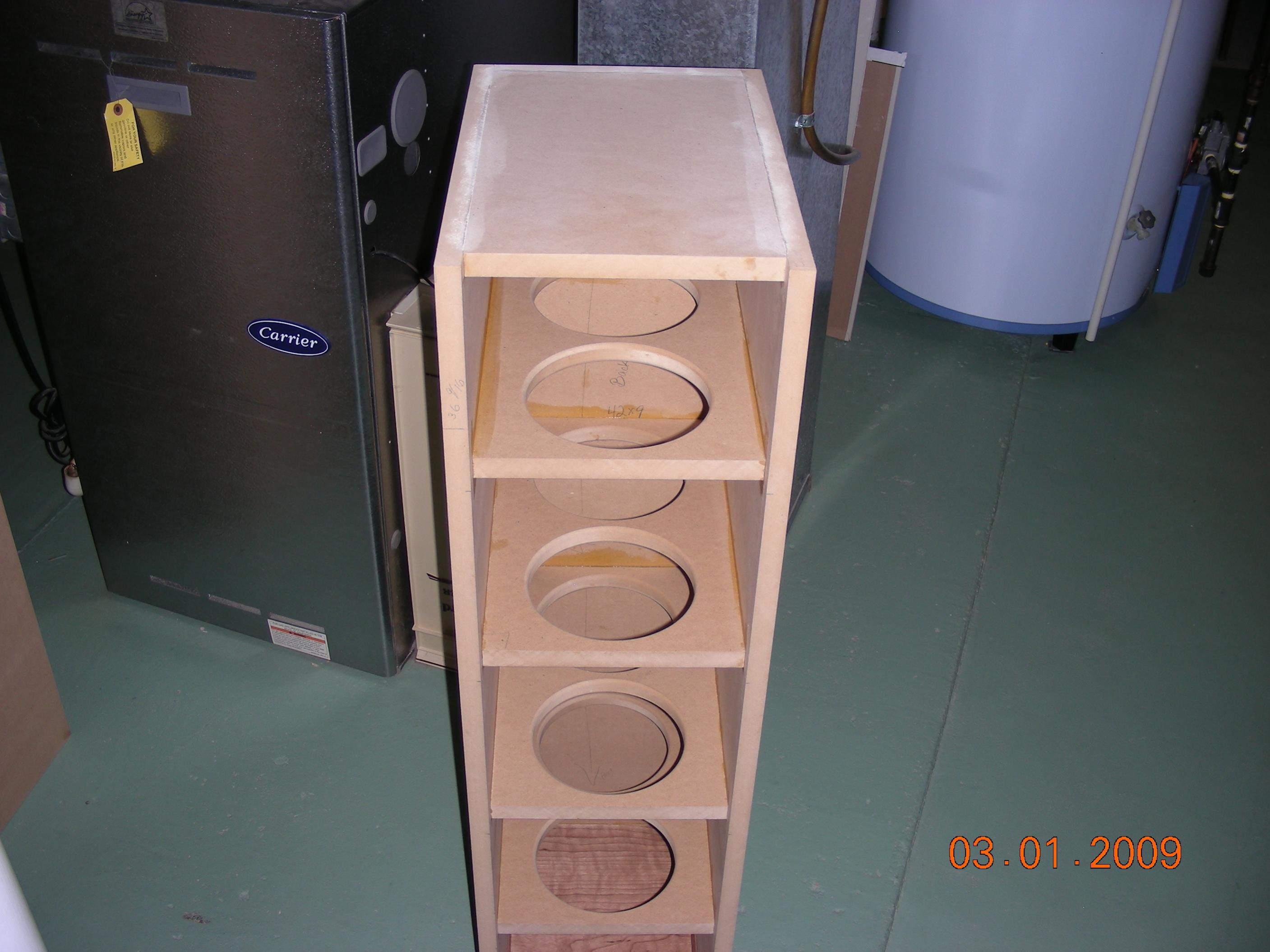

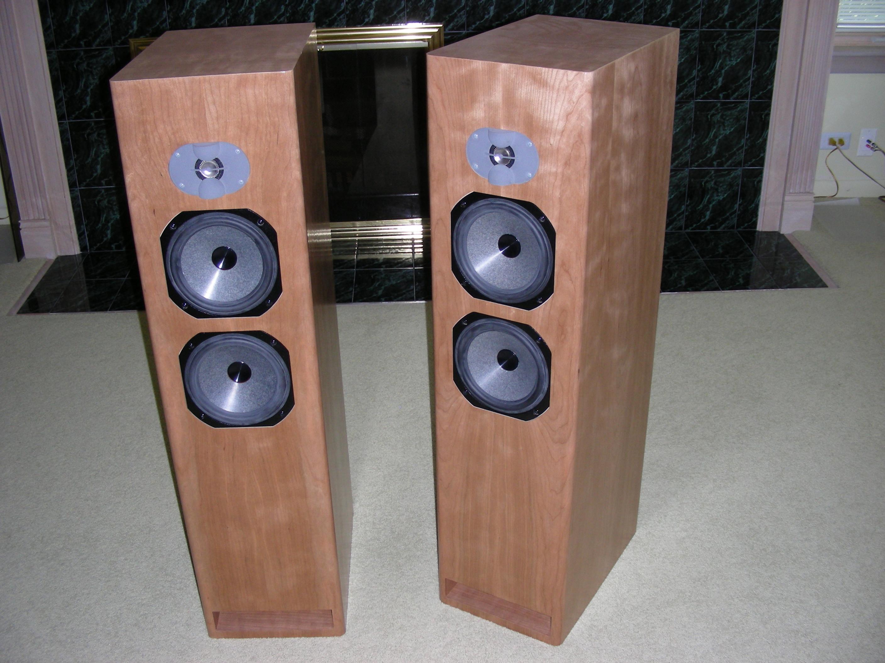

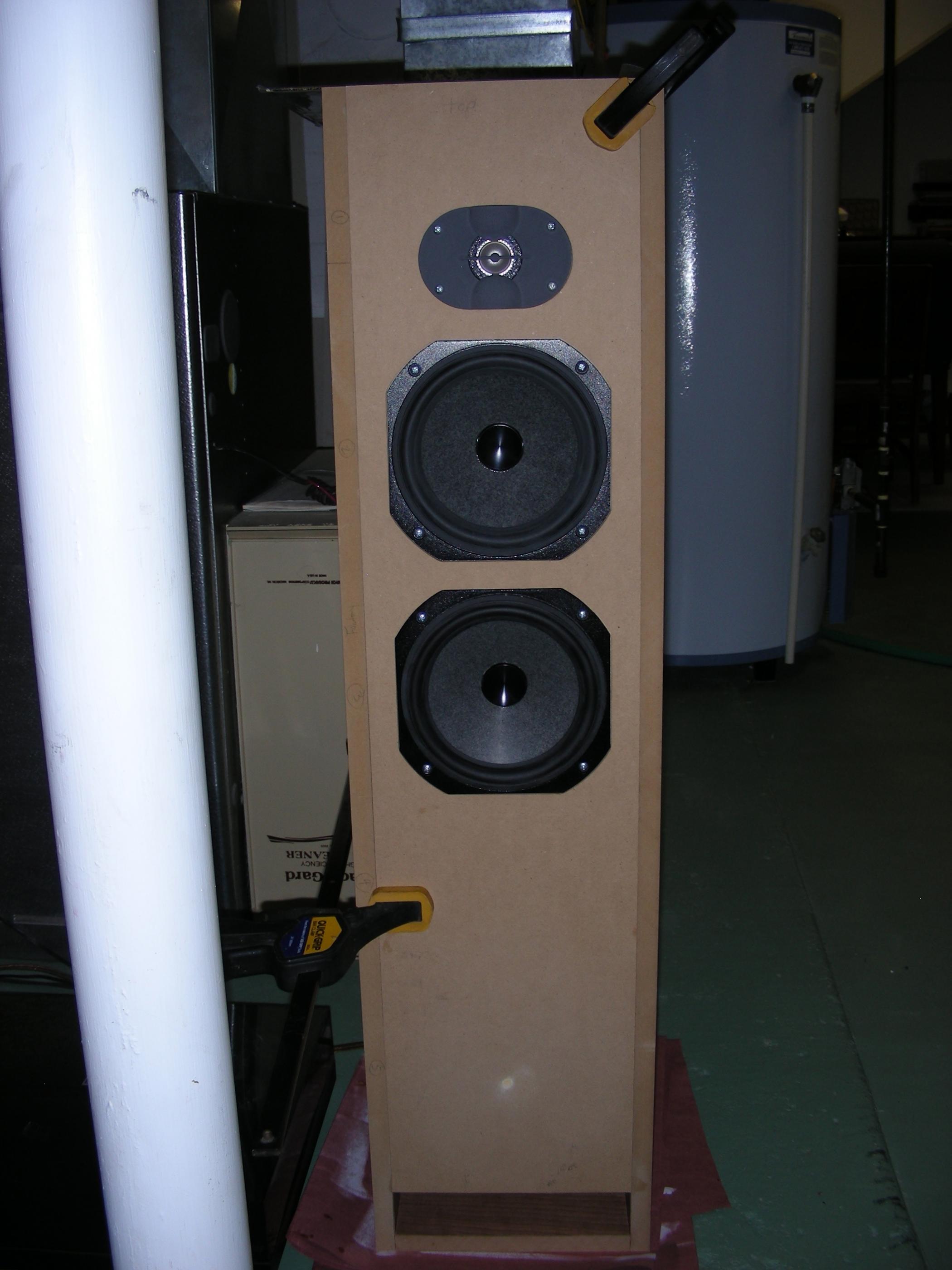

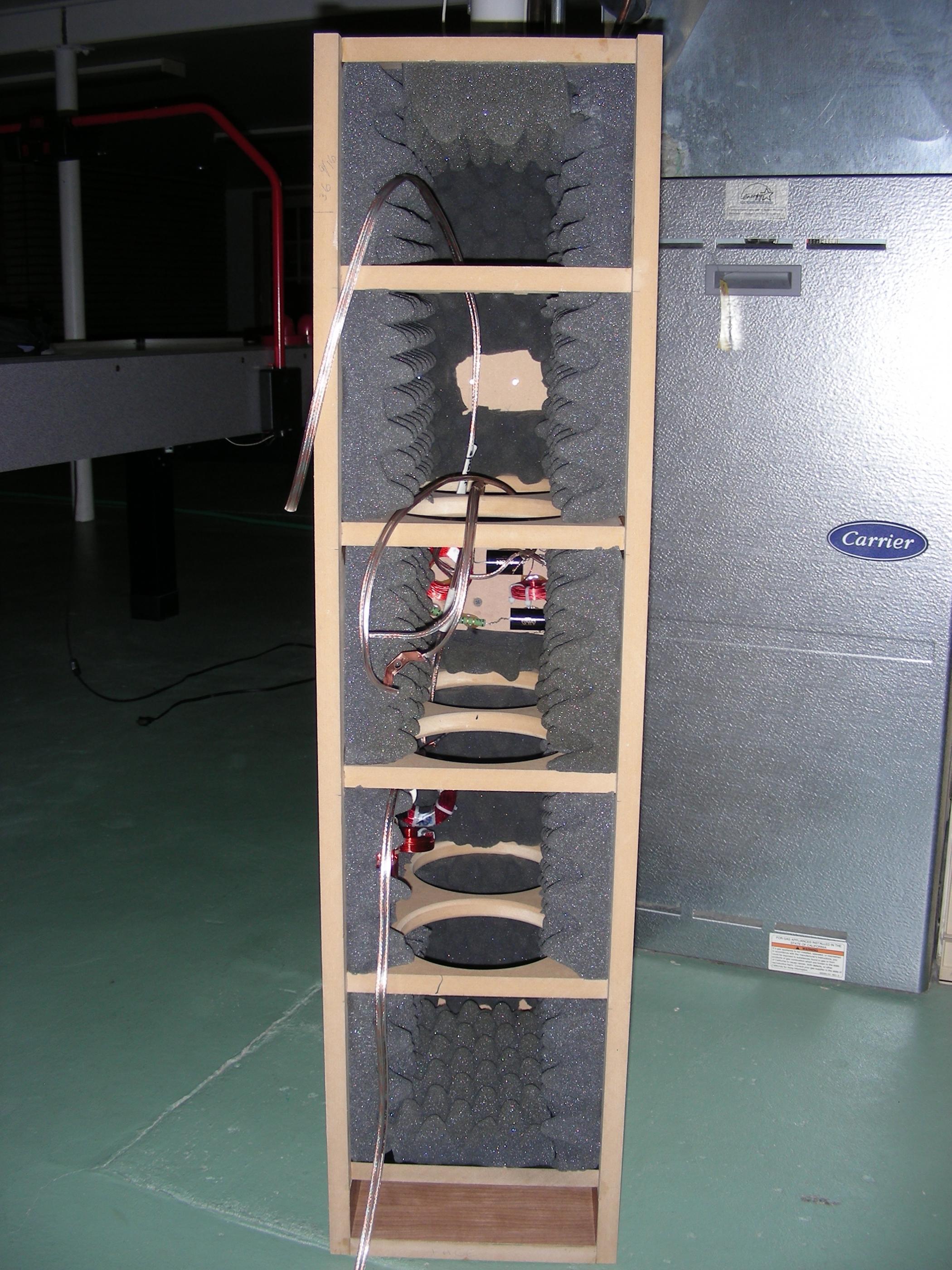

I know this is a very old thread. Yet, I have built the TMM Orca designed cabinets. They are composed of pair of Focal 7W4411 and Focal TLR Audiom tweeters. I upgraded the coupling caps to Jantzen Superior Z-caps (recommended by a speaker designed in The Netherlands).
My experience is that they have a flat response and exceptionally revealing sound reproduction. When I make slight changes in a component (cartridge, interconnects) or tracking adjustment to my system, it is evidently clear.
For the money, I could not imagine speakers that even come close to these Orca designed speakers.
I purchased the kit from Elliott at Zalytron. It was a pleasure conversing with him and dealing with him.
You can see my gallery for full list of construction photos.
