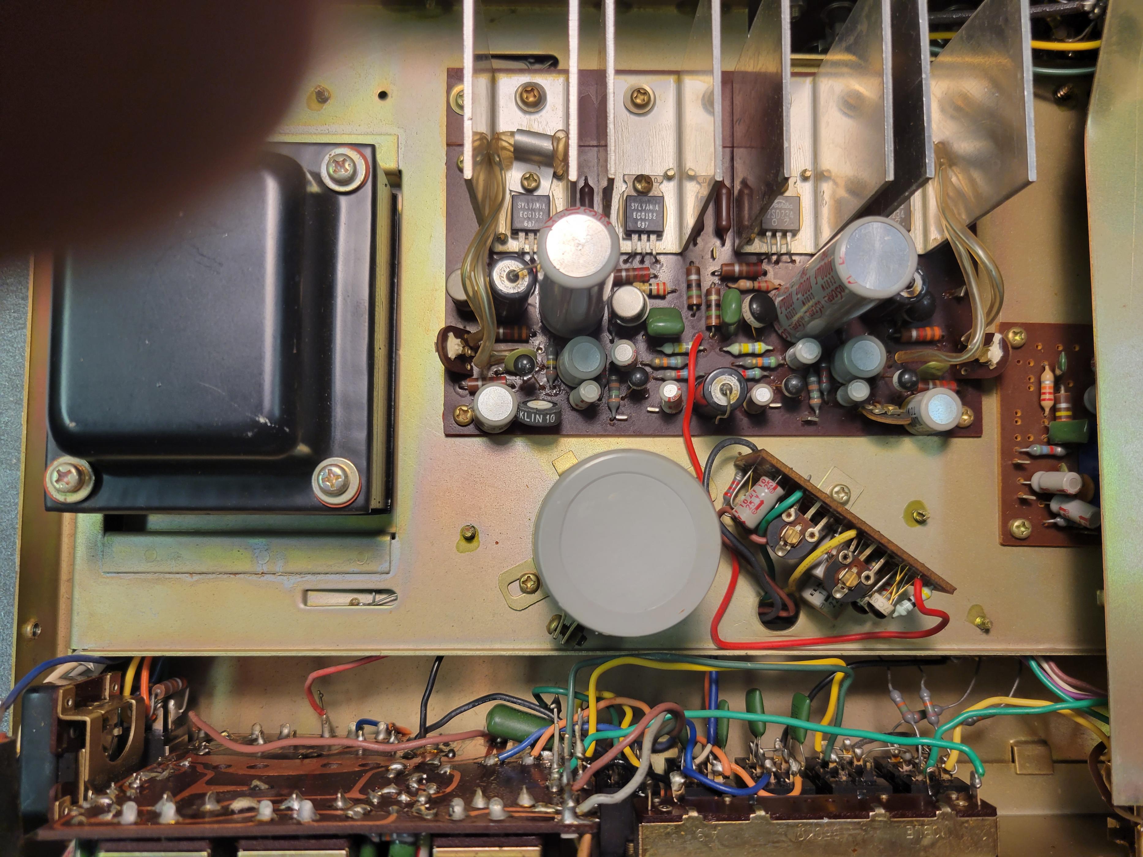

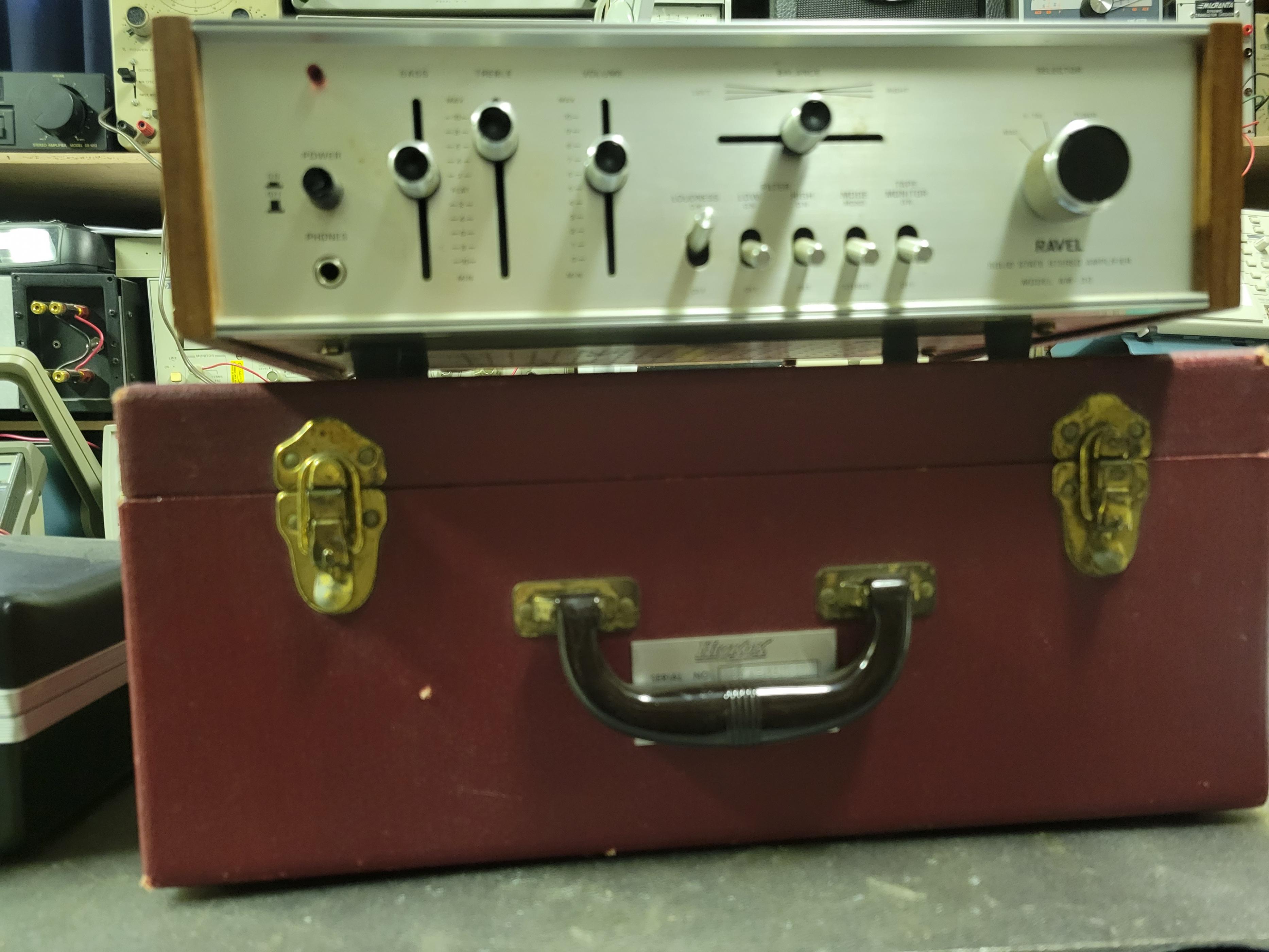

I found this vintage stereo amp at a garage sale. It was made in Japan.
It actually sounds not bad.
I can't find any info on Google.
Has anyone heard of this company?
Any info appreciated.

Yes Its an Alpha by highgate acoustics Its a typical linn amplifier in silicon
Cheap end of the market but non the less could sound good !
They did models from 10 to 20 watts in this range
The thing to watch for is thermal runaway and excessive bias
set the out put for a standing 20 mA and you will be ok

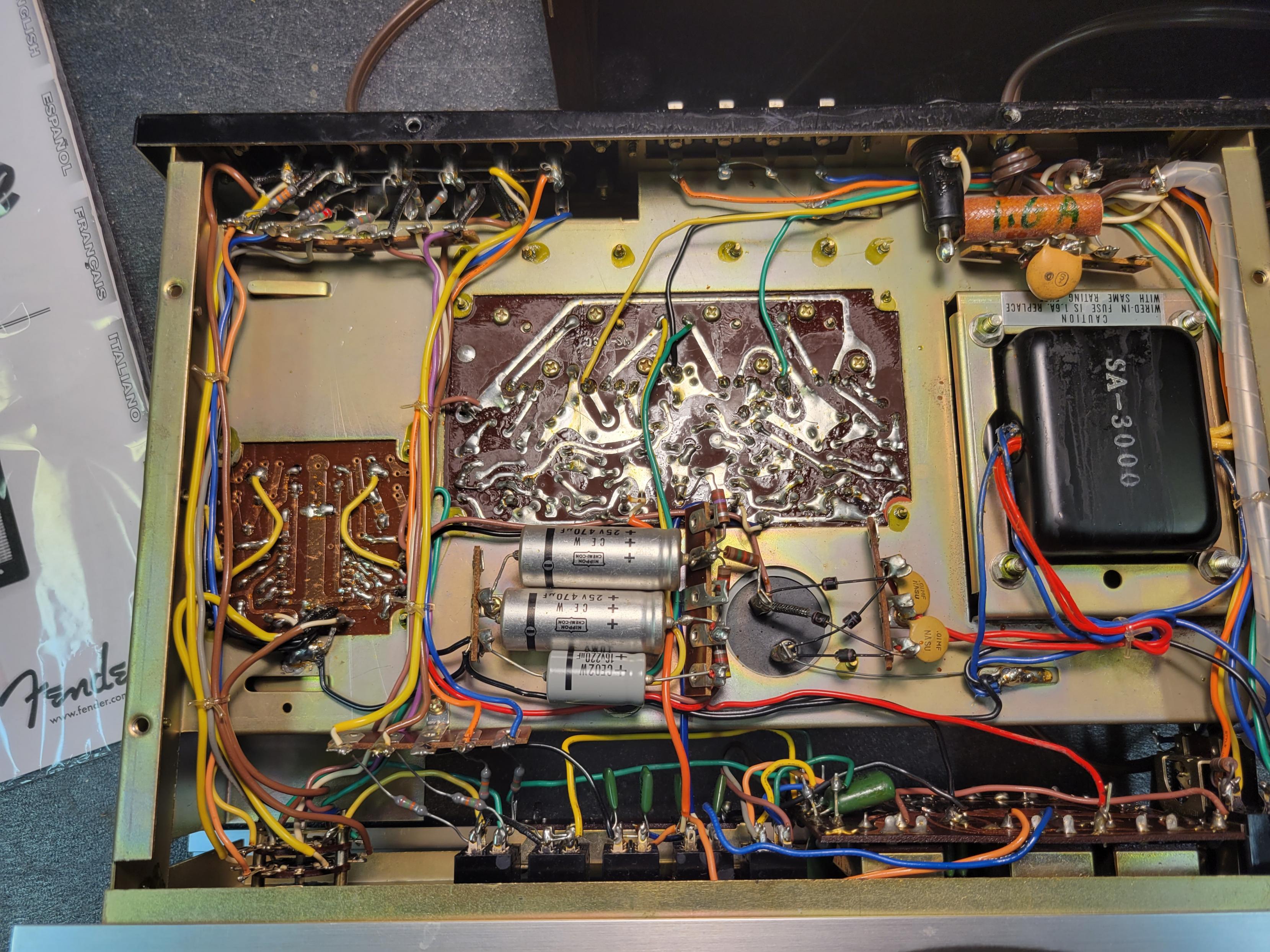

The amp actually surprised me when I first listened to it.
I think I might invest the time to replace the electrolytic caps.

- Ravel AM-30
