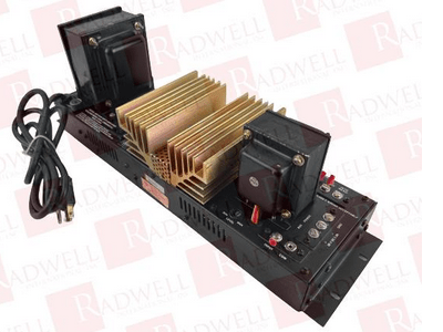

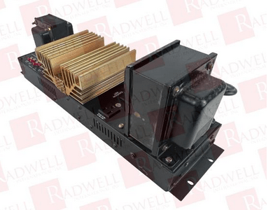

So, I was wandering through my friend's scrap warehouse and saw these two units that had just came in so I grabbed them figuring they may have some useful components.
It appears that they were used for audio/visual projects or institutional P.A. systems as they have some interesting features such as a 28 Volt DC aux output and 70V/25V speaker outputs. There are two 2N3773 transistors on the heat sinks. I powered them up and tested the DC outputs and they were a bit higher than advertised, but both units read the same 32 Volts. I hooked up a music source and plugged a speaker in and they worked.

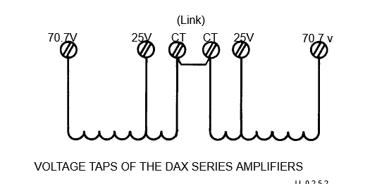

My level of audio knowledge is mediocre, so I stopped there until I can understand the following statement "the balanced outputs for 70.7 volts and 25 volts are for speakers designed for constant voltage lines. Each speaker must have a line matching transformer and the speakers muct be connectted in parallel."
The output impedences are listed as follows 70.7V = 83.3 ohms, 25 Volts = 10.4 ohms
Anywho, I am planning to work up to building a 30-50 Watt guitar combo amp sometime in the future (2x10 or 2x12) and wondered if this unit could be upgraded to potentially accomplish the task at some point. I assume they could drive two 8 ohm speakers as is, but the internal circuitry is perhaps not "high fidelity" At the very least the transfomers, chassis, and/or heat sinks could be repurposed I suppose. I was planning on using a high end chip amp for my main power for my first guitar amp, but these might come in handy for a later project.
Any thoughts?

So, as of yet I am unable to find the schematic for the amp. My first thought is to take one of them and strip out all of the internal circuitry/transistor out and just mount a 3886 circuit onto the heat sink and use it that way... I may save the other one to replace the circuitry with better transistors and a pre-amp circuit when I'm confident to take on such an endeavor.
Very good amplifier but a "one trick pony", it was designed for "institution" use (school church warehouse train station) .
And very different from conventional amps.
Not practical to disassemble or rebuild nor to reuse its parts so best is to use it as-is.
User manual says you can connect 10.4 ohms worth of speakers to one 25 V winding, meaning from common to one of the 25V taps, pick one.
Feeding it 60W RMS.
I suggest you build a 16 ohm cabinet: 2 x 8 Ohm speakers in series, which is easy.
Amp will work fine and put out some 40W RMS, not bad at all, and connect it from common to one 25V tap.
