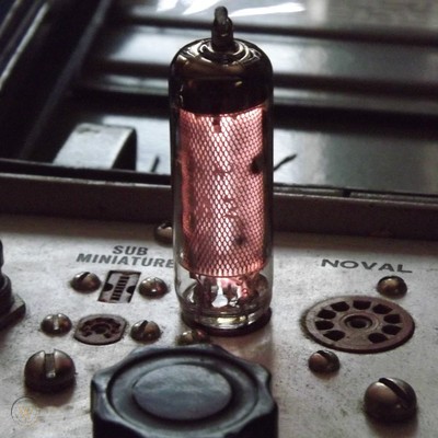

Recently I purchased via ebay 4 stabilizer tubes : 0A2WA.
After measuring them and finding nothing wrong with them (only all of them are at the almost lowest side of the stab. voltage tolerance),
I accidentally heard one of them rattling while pulling it out of the socket. Then to be sure, I did some shaking and then I noticed the rattle again. So, I measured it again but did not find any problems, same stab. characteristic.
Should I be worried? Shall I not using it in one of my designs?

It could be a small loose piece of glass inside the tube. That's not all that unusual, nor is it a reason to not use a tube.
Check both plate (anode ) pins = 1&5 still connected together ,
then check pins =2&4&7 are all connected together ,
pins=3&6 help holding the the internal structure in place.
It is not unknown for the spot welds to come away.

The out side tube is the cathode, the central shaft is the anode (pins 1 and 5).
No idea what is rattling though...
Perhaps somebody can shed more light on the 0A2 construction.
I looked around a bit on the web. Apparently there are 0A2's with a mesh anode. This picture shows a metal rod as the cathode, surrounded by the cylindrycal anode.
Edit: Maybe the rattling is caused by a piece broken off of the mica spacer(s). If so, I don't think it will do harm to the functioning of the tube.
Thanks PCL200 for supplying that picture.
Indeed there are tubes with a mesh or a solid cathode (according to Alan 4411).
I have one which has the mesh type (Philips). And yes, it provides a nice glow when "ON".
All the others I have are solid (Philips or RTC) .
As I wrote before, the rattling one still provides the stab curve.
