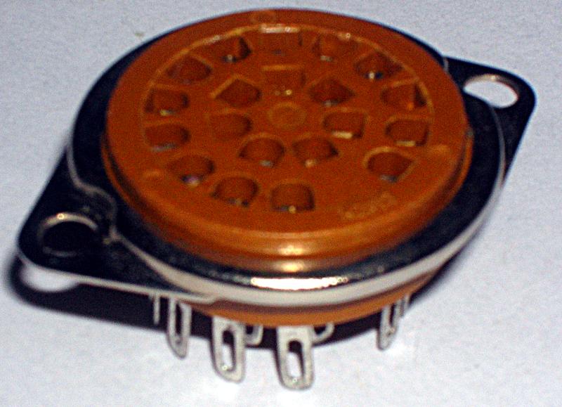

I picked up a fair few of the attached valve sockets from a guy getting rid of a lot of gear recently. Does anyone have any idea what they are for? I've never seen anything quite like it.

Those are for Nixie tubes, and maybe some counter valves.
Nixie tubes are number tubes. It has 10 cathodes and one anode. Each cathode is formed as a number from 0-9. Some have other kinds of symbols. The tubes are filled with Neon gas so that the cathode glow orange when grounded.
Don't remeber any type number that uses that socket. But ZM1000 is an eksample of a Nixie tube.

It looks like the sockets from those old decade counting tubes. I had some from old photocopiers. The tubes were made by Burroughs as I recall.

Its probably not a nixie socket - not one that I know, anyway - I don't think there are any 20-pin ones there. The style is like the B26A on the page below.
See http://www.tube-tester.com/sites/nixie/trade06-nixie-tubes.htm
The style looks like a Cinch, but the focus is not too good...
